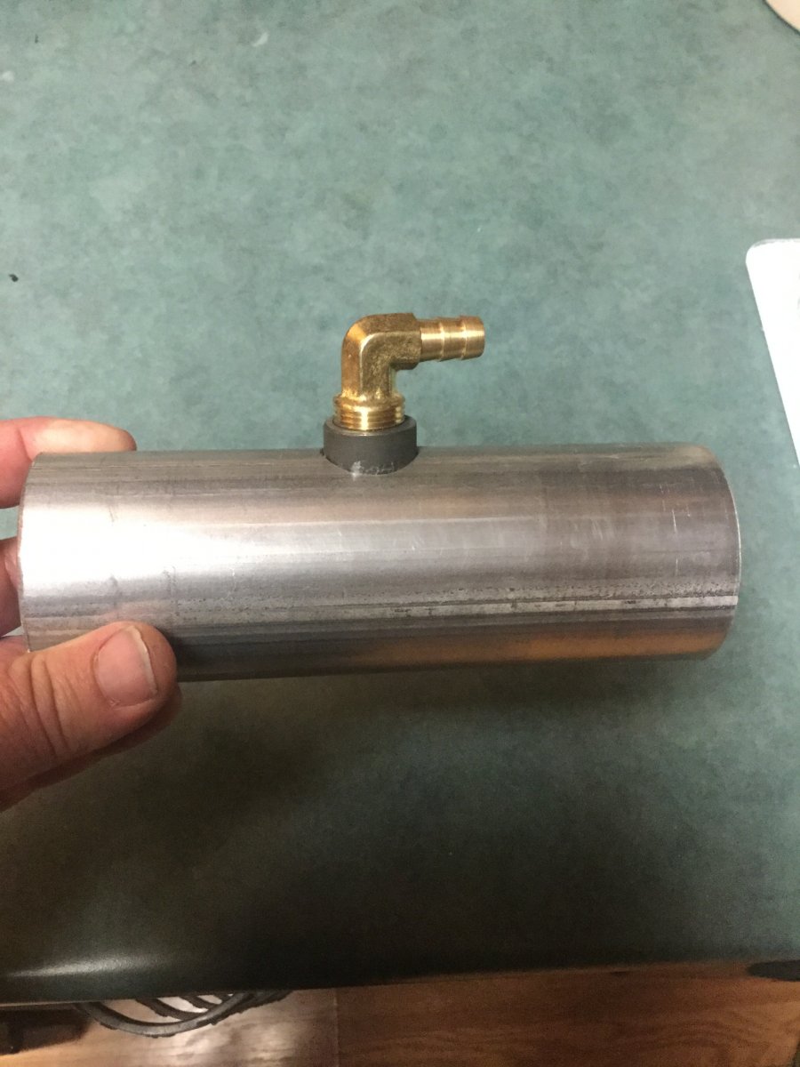

    OK so here’s what I’ve come up with to solve my mustang tank venting issues. I used a piece of 2 1/4” exhaust pipe a furnco from the local hardware store to connect the exhaust pipe to the tank and a flex rubber fill line from NAPA.
    I ordered some parts from McMaster Carr here are the part numbers
    4513K72 3/8 npt steel pipe fitting
    53525K18 3/8 npt br*** hose barb
    Drill a 7/8 hole thru the exhaust tube attach the inside hose barb to the pipe fitting and slide thru the exhaust tube. Weld the fitting to the tube.( I sill have to weld mine) the attach the outside hose barb run the 3/8 vent tube to your desired location above the filler neck. I also will be attaching a piece of 3/8 hose to the inside hose barb to get the vent down to the top of the tank. One other note: the steel pipe fittings are not taped all the way thru you will have to use a 3/8 npt tap to finish the threads to make this application work. By doing it this way you are able to avoid all drilling, cutting and welding on your existing gas tank. It’s also a pretty inexpensive solution to the tank venting issue. Hobo Jim

    I would bet the Furnco coupling will not hold up in todays gas. I would keep an eye on it if i was you.
    56 Dodge Pickup likes this.

    Thank you for the advice! I will use a hunk of fuel filler hose instead.

    I just wanted to update my portion of this thread. I went to the gas station this afternoon for my first test. The exhaust pipe vent worked Great! I was able to fill the tank with no back splash. Now onto Crusing season Hobo Jim
