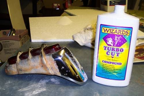

    For me, steel wool is a last resort, something has to be totally brown with rust before I'll rub it with steel wool. And even then, I've gotten some impressive results.
    But for not-horrible chrome, where you have to clean some rust stains off but want to be extra careful to preserve what's there, I use buffing compound, same stuff you'd use to buff out a new paint job. It's way less abrasive. I like Wizards Turbo-Cut, it's cheap and it smells nice. Stuff like Flitz and Simichome are really good too, but a travel-toothpaste sized tube is $10 and you can get a quart of Wizards for $18, I polish a lot of chrome.
