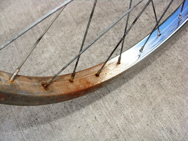

How are you guys bringing old chrome back to life?

  14. Bull, you know I am a huge fan and cheerleader of ALL of the Wizards products! But, the QuickGlo RULES for really pitted chrome. As was said it came from the bike industry and I found it 20 years ago while restoring Stingrays.
