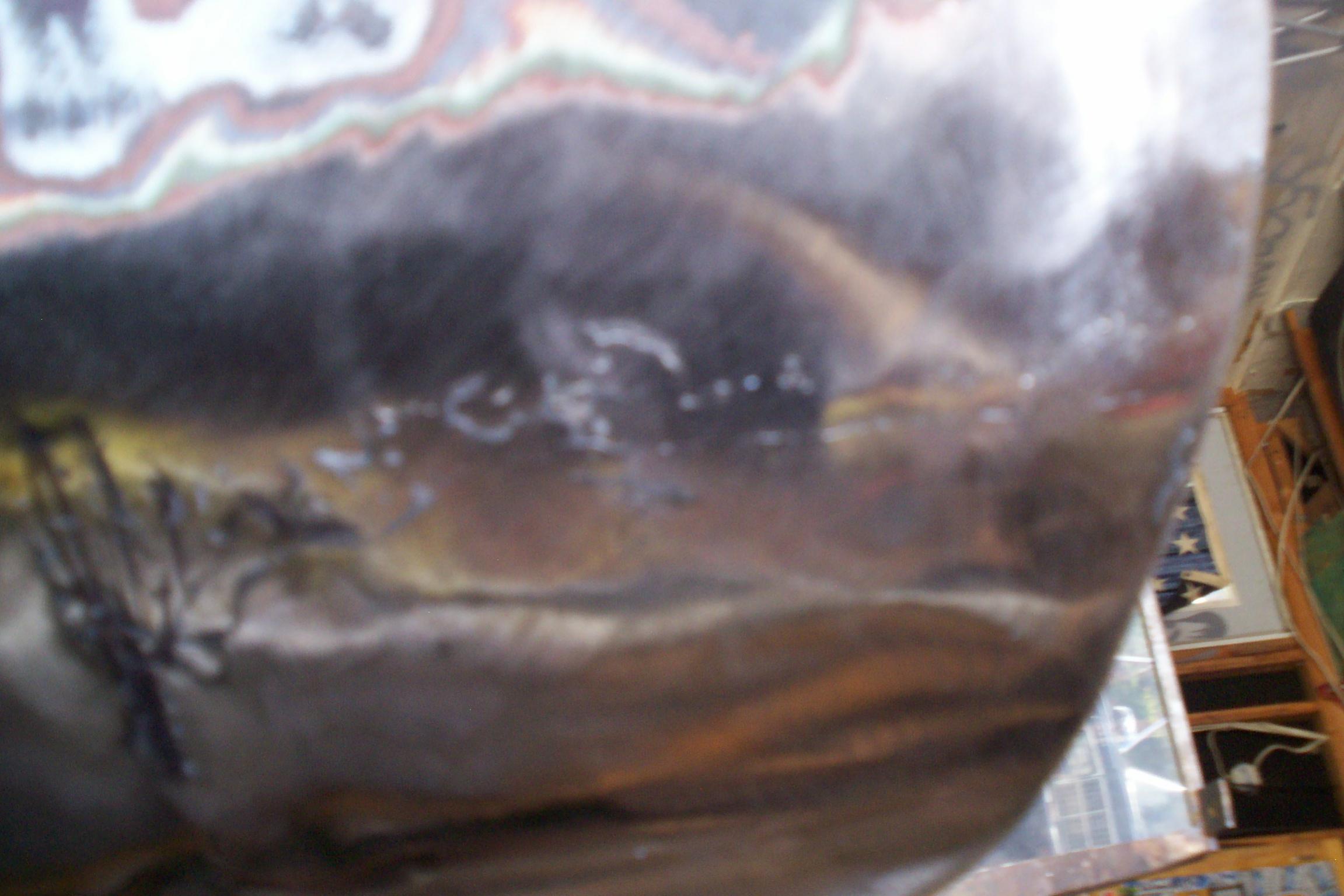

  3. heres a crappy sideways photo of what im talking about. the piece has already been fully welded in and grinded down, but theres still traces of the work:
  4. happy hoppy

    The picture is pretty blurry so it's pretty difficult to see what going on, but it looks like you have alot of warpage.

    looks to me like its a combo of warpage and not having the panels lined up right before welding. But, like others said, hard to tell in the pic.
  12. theres no warpage going on, those are just marks from the gringing wheel. let me try and get a better pic

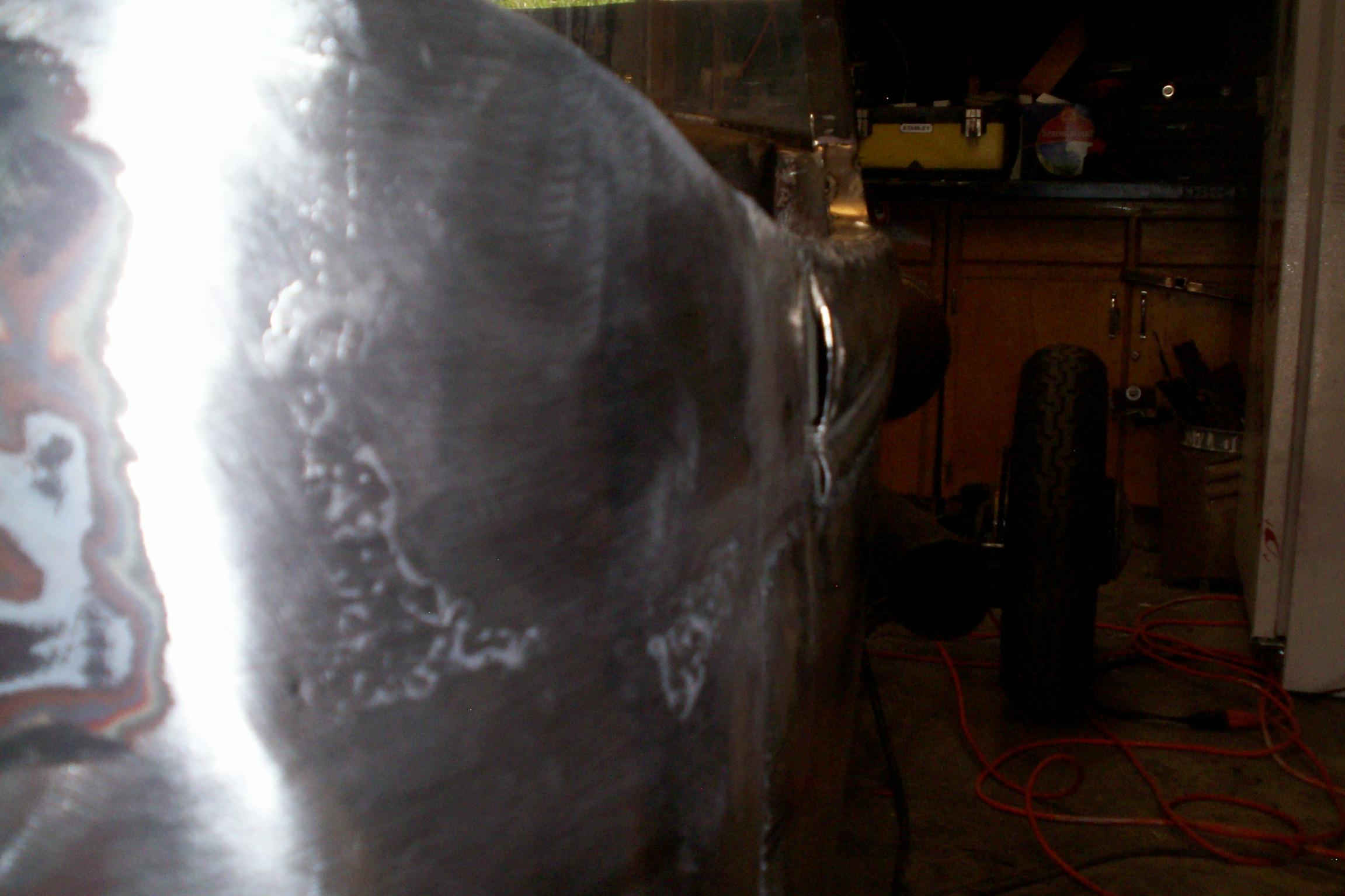

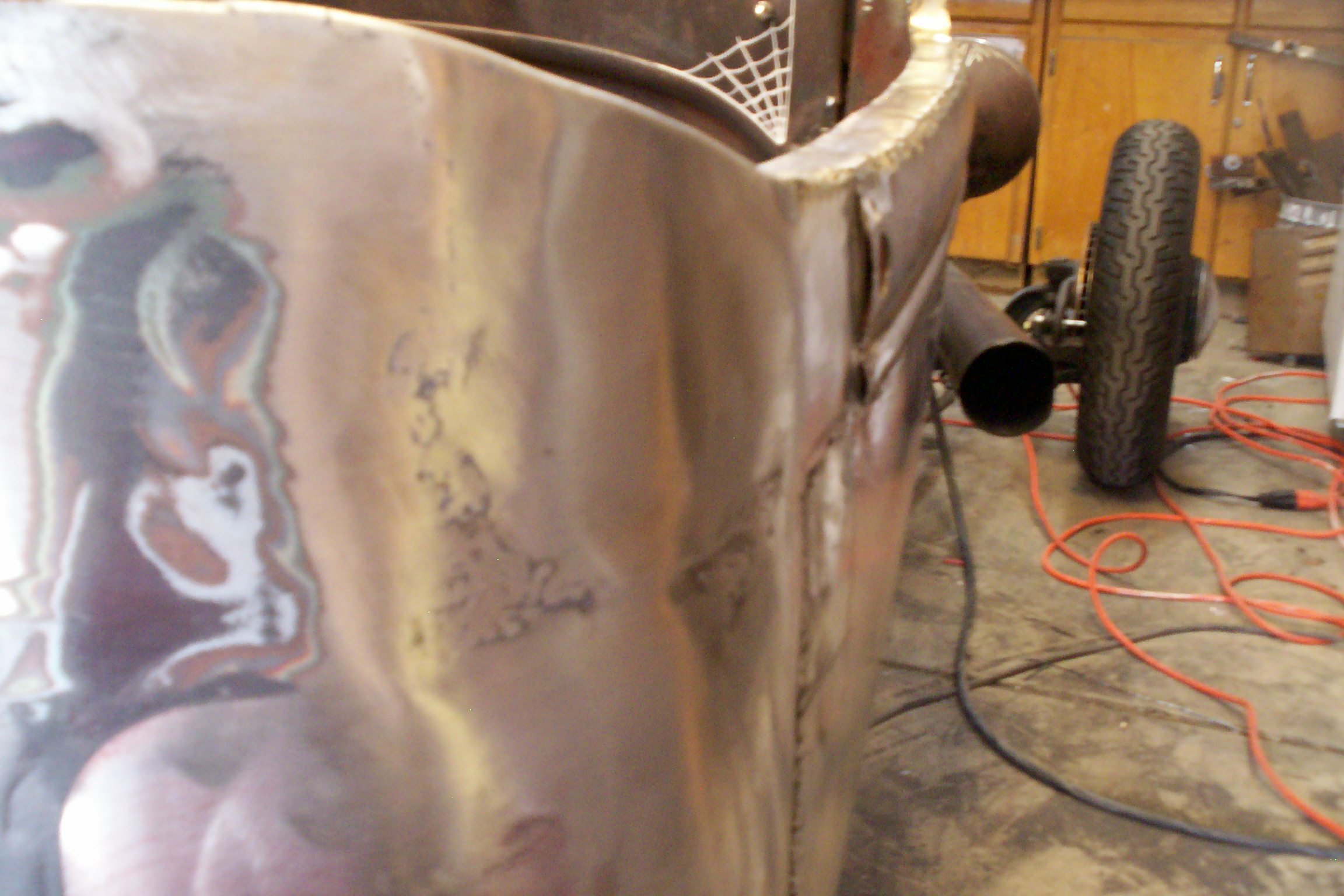

  13. heres two more pics, one with a flash and one without. i also tried to sand out those grinder marks to make it more clear.
    i guess what my question is...will plastic filler adhere to this, or will i be creating myself more problems later on

    The bondo should stick fine. But it looks a lot like the metal is being pulled in by the weld and not under cut at all. You probably need to dolly the section back out, gind, planish, planish some more. Maybe even give it a little heat to get things moving again, but I doubt that it is the weld cutting into the sheet metal.
    Make smaller tacks, let it cool down longer between welds. Planish and dolly it while welding it.
    Of course it is easier to type it out than it is to do it...

    with that much weld in one spot your never gonna get the low spots out its gonna crack and crack and crack . whats up with the big spot of weld was it buring through? if so the metal around it is probably thin as hell too . a whole bunch of variables here . if your just gonnna mud it over why do ya care about those spots? the second pic looks like it is warped to hell

    Yea, looks like you are getting it a little too hot. Do one tack at a time, and don't go back until you can touch it with your bare hand to get the least amount of warping. Also, making sure you have tight, consistent gaps before you start welding will help.

    Looking at the pictures I would say there is nothing wrong. You grinded down your welds good. Just feel the panel so see if it is ready for bondo and smooth some on. If it is not ready then dolly it out first.<?xml:namespace prefix = o ns = "urn:schemas-microsoft-com:eek:ffice:eek:ffice" /><o:p></o:p>
