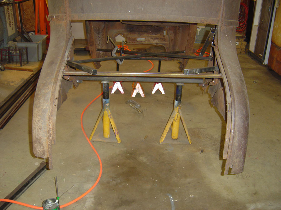

  14. chaddilac
    Joined: Mar 21, 2006
    Posts: 14,057
    chaddilac
    Ha, I'm really embarassed to show you guys my coupe body... I'd done so much work to it that the only thing left of the real body I bought is the quarter windows, rear quarters, A pillars and header!
    The subframe was rusted out from the B pillars to the rear, and I thought of replacing the rear section, but I ended up just rebuilding the whole thing so I was strong and I wouldn't have to worry about whether the front would fall off or not!
    This subframe slides right over my frame, then I welded 6 mounts to it to mount the body to the frame. Hope these help??
