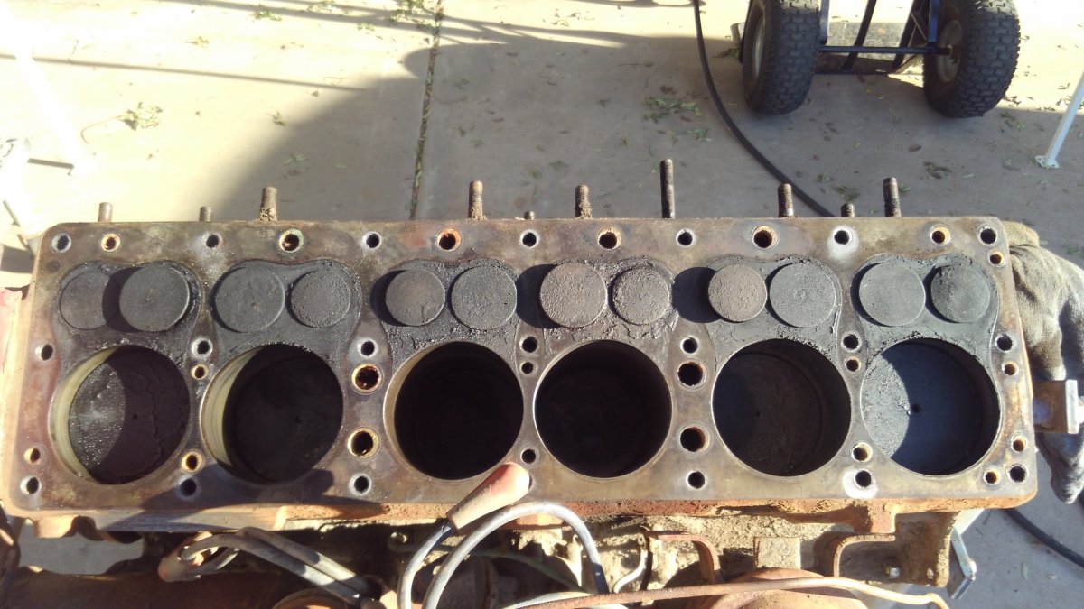

    Got this back from machinist. 6 sleeves, standard bore, cam and crank reground, etc. He didn't see this crack. He suggested to see if it even leaks, use Steel Seal or s***ch bolt it. Wanted to see what the experts think.

    If you lock s***ch it, at the very least you should check/rehone the bore, and check/regrind valve seat. That process puts pressure on the block which can/will move things around especially in that location.
    I wouldn't use a sealer at this point while you have options available.

  3. You need to pull sleeve & valve seat. Be sure you can get to both ends of crack. S***chlock. Easy to do. Clean up pins from s***chlock. Install sleeve & valve seat. Your good to go.

    What you have is a very expensive boat anchor, cracks that go into intake/exhaust ports are very difficult if not impossible to fix.
    Apparently the machinist didn't "magnaflux" the block before doing all that expensive machine work.

  5. Is it a coolant p***age under the crack ?
    it won’t spread anymore swing it’s touching the valve seat and liner.
    What did you pay for ?
    Seems strange they wouldn’t mag it first or even see the crack, pretty easy to spot it .
    not sure how happy I’d be putting jb weld on it after you spent as much as you did doing it the right way.
    what was your machinist thoughts on a spot stich ?
    Might have to pull the liner and the seat but it would be the correct way to fix it.

    This photo help? Doesn't look like it was leaking. 2nd cyl from left. Trying to be optimistic here, these thing ain't exactly falling from trees around here.

    Should be coolant under there.
    He said it could be spot s***ched without removing anything. I couldn't drill a straight hole if my life depended on it.
    Never had any luck with JB Weld on anything.
    He swears by some stuff that will seal it called Steel Seal.

  8. I have repaired many flathead Ford’s with cracks from ports to cylinder exactly as I described above with 100% success over the last 50 years. Don’t be scared but do it correctly. It’s actually pretty easy.

  9. I would get him to spot stich it, at this point it would be 1-2 hours labour for him to do it.
    by the time you buy the kit and piss around you paid him and it’s done back at your garage.
    i JB welded a lot of jag inline 6 heads and blocks as the coolant would eat away at the material around the coolant p***ages, slather it in wait a day then with a big fine ******* file file it down smooth and level with the rest of the surface.
    But that was with an actual hole or gully, if I where to jb weld your crack I would V it a bit so you could pack it in there.
    Anyways, I vote for getting your machinist to spot stich or lock stich it and be done with a quality repair.

    I think if it was to be s***ched, I’d invest in an inexpensive bore gauge, or a snap gauge and check roundness afterwards. I know the process is to pull the material together, but I’d still check it

    I will ask the machinist to take it back and fix it. thanks.

    Wonder if the machinist can determine the ends of the crack and drill for you, seeing how they missed it the first time. Then v grind it and fill with brazing rod. ( isn't that how they used to fix minor cast iron cracks in the days before JBW?) ...or am I totally wrong guys....

    I can't see the crack in your last pic of the original old photo. Are you sure the crack was there before and not caused by the machine shop when it was sleeved? Is that a new seat? Cause it looks cracked. Lippy

    After magnafluxing the block, boring the cylinder and grinding the seat I find it very hard to believe any machinist could have missed that crack. I would pressure test it and if it doesn't leak run it. Just because it's not opened up and it would be a ***** to "s***ch" through a valve seat and into a cylinder. Pins work great on flat areas but around corners it gets harder (though not impossible). If you do it will need a new valve seat and a cylinder sleeve and machining across the pins might not work the best. I wouldn't trust a machinist that didn't have enough sense to crack check the block in the first place, very unprofessional. I wouldn't trust a pin in a valve seat. Maybe it would be ok with the right pins. I think Goodson sells pins that are made of cast iron but I don't think they all were.

    How about pressure testing it to see if it leaks?
    I've ignored a crack like that on my daily driver car and been lucky.

    no Im not sure. the seat is not cracked, probably grease. i would think if the crack was there and leaking, the whole area wouldve been steam cleaned from running? not all built up with carbon?

    No I meant in the new photo after machine work the seat looks like it has a crack across it. Sorry for the confusion. Lippy

    B Ramsy; Did a quick search on the "interweb", found there are several cast-iron repair systems available, some even have instructional videos. If the block can be saved you will have to use one of those systems. .
    A couple of you suggested a "J-B Weld" repair. That's not gonna work as the area between the valves and the cylinder bore (that's where the crack is) just happens to be in the combustion chamber. (The engine is a flathead, in case you guys forgot).
    A couple of you recommended "pulling" or "pushing" the cylinder sleeve out plus pulling the valve seat in order to repair the block. In case you didn't know cylinder sleeves and valve seats are always installed with an "interference fit" where the sleeves are left in a freezer overnight, then quickly pressed into the block before they warm up and expand. This means the only way to get that sleeve out is to bore it out. Same thing with valve seats.
    One of you mentioned that the "lock-n-s***ch" method will "pull the material together". From what I've seen all of those cast-iron repair systems operate off of a "threaded hole and tapered pin"system. This wedge effect is why I'm not sure you can fix that crack if it goes into the intake port.
    B Ramsy, several of us suggested you need a better machinist, which is the proper advice. Best of luck with saving that engine block.

    You sure on the boring out the only way to get a sleeve or seat out? Iirc, a hot weld from mig will cause the seat to shrink enough to come out, & the same for the sleeve. Works for bearing races n other very tight things.
    BR; Another way to fix the block would be to weld it. There are a few threads on that subject, some hambers said they've done/do it. & of course, the seat n sleeve still need R&R + the machining. Tough situation, hope it works out. At a min, "machinist" owes you a re-do on a better block. Be tough to get that, too, I think.
