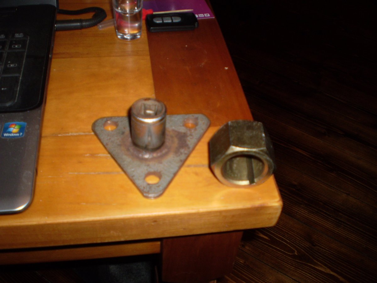

  1. LOL I know where my plate is, I saw it just the other day. I slotted mine because I thought it would make it universal. :)
    The snout tool I have had since the '70s, thought I lost it and found it in my Ol' Man's tool box. I think I gave 7 bucks for it from the Snap On truck. Mine is black.

    much easier.ARP bolt head looks like this.put a power bar on it and there may be no need to pull the plugs[​IMG]
