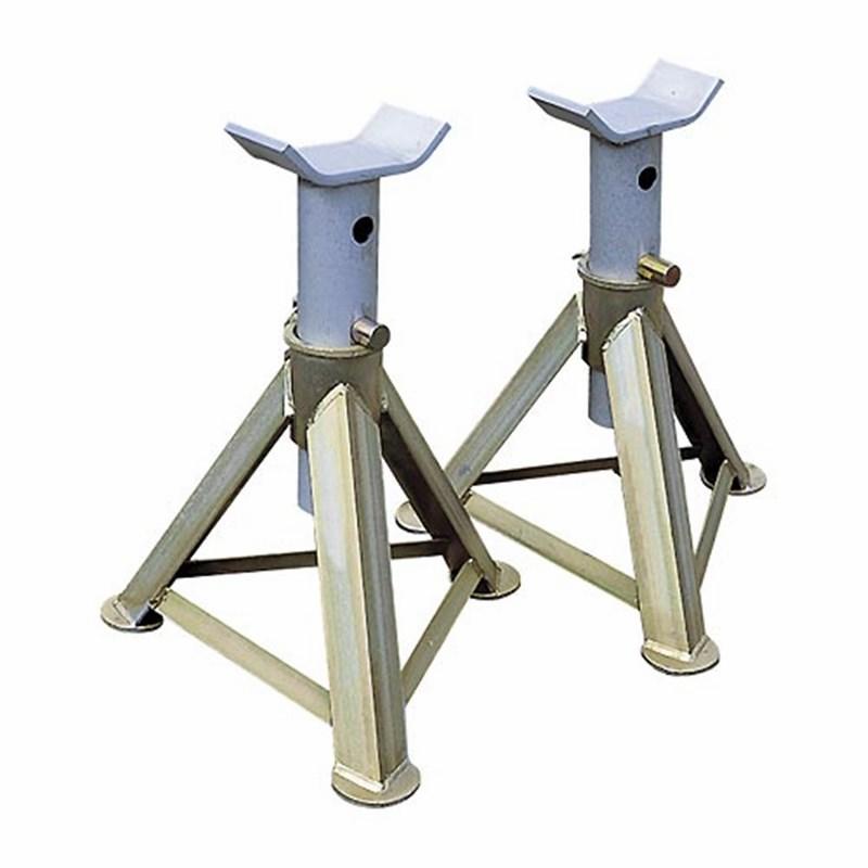

  25. Moriarity
    Joined: Apr 11, 2001
    Posts: 39,234
    Moriarity
    SUPER MODERATOR
    I also have these made from banjo rear axle housings.
    1221E898-414A-4B13-ABDD-5092F0578F86.jpeg E57BE278-D68B-438D-9AB2-5C11A0F6497B.jpeg
    BradinNC, Gasser 57, 1pickup and 12 others like this.
  26. Joe Blow
    Joined: Oct 29, 2016
    Posts: 1,904
    Joe Blow
  27. 41 GMC K-18
    Joined: Jun 27, 2019
    Posts: 5,500
    41 GMC K-18
    Hey @'34 Ratrod
    First of all, yes indeed, you are very lucky that, you didn't get seriously injured!
    That ****s that those type of jack stands failed in the way they did.
    I never trusted those those type with the ratchet teeth.
    I used to keep an off topic truck in storage back in Oshkosh Wisconsin, so that I could use it once a year for when I was at the annual airshow as a vendor.
    I had a friend that would come and start up the truck several times in the winter and put it in gear to let it run a little while.
    I bought 4 heavy duty jack stands that were beefy and that had the pin in post style, that you see here in these photo's. I thought that by having 4 of them, for the truck to be off of the floor, so that the tires didn't get flat spots in them, was the way to go.
    But I really didn't like the way they supported the truck by just the frame. The metal to metal contact area didn't seem to be stable enough, especially if the truck was going to be running while elevated off of the floor.
    I bought that set of jack stands back in 2009, from Menards there in Oshkosh, as you can see, they used a 1" pin, and the post was forged NOT cast.
    So I went to a local rigging company that I knew, would have a bunch of 12" X 12" wooden blocks, I bought 4 of them, money well spent by the way.
    As you can see by the pictures, the 12" X 12" wooden blocks was a much better way to go for the front end of the truck, I used the jack stands on the rear end housing, which they fit a lot better because of the roundness that fit the head of the jack stand a lot better.
    Same as with the trailer to keep the tires off of the floor, wooden blocking for the tongue of the trailer, jack stands for the axle.
    It should be more than evident, from all of the input on this thread, always have sufficient wooden blocking, to be the best safety back up element, when when working under cars or trucks.
    Your results may vary !
