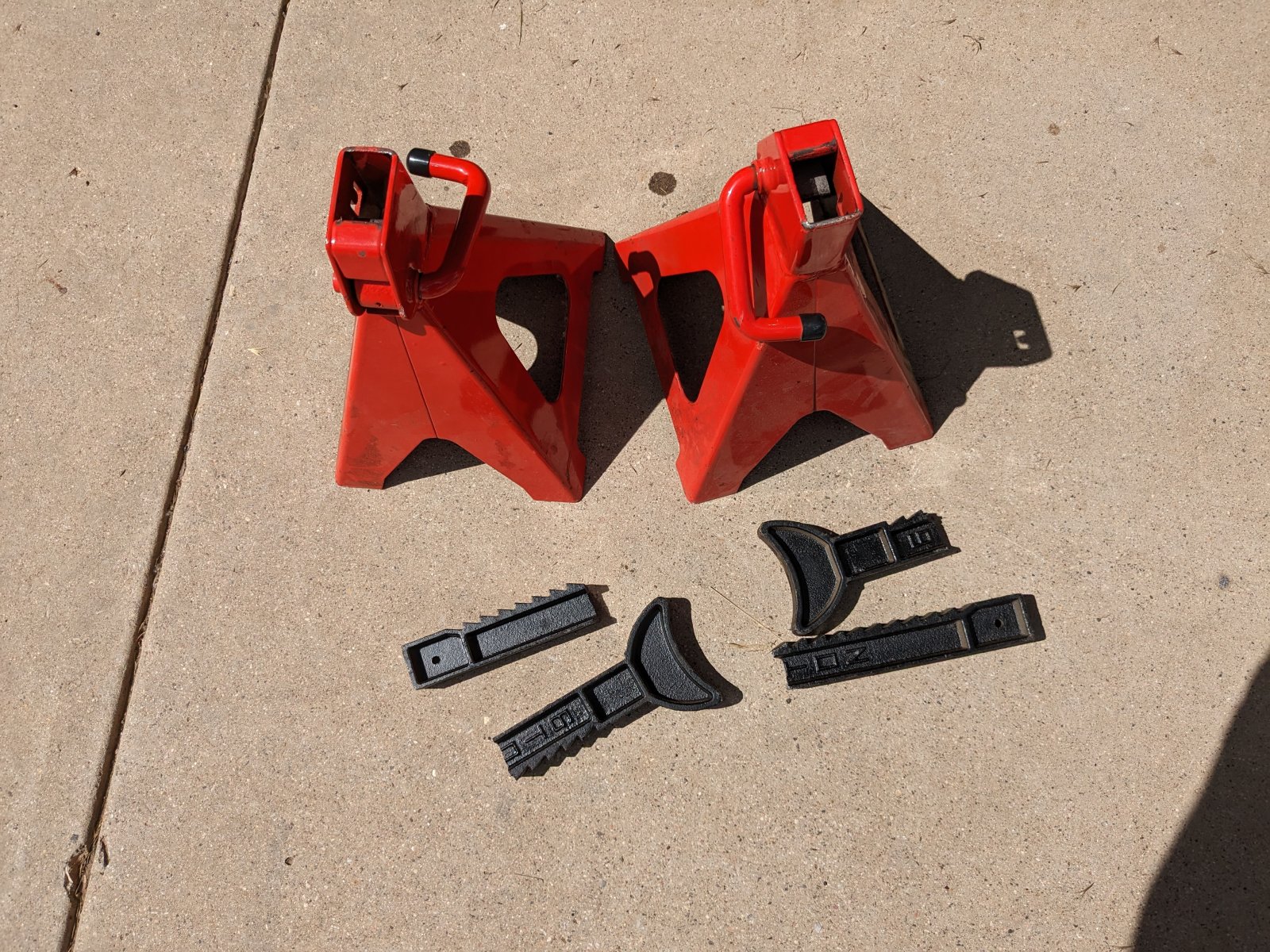

    I had to buy a new set of stands to work on my dad's Coupe DeVille last year, and I got a set from Northern Tool that I really like, the bases are very wide and they have both a ratchet and a pin, so if one fails, the other should hold it up. They're very tall, I was able to get around under the car with the centers only extended out like one or two clicks. I don't trust any jack stand extended out to the max, or even half way, those center posts get awfully wobbly once they're out a bit.
    I use wood blocks whenever I can, I call it the Po-Boy lift, which is great for building exhaust and doing floor pans and stuff, not only can it not fall off, but it keeps the suspension loaded so things don't move around once the car comes down. But it only works if all 4 wheels are on the car and don't have to come off.
