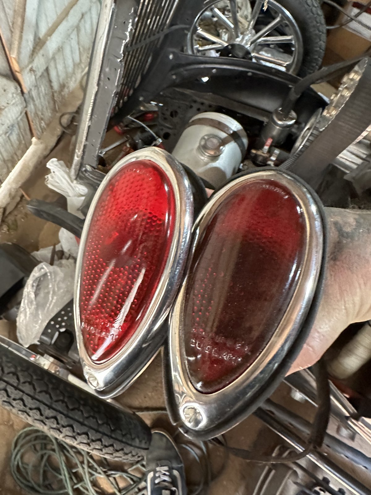

  2. Examples...
    Tim and mad mikey like this.

    JMO, but the second example has wiring that for sure smacks of aftermarket, but even the first one could be and likely is reproduction also. Even so, the cloth covered wiring and cloth sleeve around it says to me that it’s a quality repro.
    mad mikey likes this.

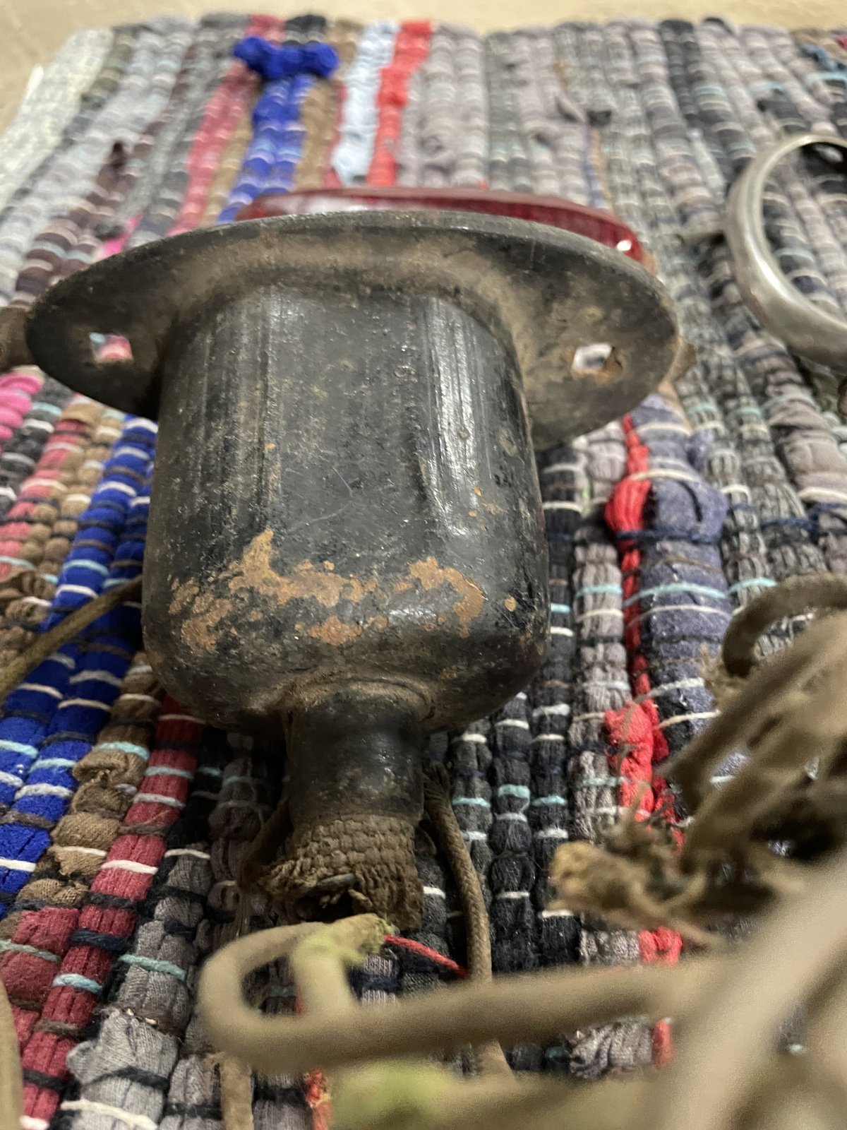

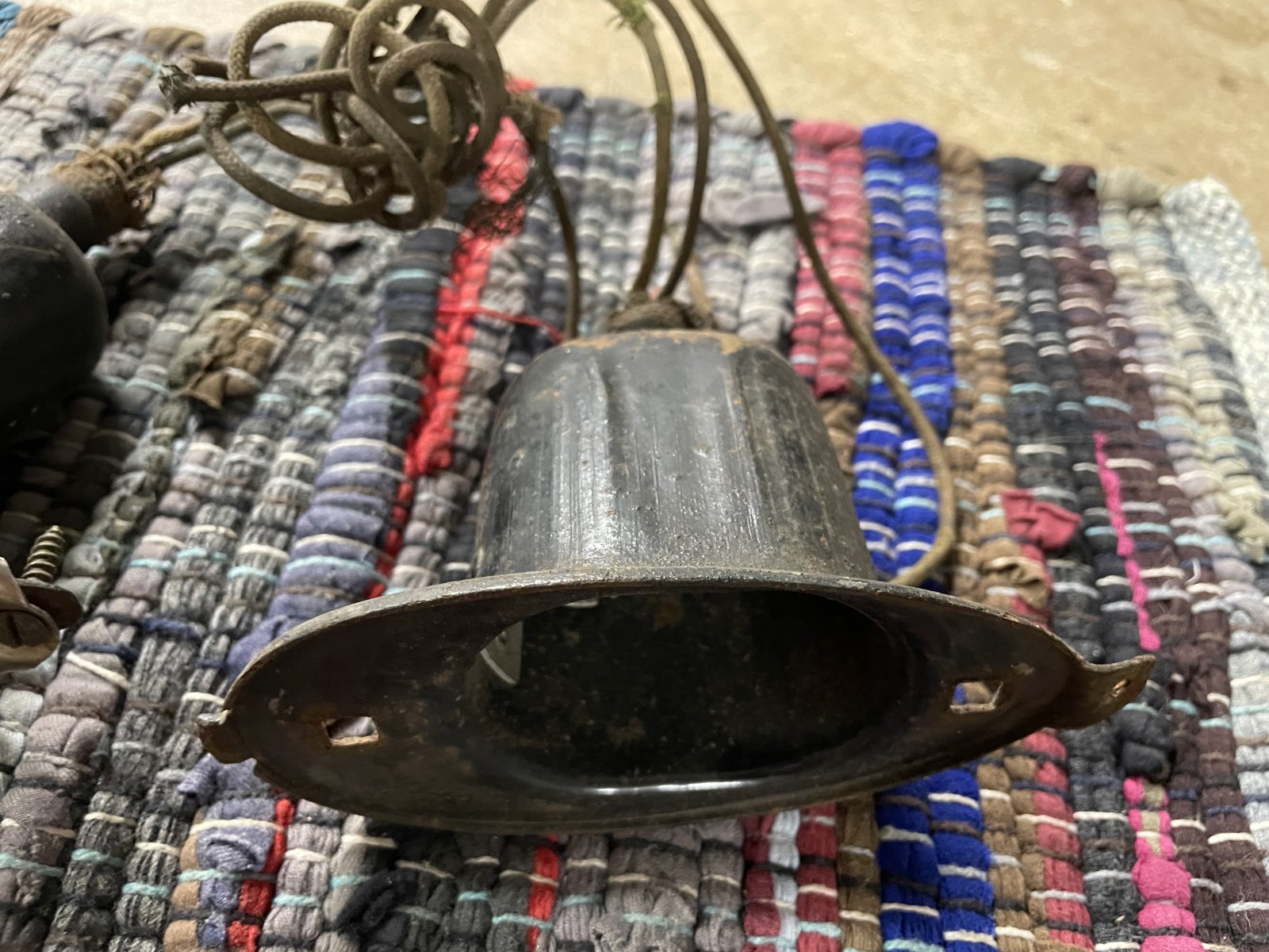

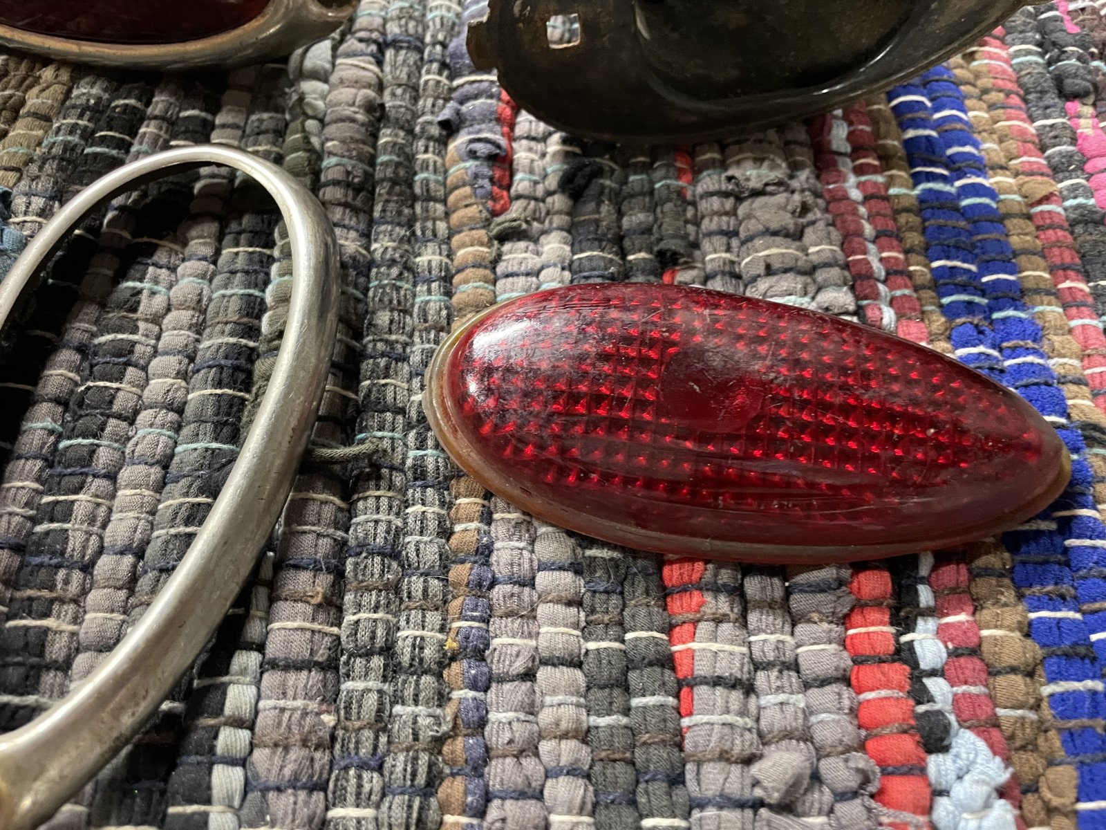

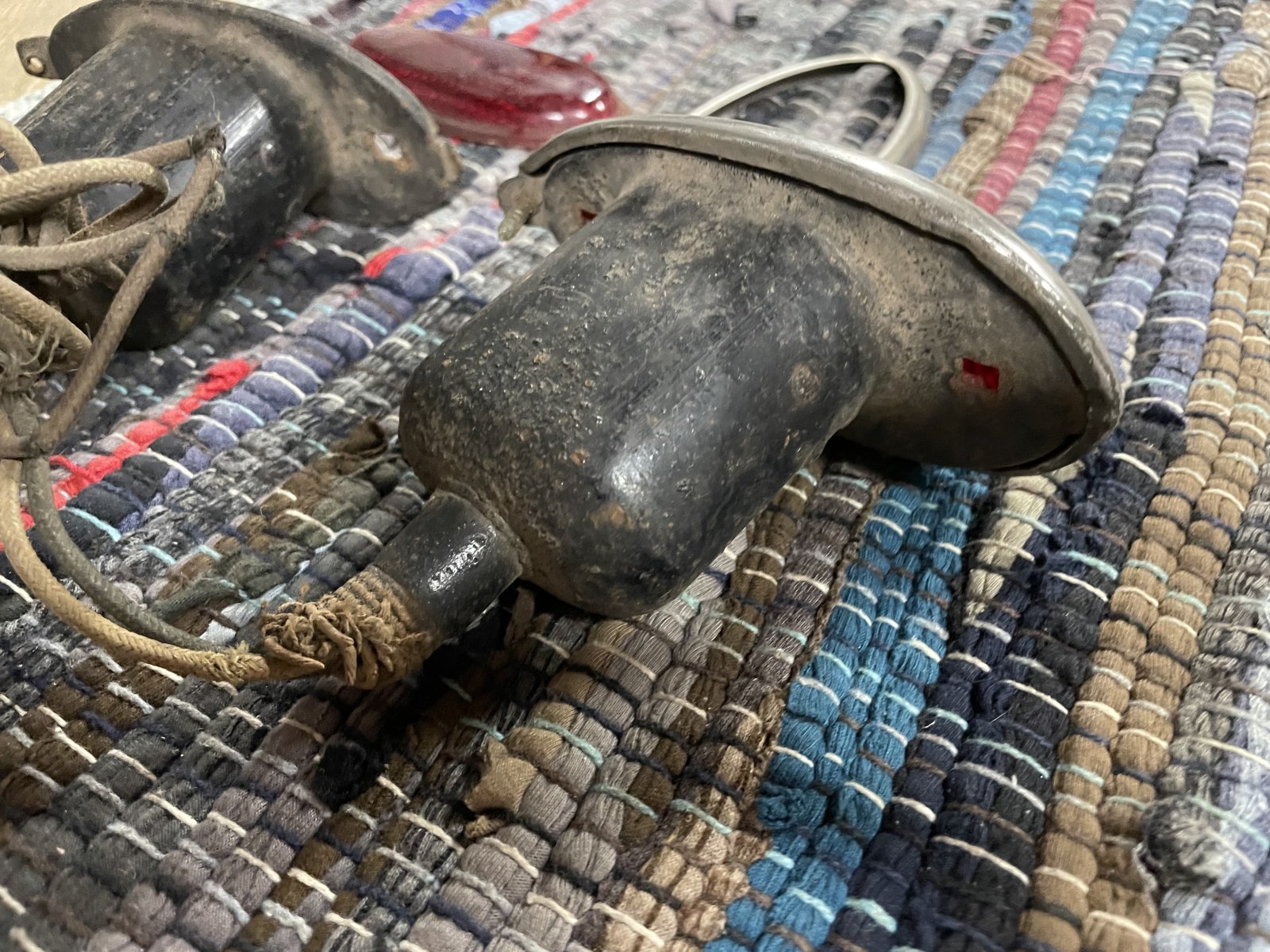

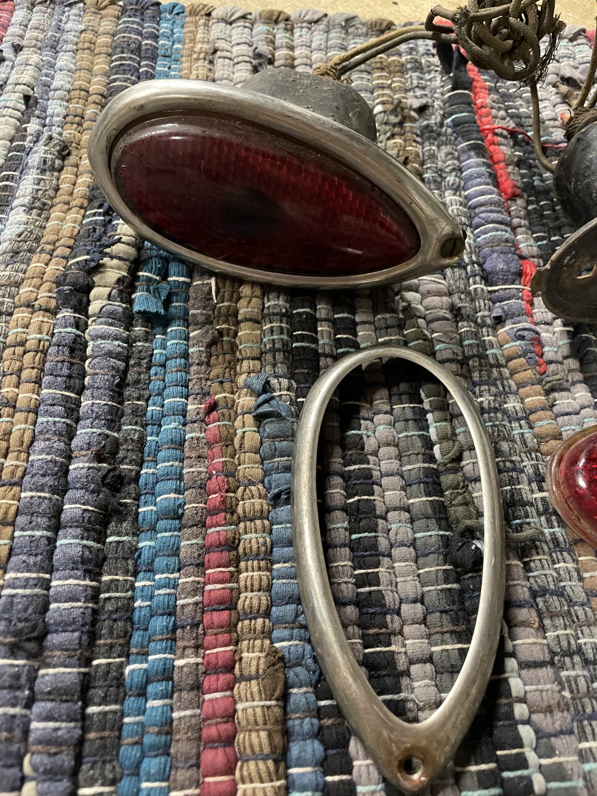

    I think these are original. What does the HAMB say?
    HemiDeuce, Just Gary and clem like this.

    yeah, if they look like that (85 years of aging), then they're original. Maybe. Crusty cloth wiring is a big clue.

    First photo shows blue dots, - were they original to 1939? I thought blue dots were a later hot rodding thing ?
    I would think that all the photos you showed are repop, although hard to say on the lens in the last photo.
    Is the original lens perhaps more rounded ?
    Interesting that the conduit in post 7 looks welded to main housing.
    None of your lights look quite like those in post 7

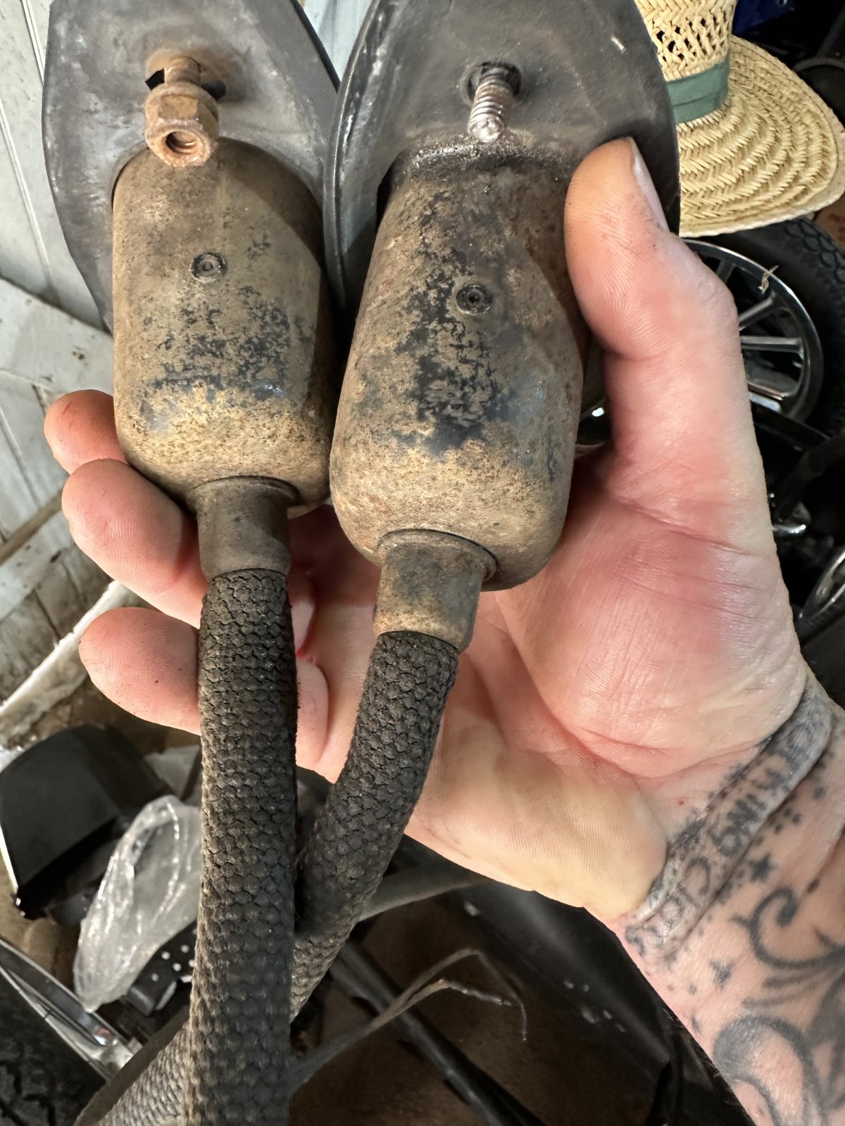

    IMG_2422.jpeg IMG_2421.jpeg I just went through this. I found a set a guy just removed from an original car to install LEDs (****ing yuck). They had cloth wire looms and cloth wire. As far as I know the repops all come with modern wire.
    Hotrodmyk and greener200 like this.

  12. verde742
