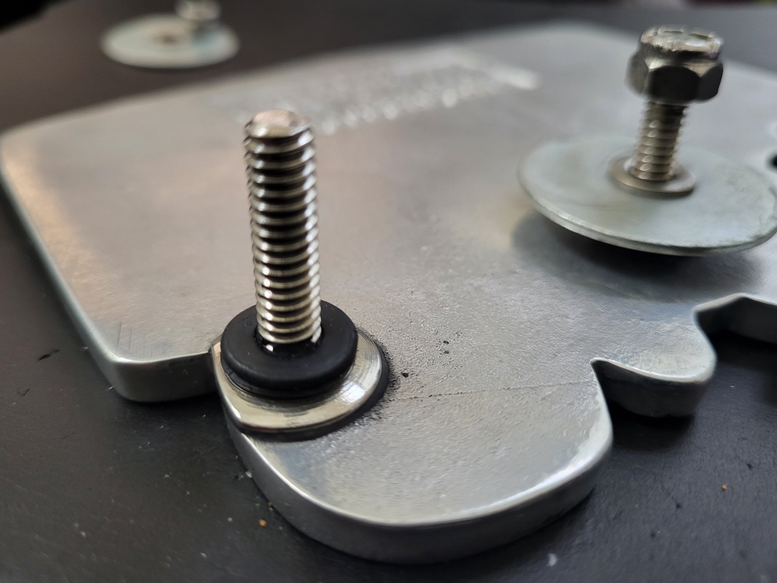

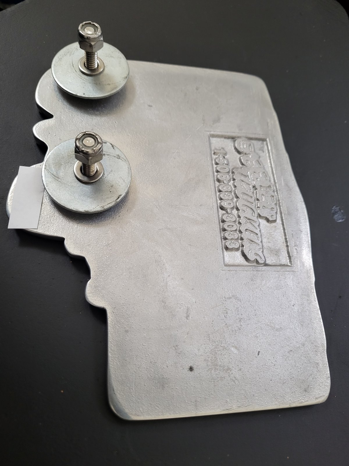

  7. I countersunk two 1/4-20 allen flathead screws, nutted them on the back with enough thread to allow mounting. Once painted (or in my case, powdercoated) they pretty much disappear.

    20230206_103411.jpg 20230206_103305.jpg I have done partly like others have said - measured thickness of plaque - drilled shallow hole for 1/4" / 20 stud on back side - using epoxy to secure - if go thru plaque just do not allow end to go out further than face of plaque - touch up paint - be cautious when tightening down to bracket - pics of one done like THE FRENCHTOWN FLYER idea
