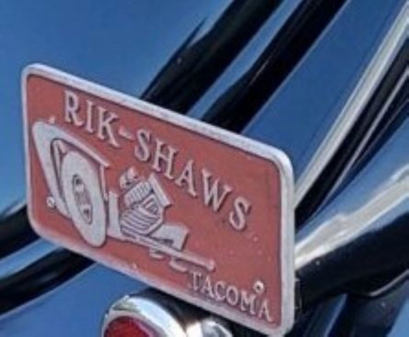

    I enlarged the picture and it looks like he drilled holes and attached it with screws rik.jpg

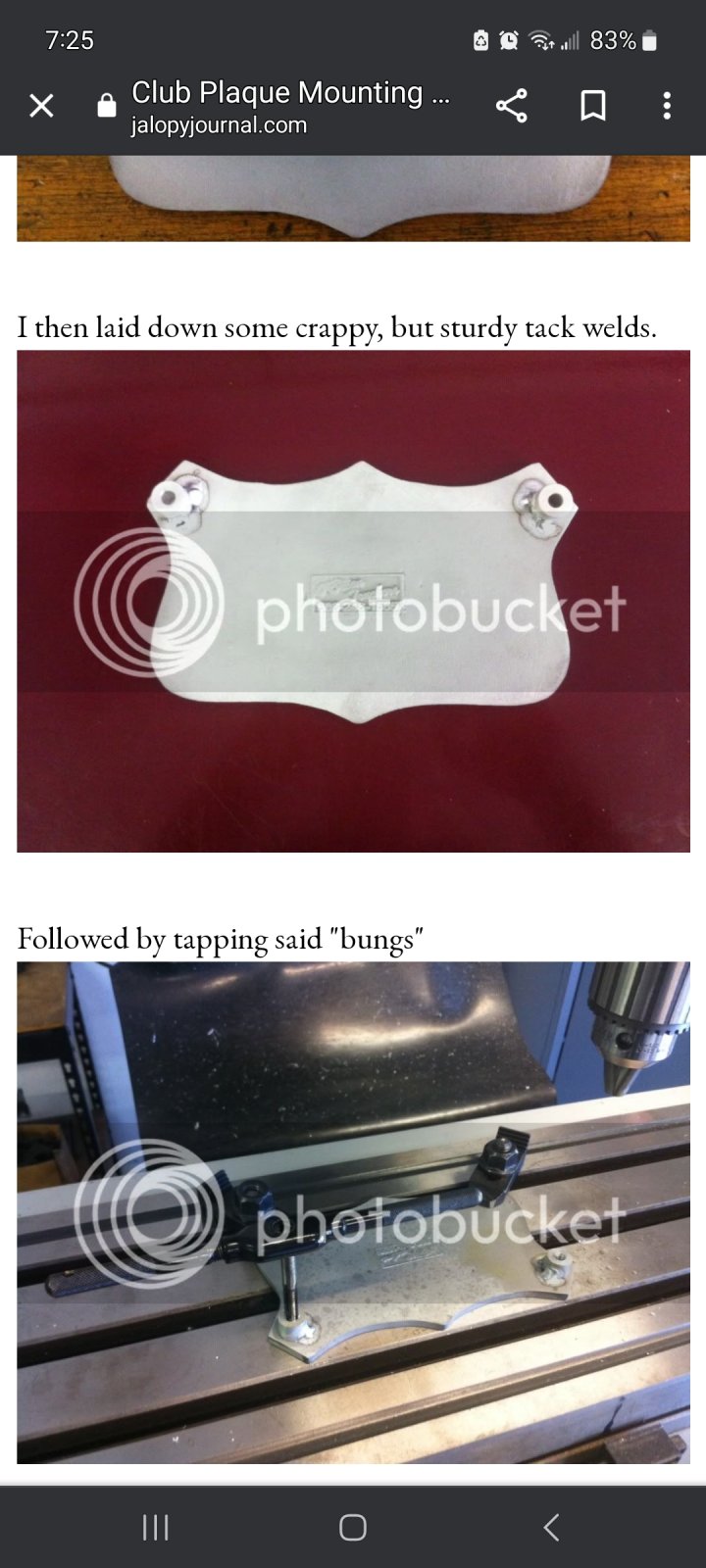

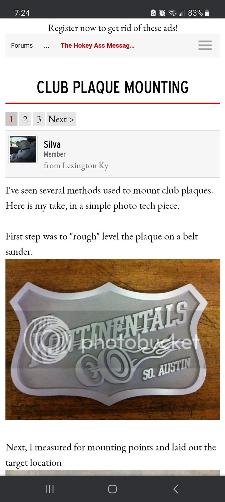

    There was a tech thread here years ago. I dont know how to link it but here's a screenshot. Screenshot_20230206_192458_Chrome.jpg Screenshot_20230206_192508_Chrome.jpg

    Kind of leaning this way after all. Interesting read. If it helps, I'm making the bracket out an old street sign. LOL!

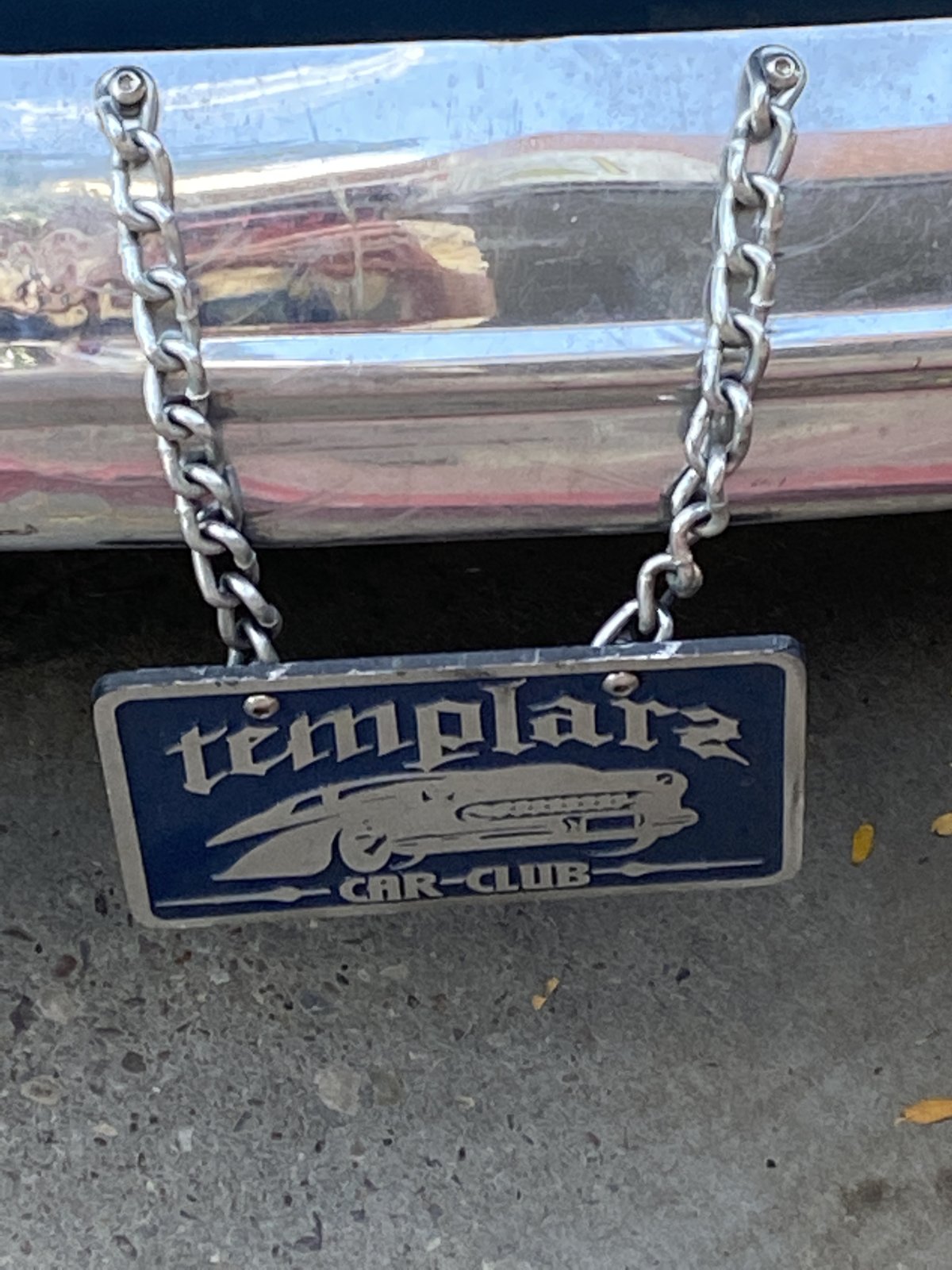

    Traditional mounting method

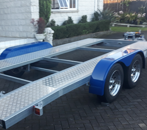

    Use the Bostik ISR 70-03 that Mimi suggested
    The downside compared to VHB is an overnight cure time, BUT it is superior in every other way
    I've used it to glue my flip-flops together AND also the aluminium deck to steel frame on my trailer, as well as the trailer fenders.[ I stand on the fenders] And the hitch coupler.
    It has a 260 psi shear load, and slightly less for tensile load [yet it remains rubbery and flexible]

    ^^ You're BSing us right? If not you're braver than I am if you really used a glue for the coupler^^

    Absolute true story!
    When I towed it down to our local inspection centre for a roadworthy. The inspection "experts" nearly had a coronary because there was no welds or mechanical fastening.
    There is 48 sq in of glue surface in the coupler = 12480 lbs of shear load. Which I explained to them, so they wanted me to supply an engineers report [which wasn't a legal requirement ,but these idiots just make up rules as they go along]
    So it was cheaper for me go away and drill and put bolts into the coupler.. Ruining the aesthetics of my beautiful trailer.
    [they wouln't p*** it with glue , but piss weak 3/8" self tap, ****on head cap screws were OK]
    I do test it to destruction before I do something stupid.
