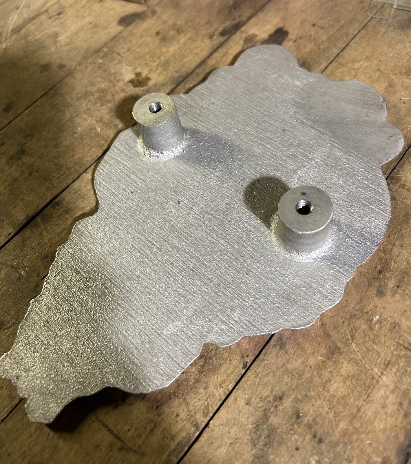

    I mentioned last Sunday how we had bosses added to our castings, here’s the photo.
    We mainly did that because of the irregular shape but still, it could be a solution for those getting new plaques.

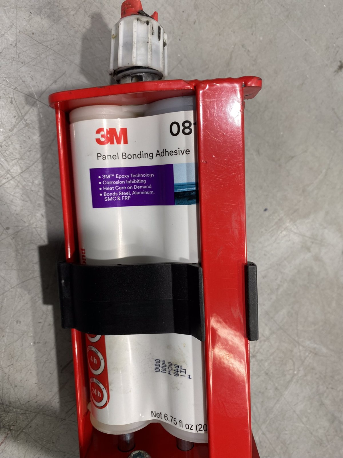

    Make sure you never need to remove, this stuff is unforgiving!

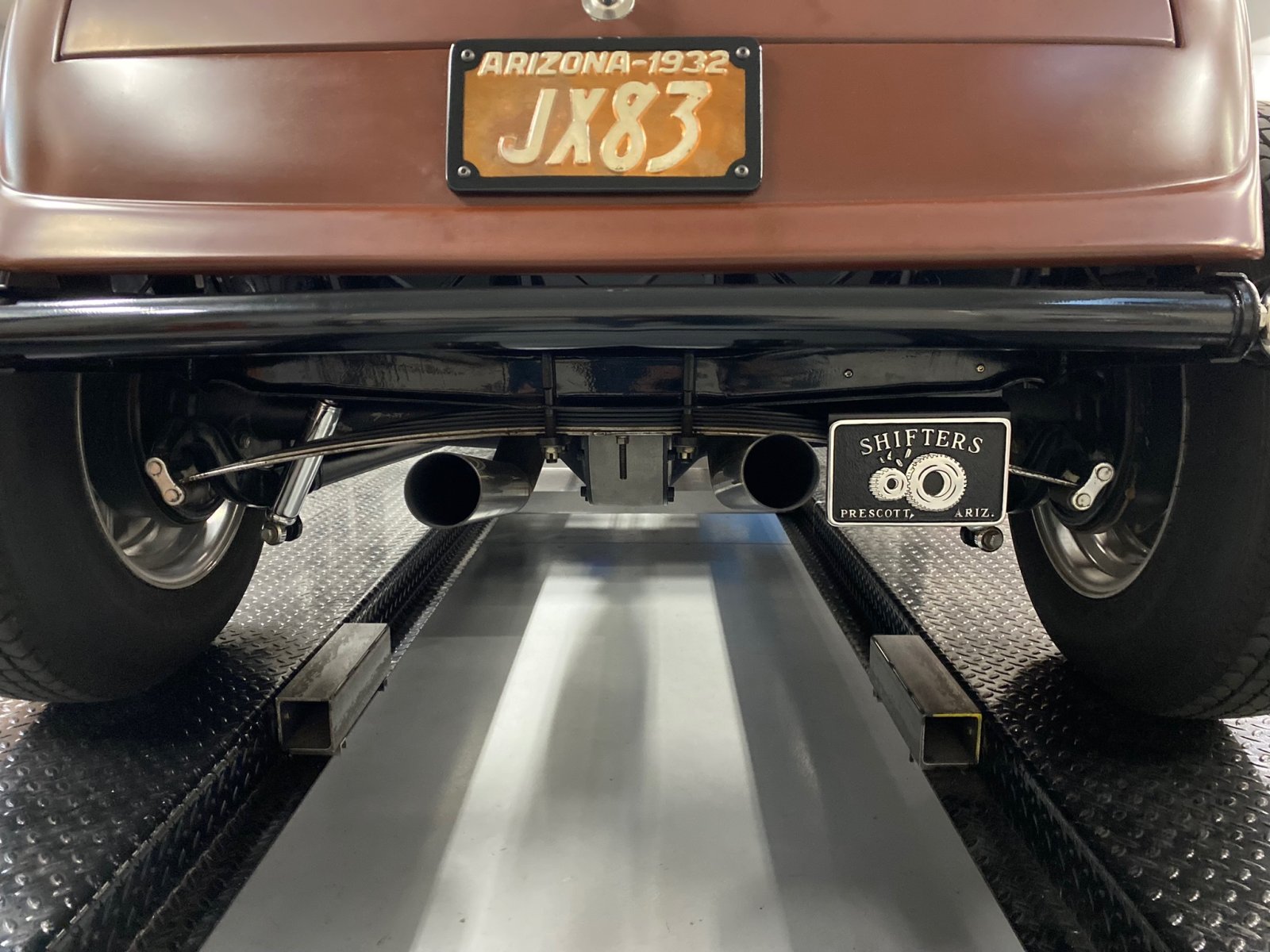

    Well, I drilled holes in the corners and painted the field. After mounting, I'll paint the bolts. Like others have said, it should disappear. I guess it was a case of overthinking it.
