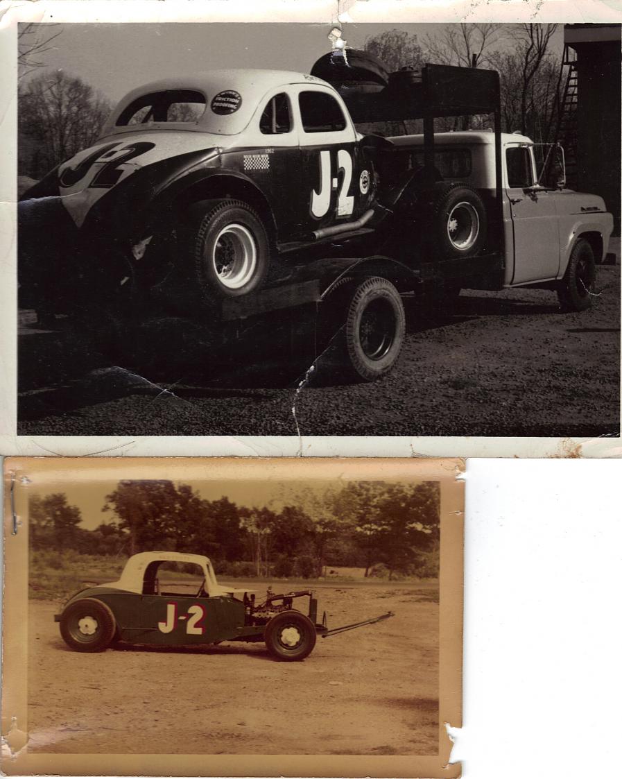

    This Northeast Y Block powered 37 Ford J-2 Stockcar was my Mothers first husbands car. Notice the tri-power air cleaners. From the stories I heard and read about this y-block it was a runner and it would have to start inverted many of times. This Y Block has won at Thompson Ct, Waterford Ct,Norwood M***,Trenton NJ,Old Bridge NJ and has raced far as Virginia. The first J-2 cut down coupe won 21 features in 1953 with a flathead. I have a DVD on the first car being built and raced. Ill see if I can put that on youtube.

    I couldnt download the tri-power picture. Sorry

    Now imagine that in something tipping the scales at say 1900 .lbs. :D
    I am picking up my second Y block this week.
    Build one mild and one WILD like that weber freak or nature..
