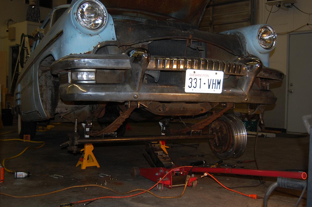

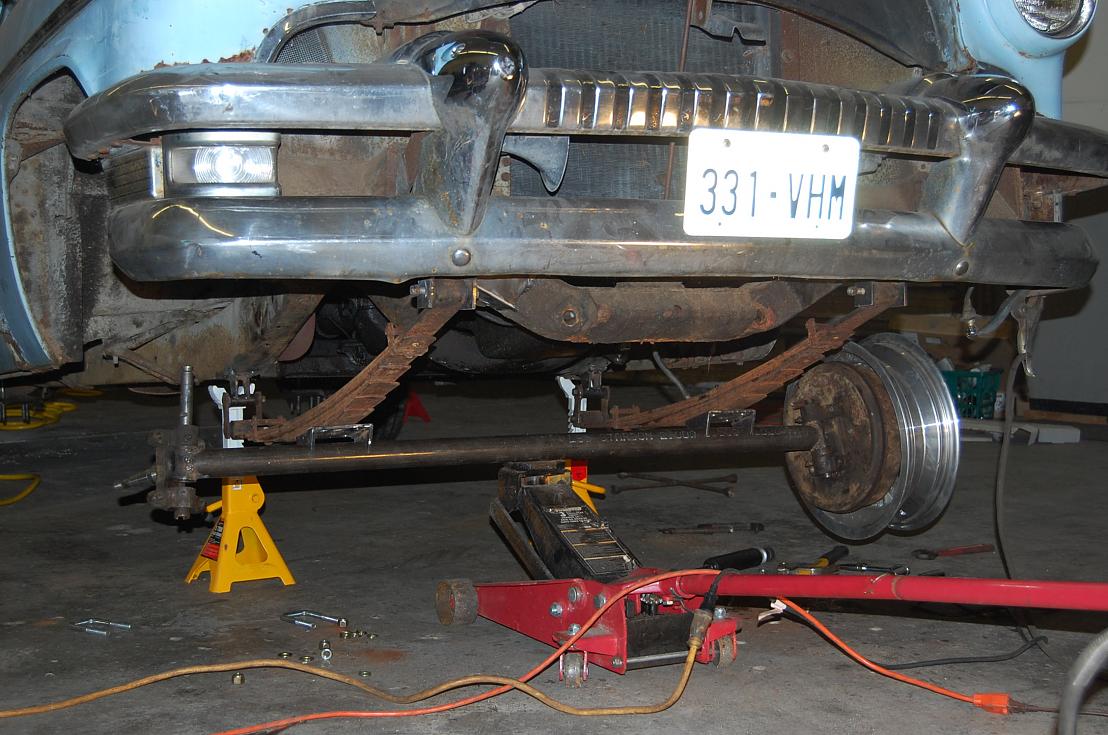

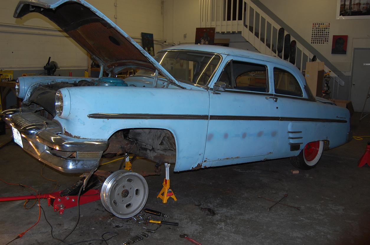

    day one on the 54 merc. Not a 55 ford, but close. I just unbolted the original suspension and welded brackets on.
