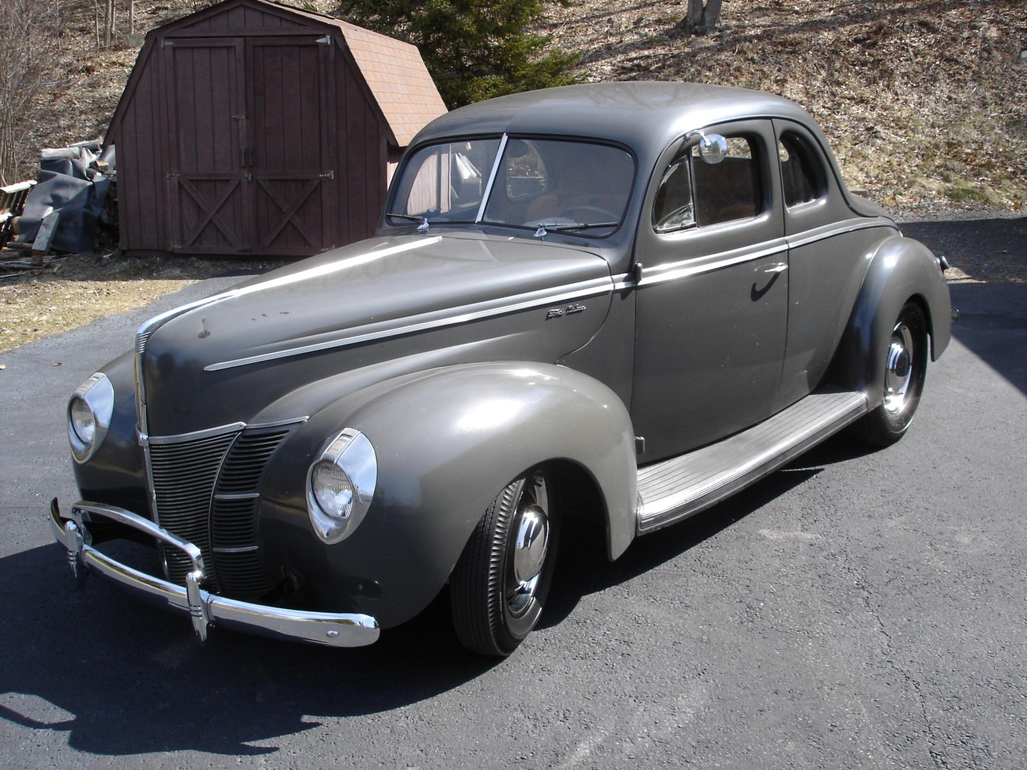

    You should do just what that article said.The only thing I changed was I used 46-48 shackles on the rear and droped it about 1 inch more.Here are some pics of my 40 coupe,before and after.
