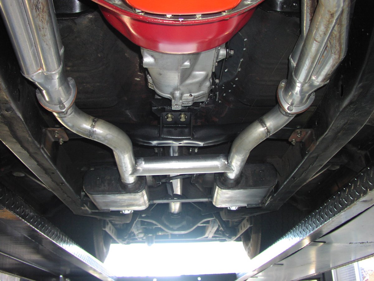

    Thanks for the info fellas. Looks like I got some definate options here! Cerberus do you have a pic of the bottom of your car with the mounts showing?

    Here's two pix. Had to modify the original bellhousing with a hack saw to get the starter to fit. Only took about one square inch off the bottom corner.
