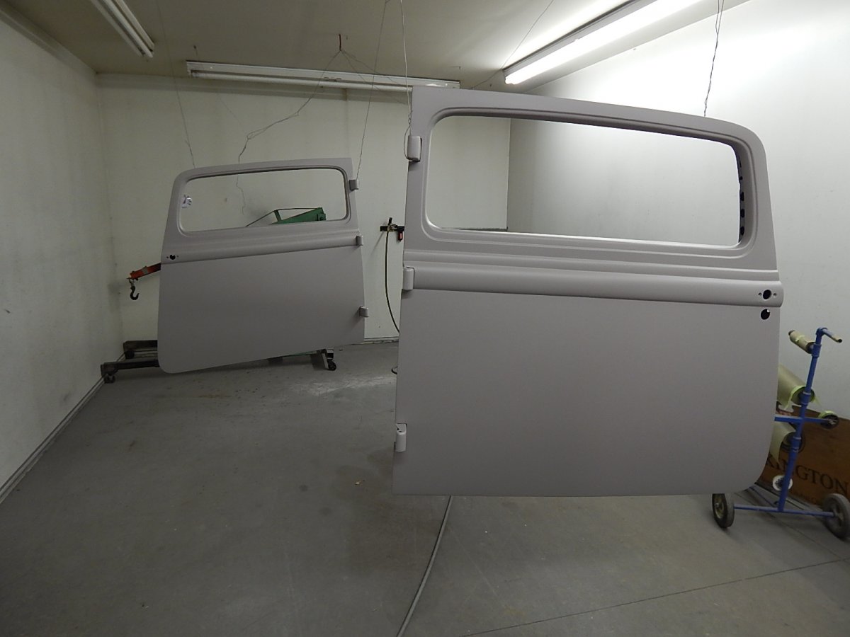

    Not paint, but I finally got some primer on my sedan doors....
    Hangin by a wire!

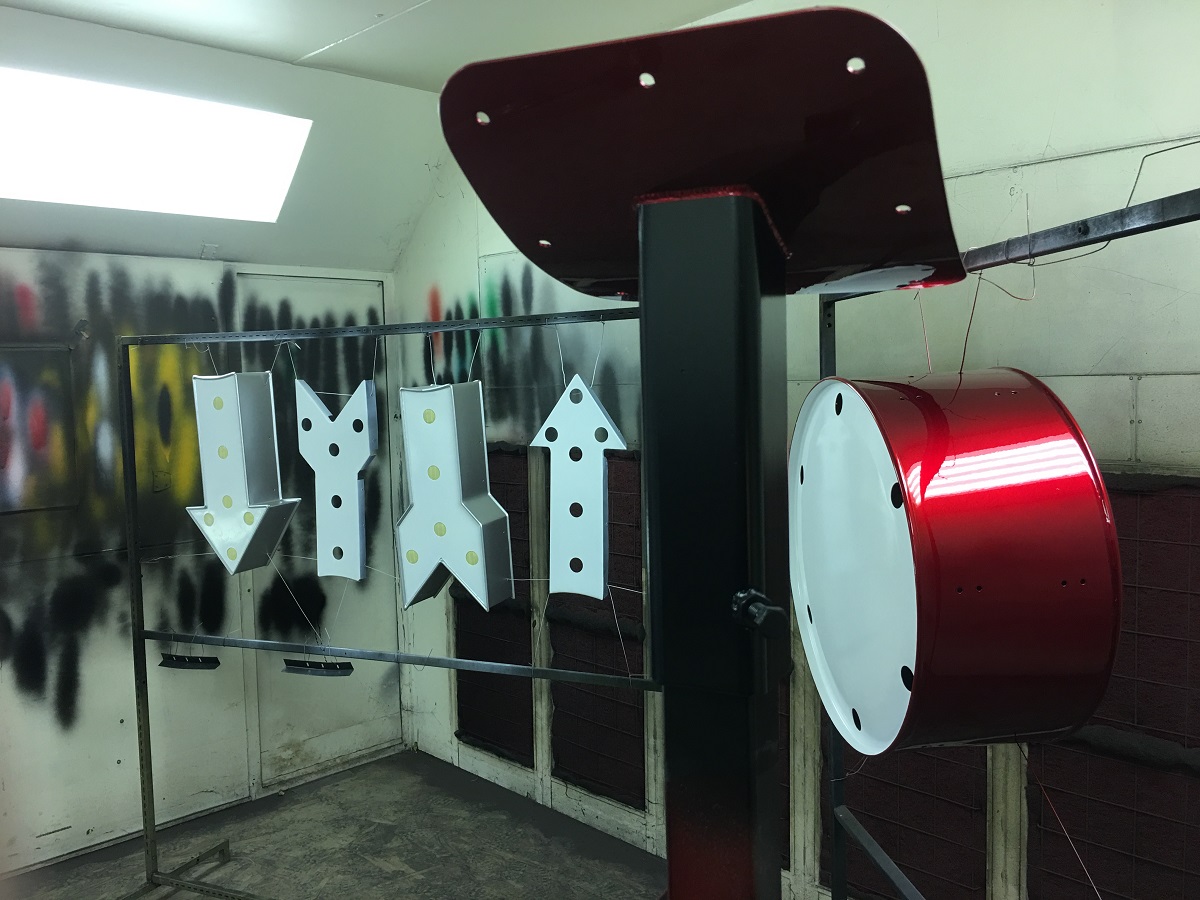

    Painting a "Drummer's Lounge" sign we fabricated
    …….looks like I need some white paint on the booth walls...

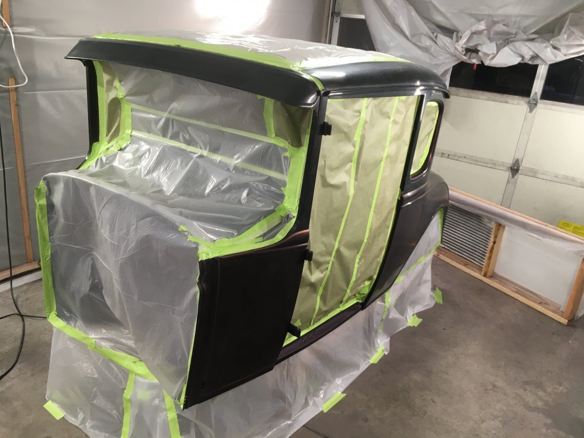

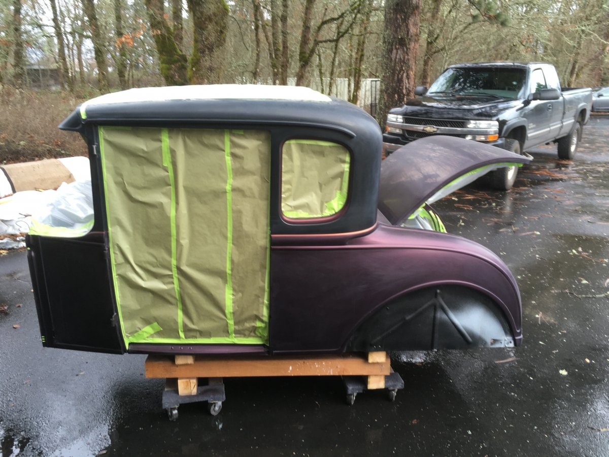

    Last week I painted some o/t rally wheels with wheel masks I got from Eastwood in the last century.
  11. plym_46
    Joined: Sep 8, 2005
    Posts: 4,018
    plym_46
    from central NY
    Free style two tone taping along hand drawn line. Roller job. True value rust x paint. post-3-13585350190219.jpg post-3-13585352658056.jpg post-3-13585350190219.jpg post-3-13585352658056.jpg post-3-13585352658056.jpg

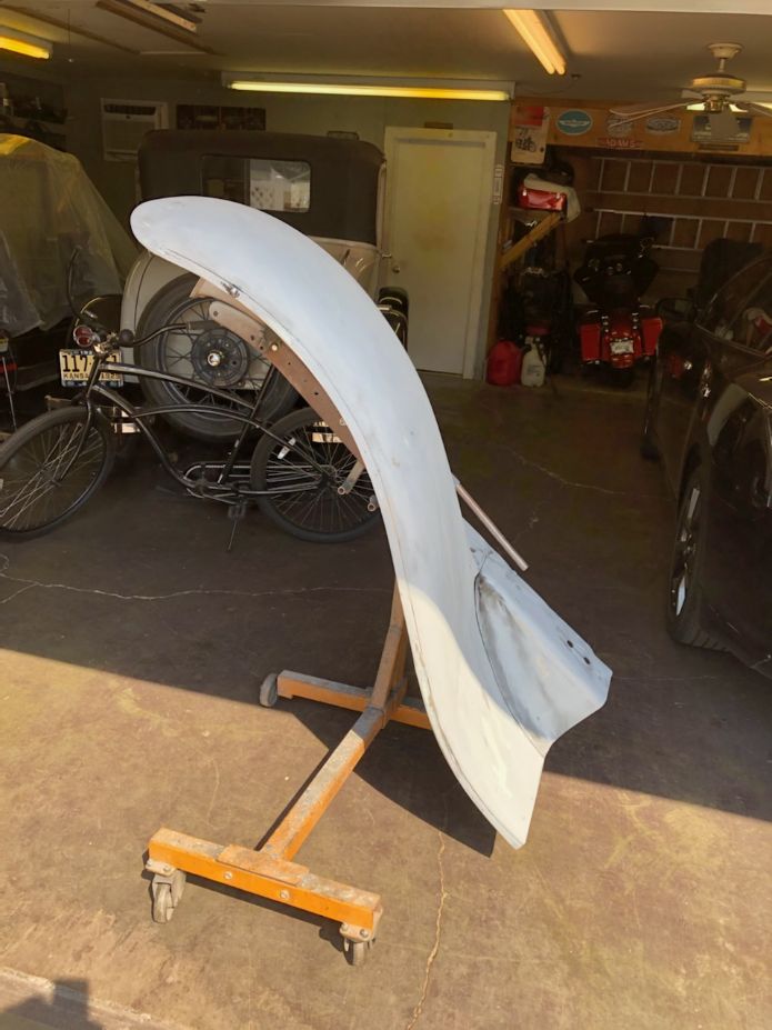

    First ever paint job:

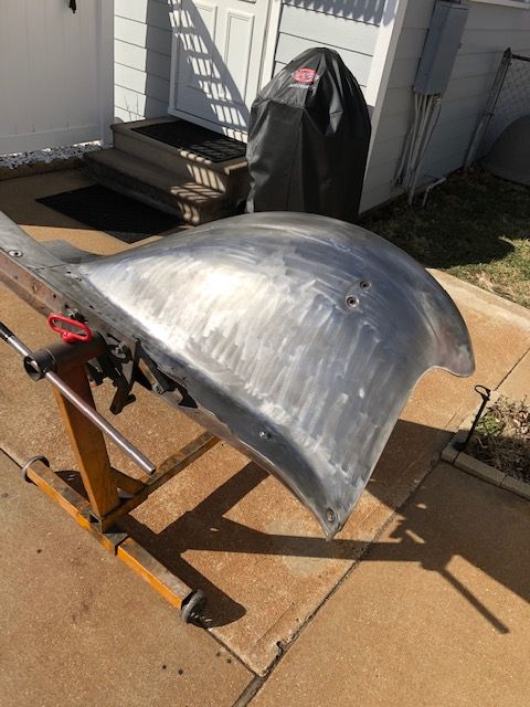

  15. tb33anda3rd
    Joined: Oct 8, 2010
    Posts: 17,585
    tb33anda3rd
    I have to paint the faces.

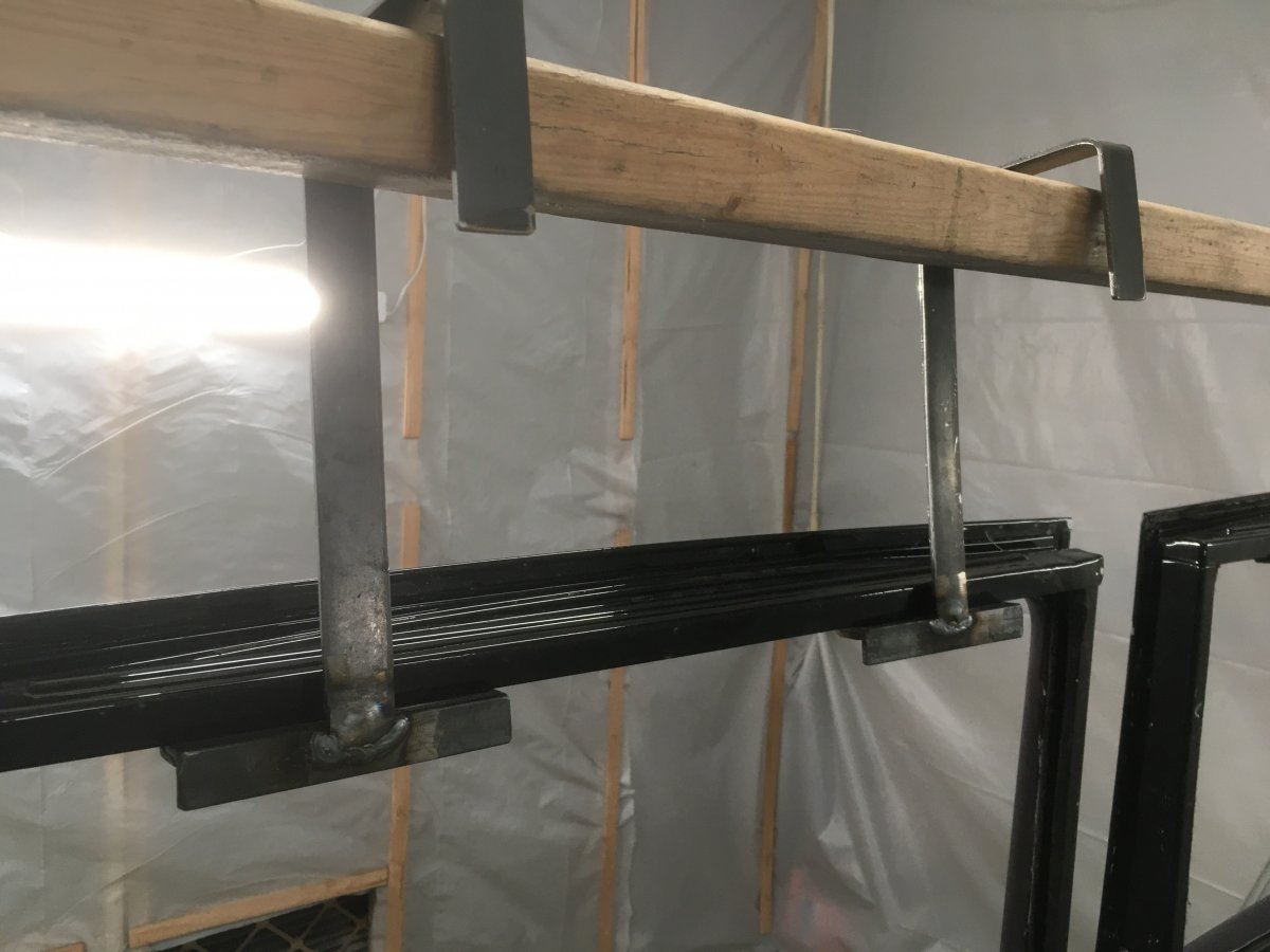

  21. tb33anda3rd
    Joined: Oct 8, 2010
    Posts: 17,585
    tb33anda3rd
    adapted the rack to paint this rolls tank. brackets are ugly but it works perfect IMG_9897.JPG IMG_9898.JPG IMG_9899.JPG

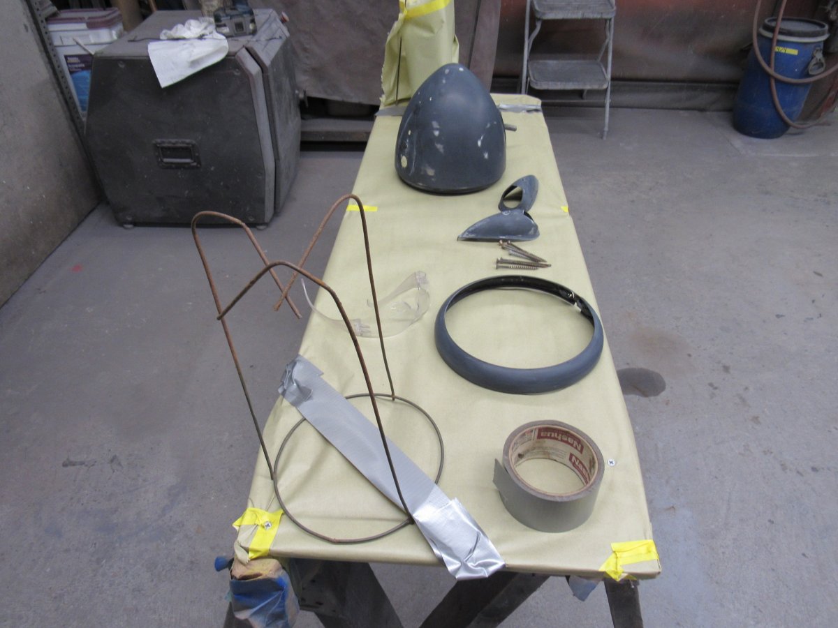

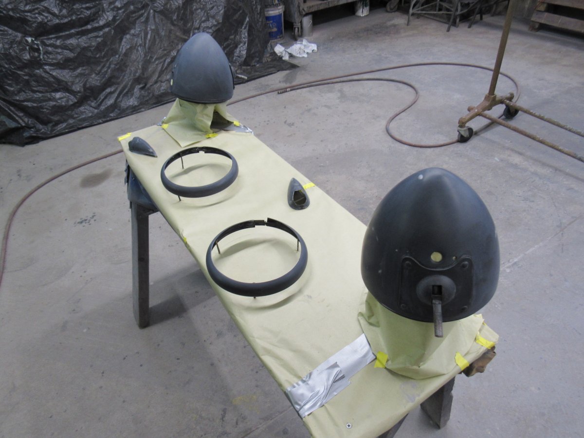

    have a very picky customer who wanted some head lights painted. I stole an idea from this thread and used a couple plant cages to hold up the lights. I taped them down and wrapped them in paper. IMG_9907.JPG IMG_9909.JPG
    drdave, Bowtie Coupe, LAROKE and 5 others like this.
  24. tb33anda3rd
    Joined: Oct 8, 2010
    Posts: 17,585
    tb33anda3rd

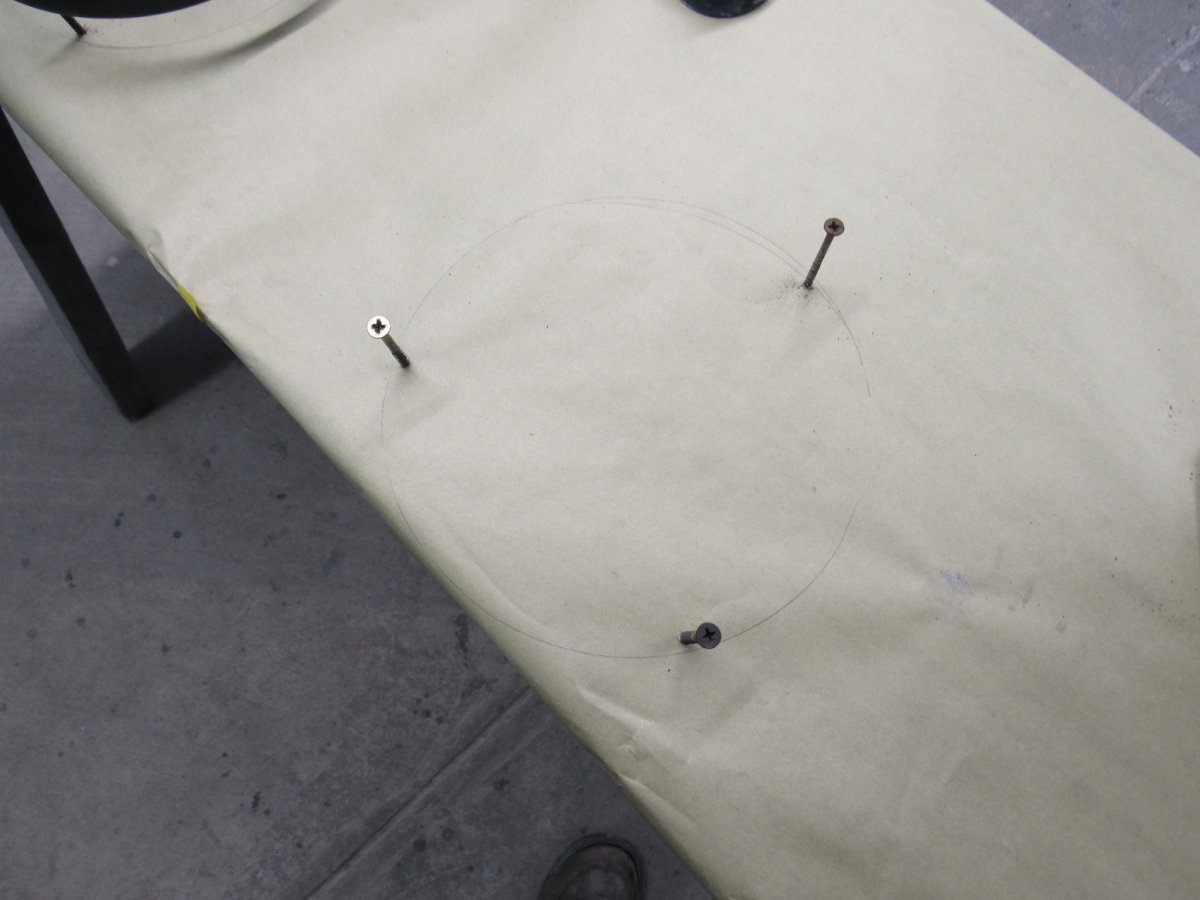

    for the head light rings I traced out the inside lip on the paper, then put three equally spaced 3" screws just to the inside of the line to hold the rings off the surface. IMG_9910.JPG

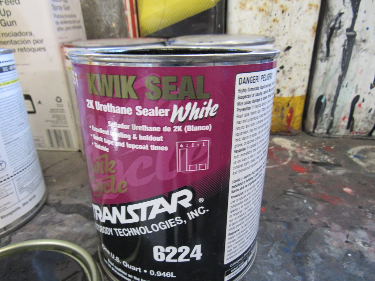

    always good to use a matching shade sealer under the paint. tinting primer/sealers is a great way to achieve the color your looking for.

    ct1932ford
    Maybe it changes color when it dries.
  30. tb33anda3rd
    Joined: Oct 8, 2010
    Posts: 17,585
    tb33anda3rd
    or Henry Ford made it...
