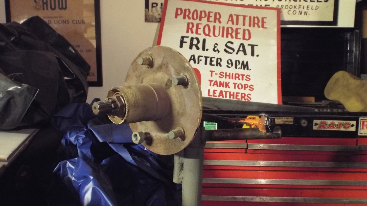

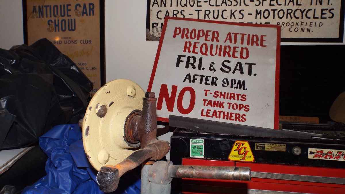

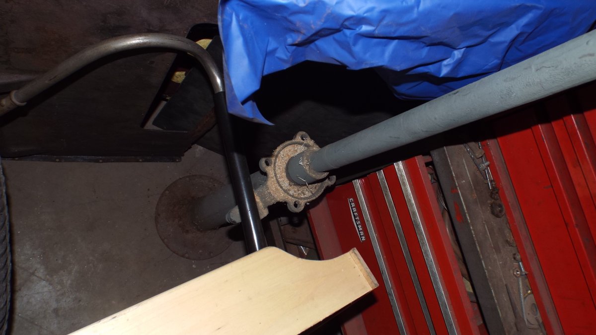

    If you plan to paint anything the idea is to put paint on ALL surfaces. I made this simple fixture 40 years ago. Model T spindle, Ford hub, an axle shaft welded to Model A trumpet. A few bricks on the base and I'm ready to paint. Bob DSCF1284.JPG DSCF1286.JPG DSCF1287.JPG
