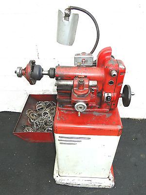

    We use an old brake drum lathe to mount and paint wheels. Spins just the right speed and never had a sag. Looks similar to this one. $_1 (1).JPG

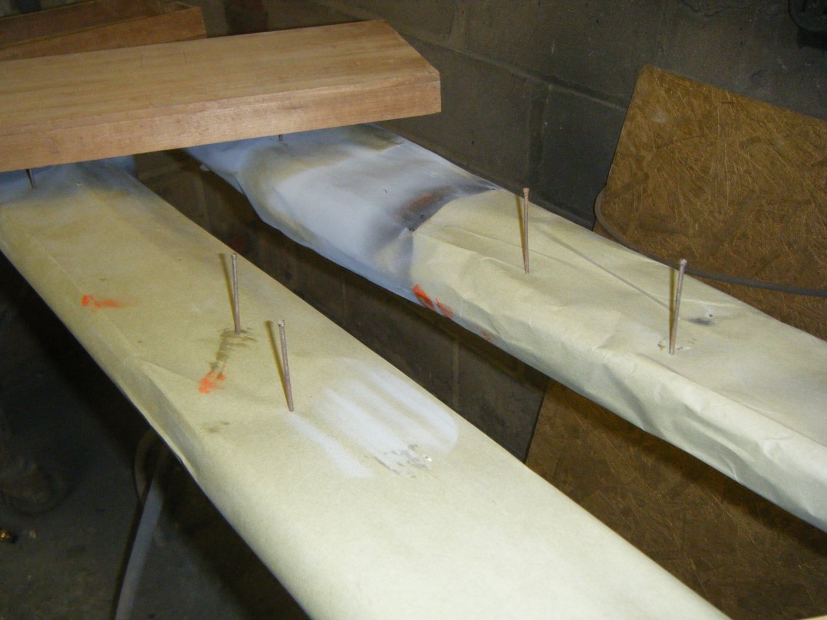

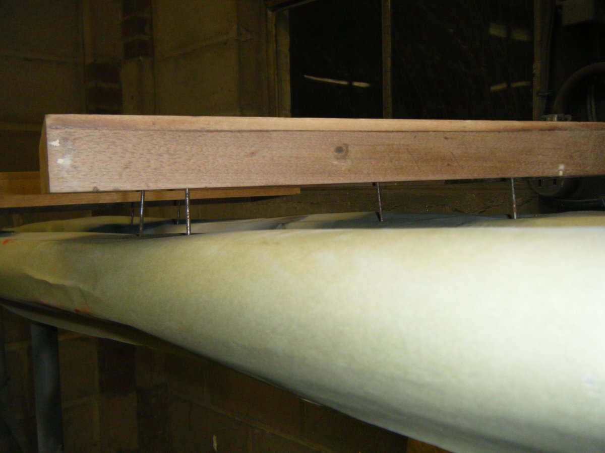

    old sign painter trick. finish nails tapped into the bench. either to lift the piece off the surface to get the top and sides or if the back side isn't critical paint/prime the back then flip and do the top and sides.

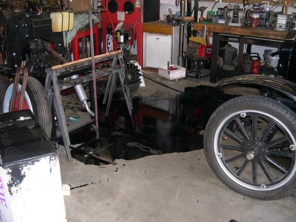

  17. "...use good hooks so it doesn't come crashing down"
    Or this could happen. :(
    That was a gallon of Ch***is Black, minus about a pint. I was painting backing plates hanging from too small wire hooks.

    bummer. what did they do? fall on the bench and knock the can over?

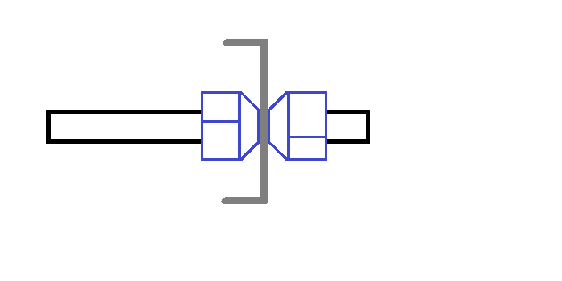

    If the part you are painting has big enough holes in it, you can use 7/16 or 1/2 inch UNF bolts and tapered wheel nuts to attach it. That way you can paint pretty much right up to the edge of the hole.
    I mounted my '32 ch***is like this through the spreader bar bolt holes when painting it and it worked really well.

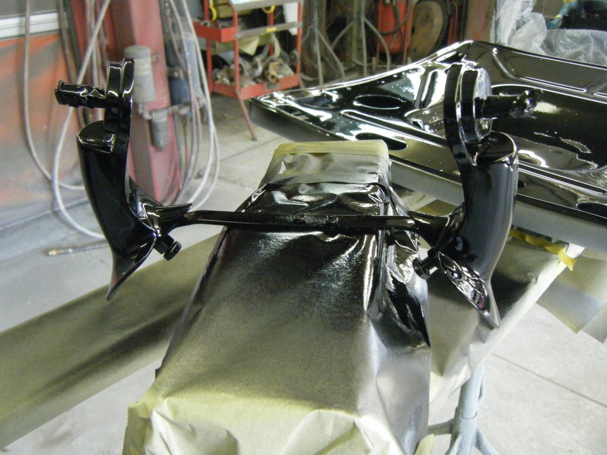

    to paint these windshield stanchions, i bent a piece of 10 gage on either end, drilled some holes to bolt to the stanchions and a couple screw holes in the middle. i then covered a 2x4 on top of a 6x6 chunk of wood with paper and screwed them to it. DSCF4929.JPG DSCF4927.JPG

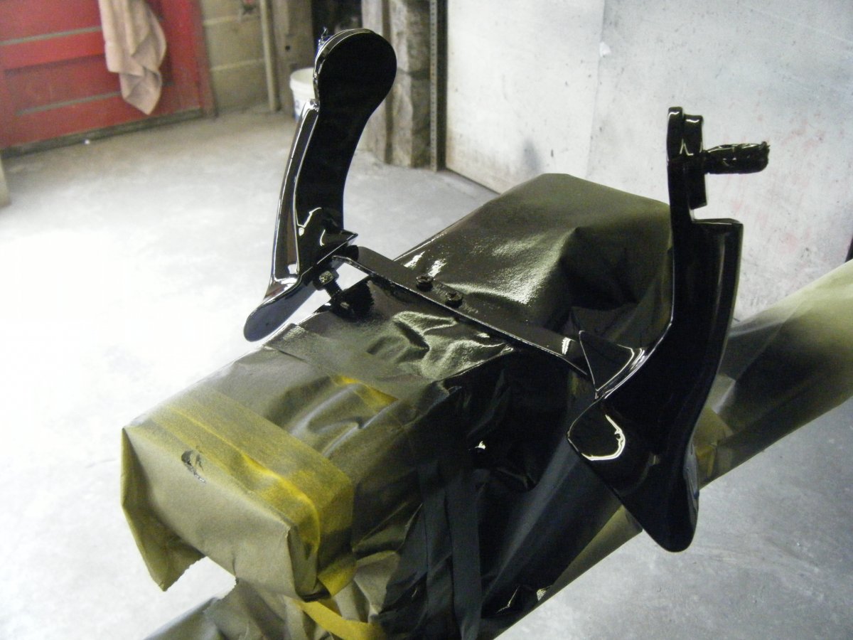

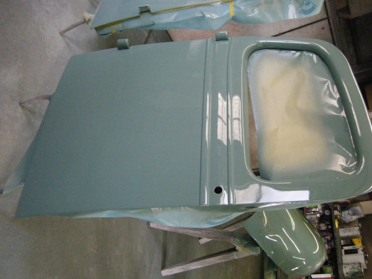

    hood has been painted on the bottom. after taping off the back side i "propped" it up, with a 2x4 wrapped in paper. this will allow me to paint around the edge. DSCF4956.JPG

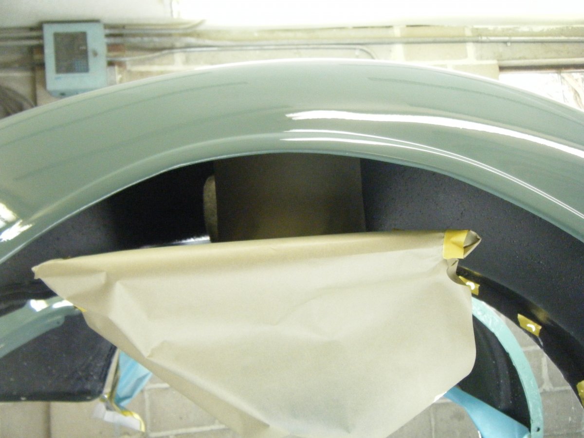

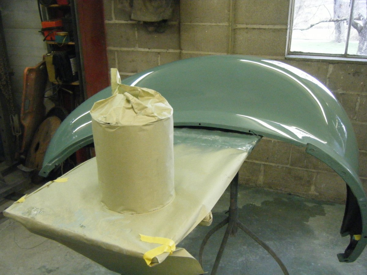

    wrapped a paint can with paper to hold this fender up off the stand. DSCF4983.JPG DSCF4986.JPG

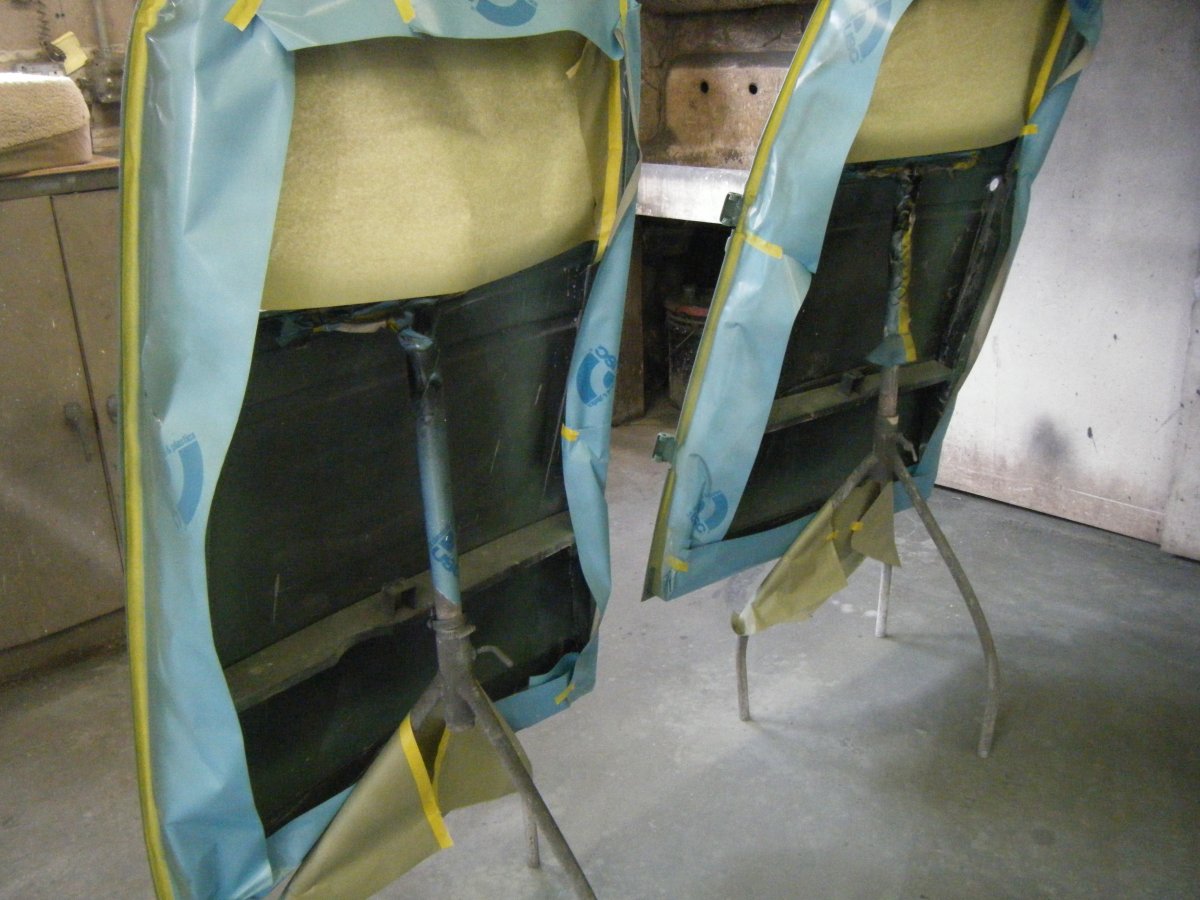

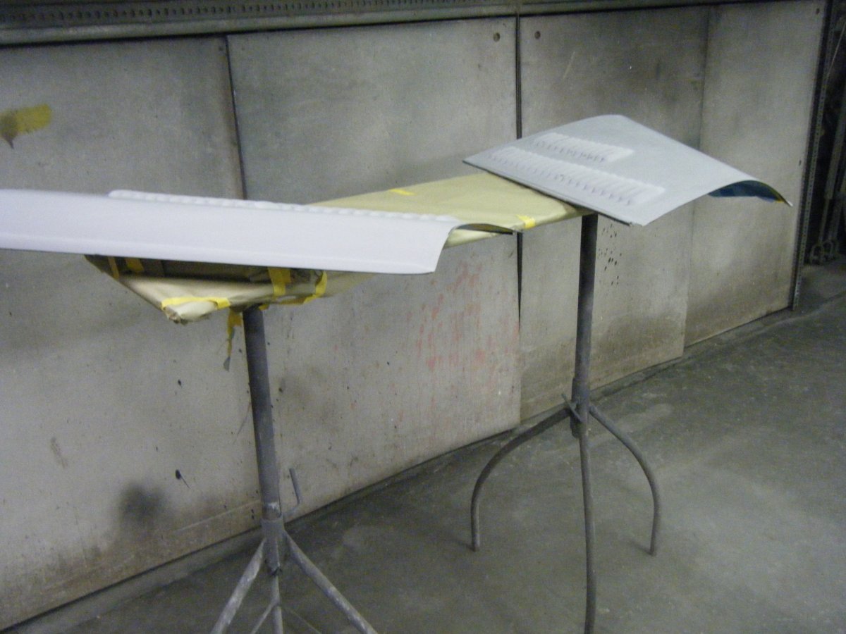

    since these 37 chevy doors have removable inner panels i was able to hook the bottom of the window opening over the top of these T stands. DSCF4982.JPG DSCF4981.JPG
