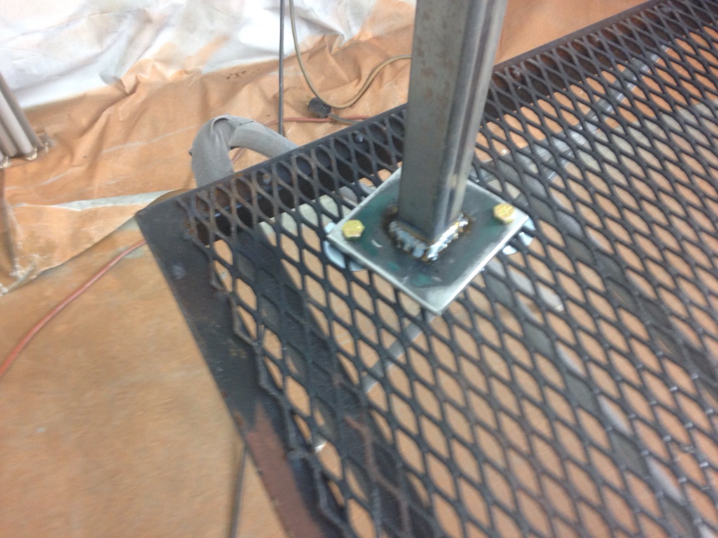

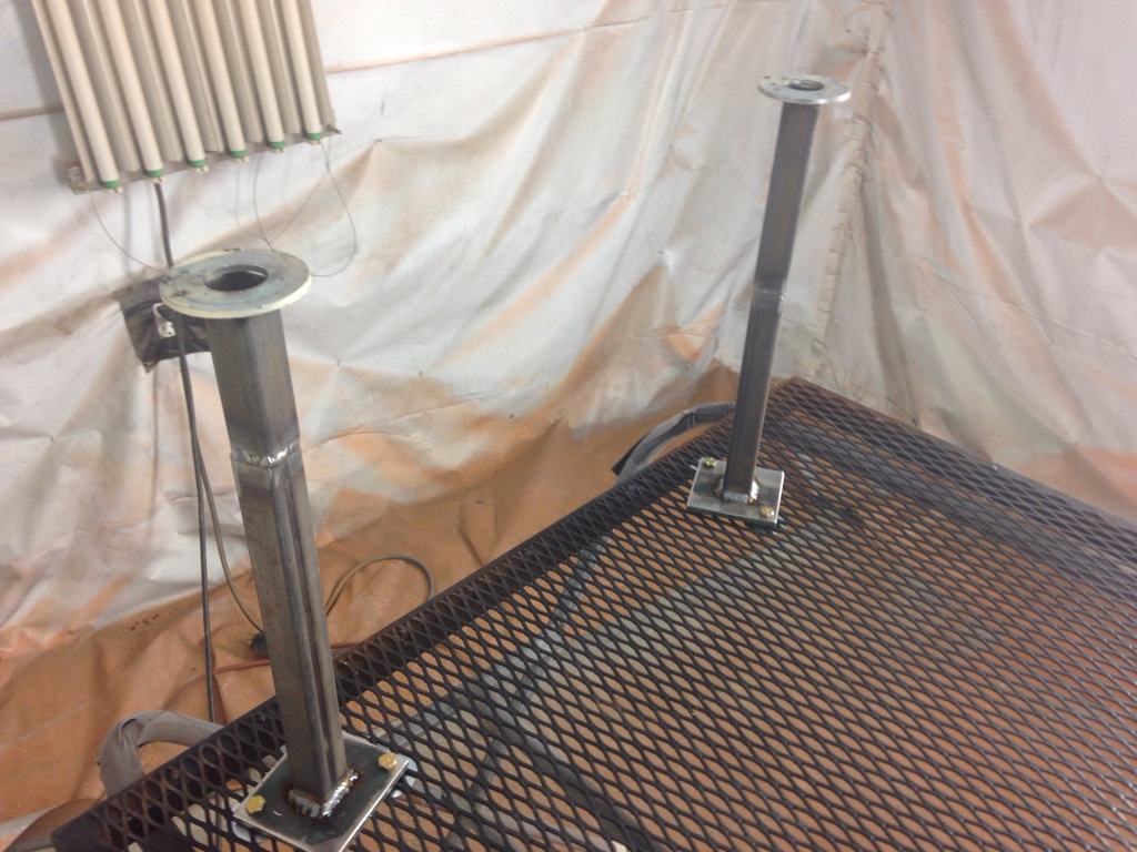

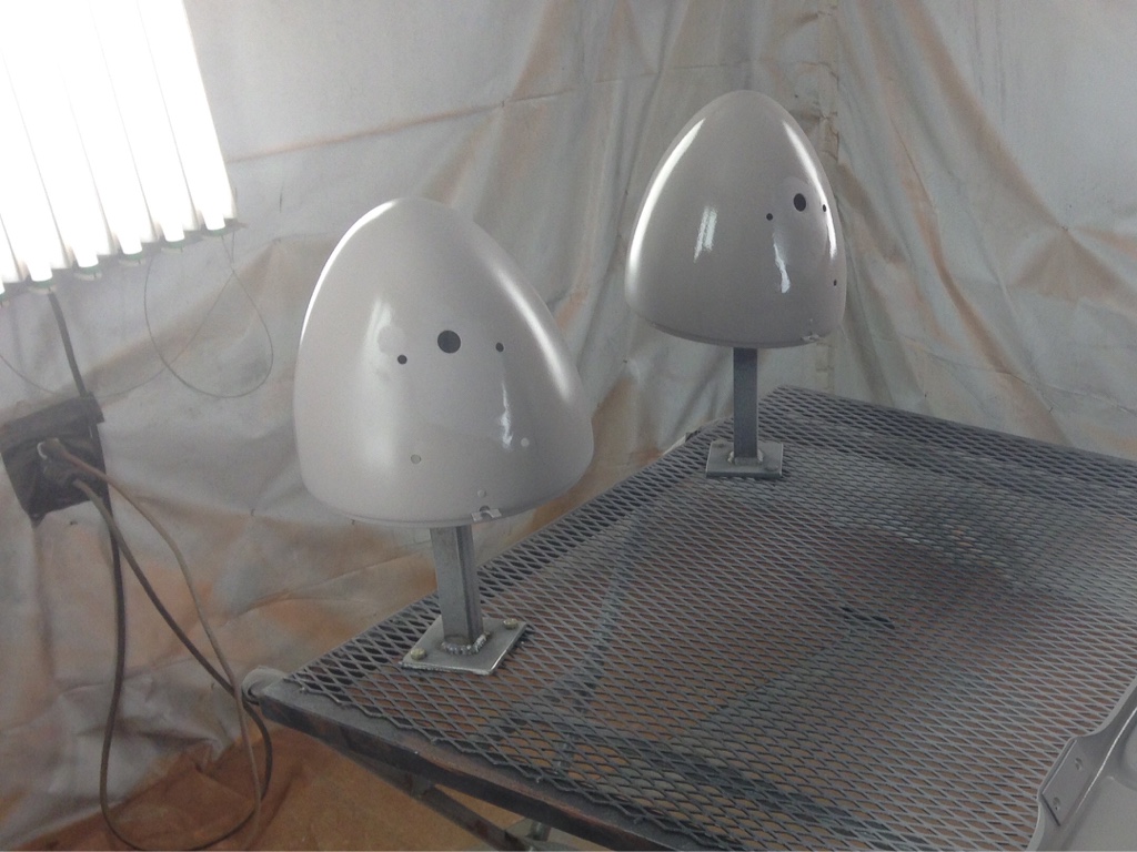

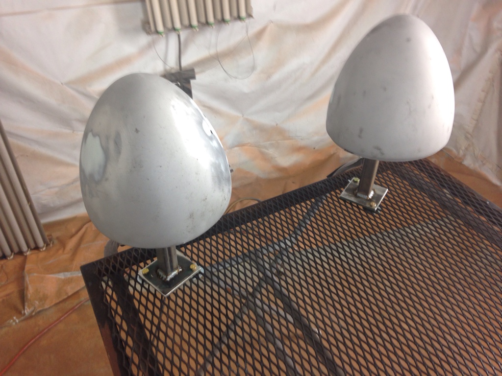

  12. bigheadbaxter
    Joined: Feb 18, 2007
    Posts: 228
    bigheadbaxter
    ImageUploadedByH.A.M.B.1461533940.229020.jpg ImageUploadedByH.A.M.B.1461533950.861449.jpg ImageUploadedByH.A.M.B.1461533968.211618.jpg ImageUploadedByH.A.M.B.1461534069.344399.jpg . Made these little stands to stabilize these buckets. I used this expanded metal table top to lightly bolt the bases to.
    MP&C, brad2v, tb33anda3rd and 3 others like this.

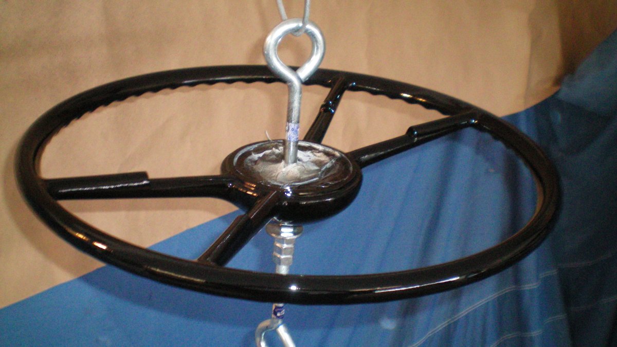

  17. tb33anda3rd
    Joined: Oct 8, 2010
    Posts: 17,585
    tb33anda3rd
    hah!

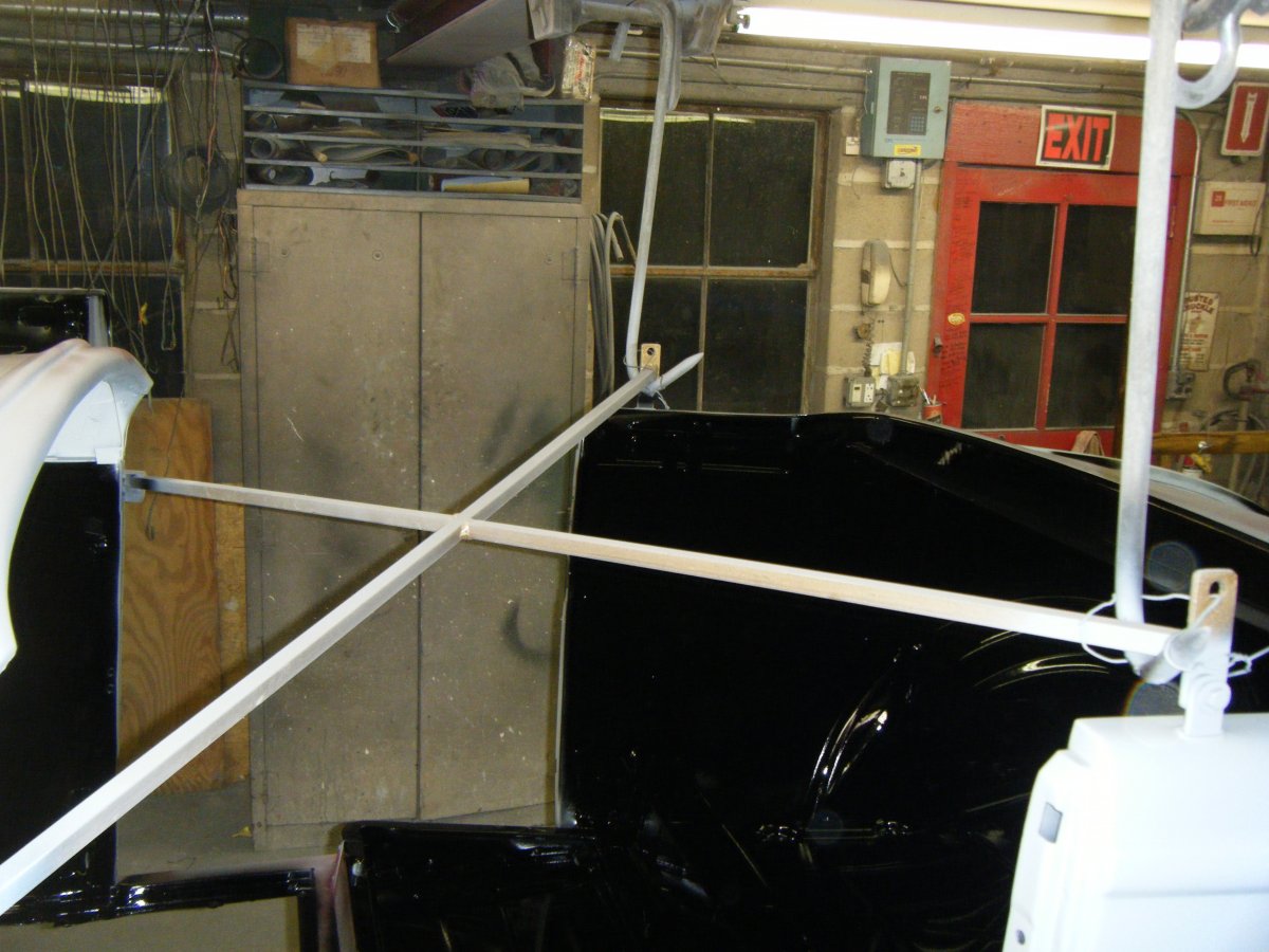

    image.jpeg image.jpeg Hung my headlight bar to prime it...what a pain. Plywood and two pieces of ready rod will make painting it much easier.

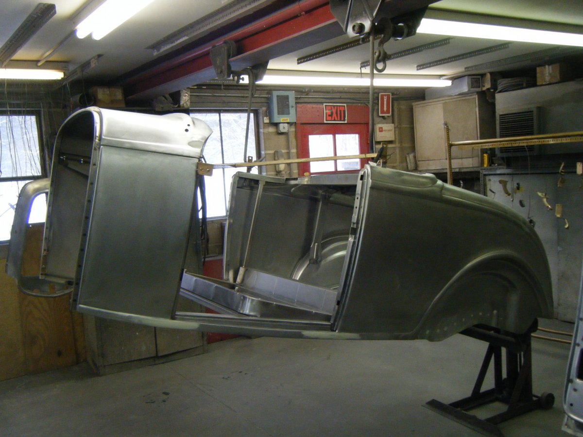

    I made this rotisserie last week to hold my hood for body work and painting. It will allow my to tilt it from side to side so that I can work the middle of the hood without leaning out over it. The other stand
    holds the two front fenders. partstand10.jpg The metal tubing is recycled shipping pallets given to me by a friend.
    John
    cptn60, Binger and tb33anda3rd like this.

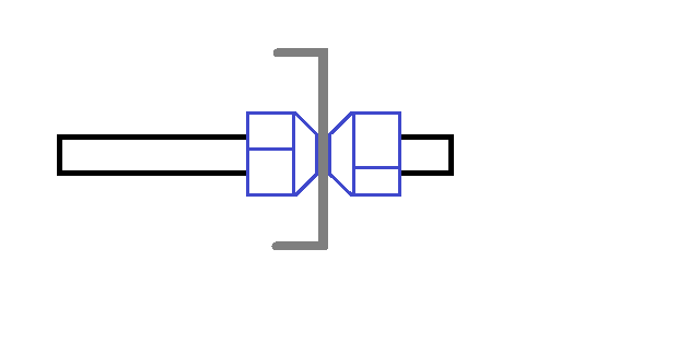

    Some all thread, nuts and rhs to paint both sides of my tank.
    tb33anda3rd likes this.
