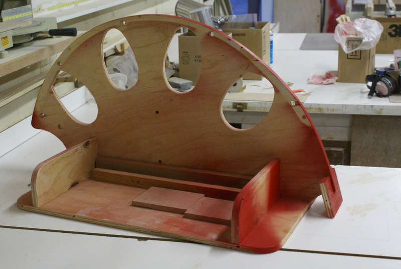

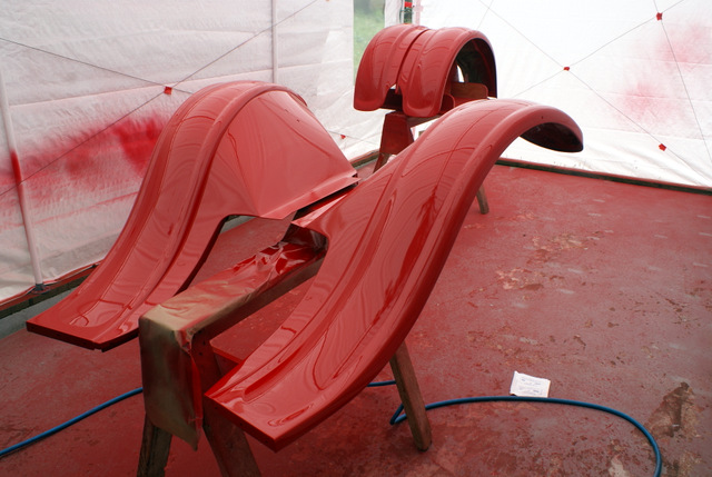

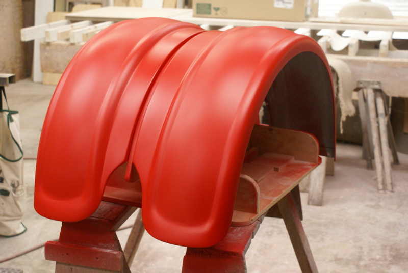

    1.JPG DSC01620-001.JPG DSC05910-002.JPG DSC05917-001.JPG A couple things to hold fenders.
    nunattax, DdoubleD, Johnboy34 and 7 others like this.

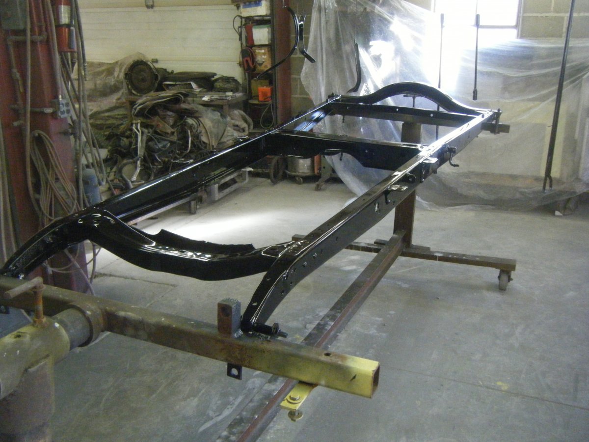

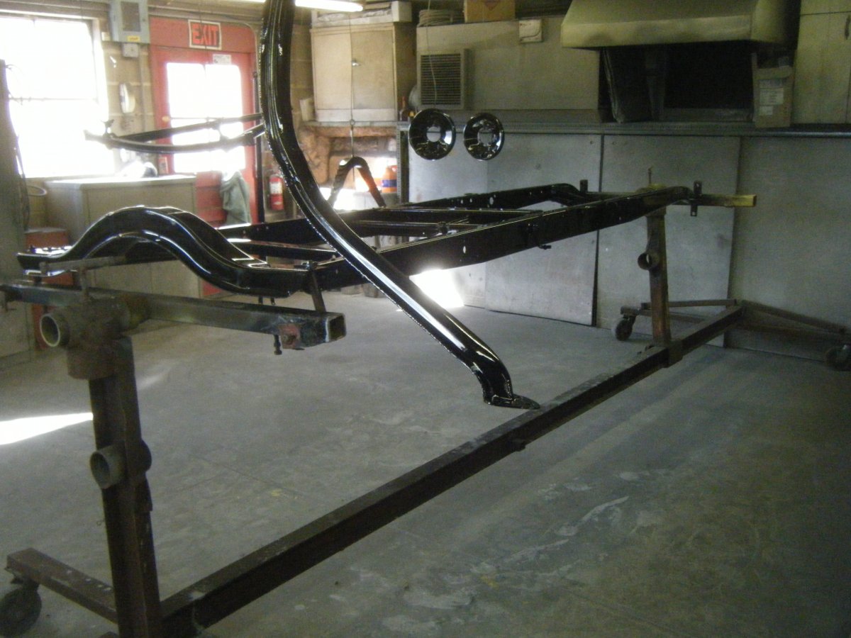

    DSCF0005.JPG DSCF0002.JPG model a ch***is on home made rotisserie . DSCF0005.JPG DSCF0002.JPG

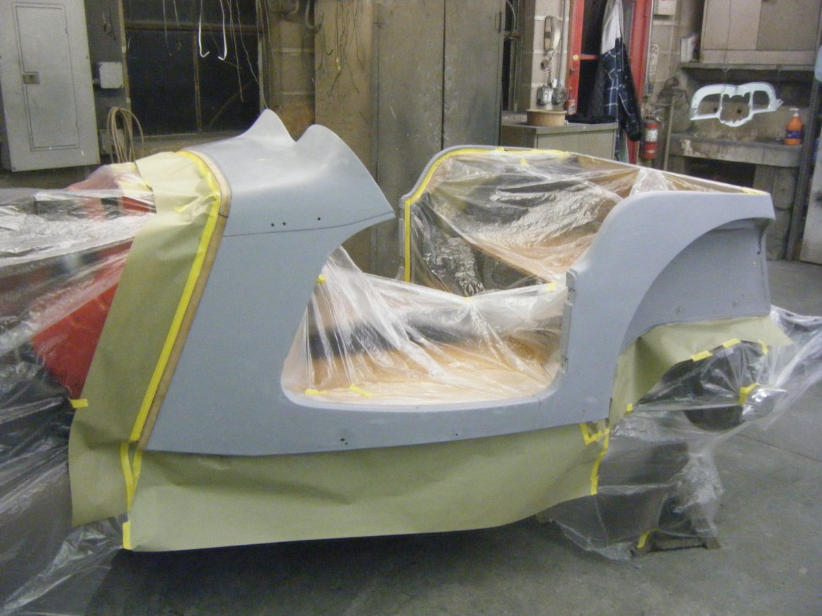

    made a quick rotisserie to paint this fuel tank. used my garment rack and some angle iron shelf metal. DSCF0006.JPG DSCF0005.JPG
    ct1932ford and The37Kid like this.

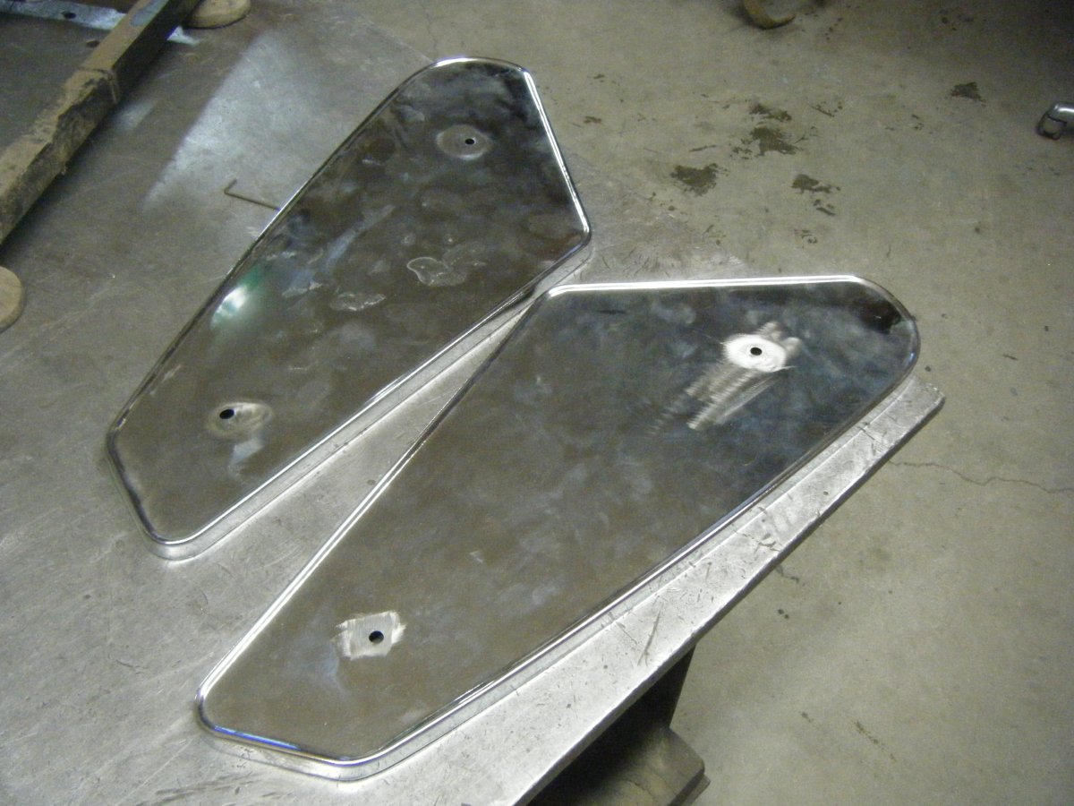

    the covers are the typical repo pieces. ****ty chrome, ill fitting, holes needed to be moved over and welded up. i will post a photo later. the centers need to be prepped for paint so i was going to post how i did it here. stay tuned......

    here are the covers. the chrome around the edge will be masked off, i will blast the center sections to etch them then prime, sand and paint. DSCF0004.JPG you can see where i have moved the holes over and welded the old holes up. these bolt onto the sides of the tank and are held in by a couple chrome acorn bolts.

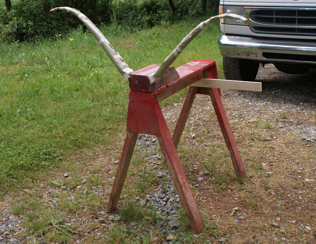

  17. Made up some quickies.
    brad2v, The37Kid and tb33anda3rd like this.

    Cool! Never seen those B4...
    I guess they look like a chrome edge on the tank when you paint'em your way.

    it is always worth it to take the time to set up to paint. this rotisserie set up took about a half hour, but i was able to paint all six sides and get paint into all the nooks and crannies . DSCF0005.JPG
    brad2v likes this.

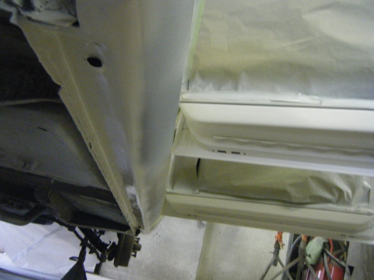

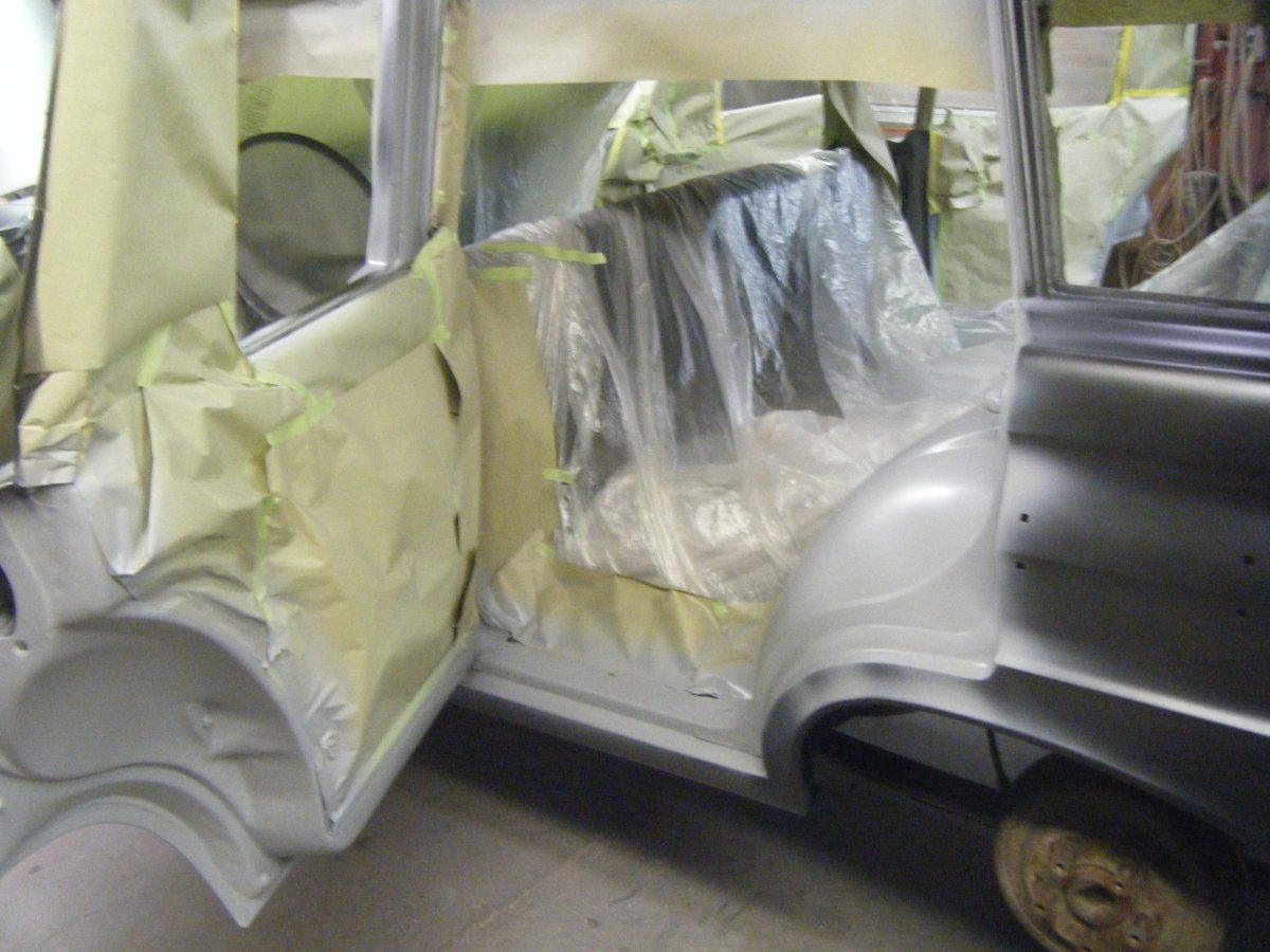

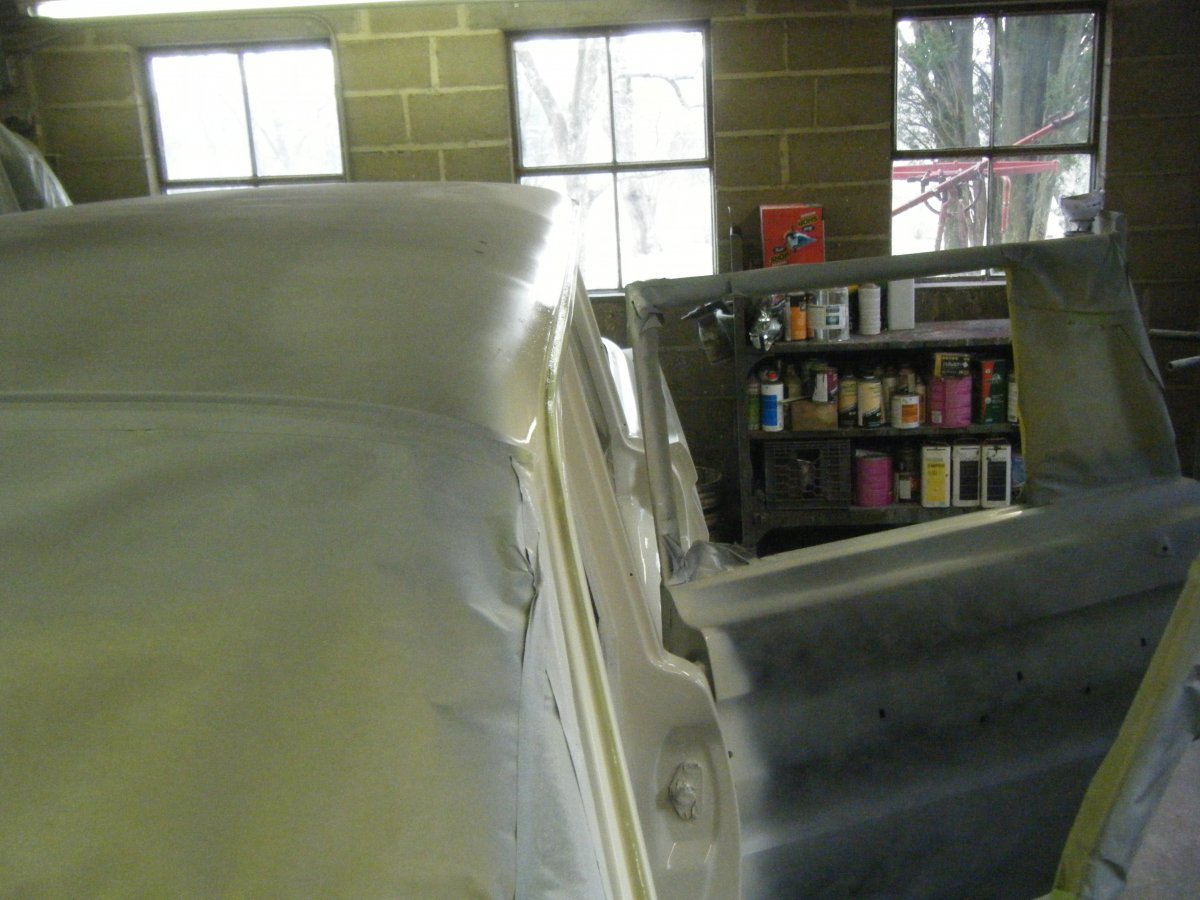

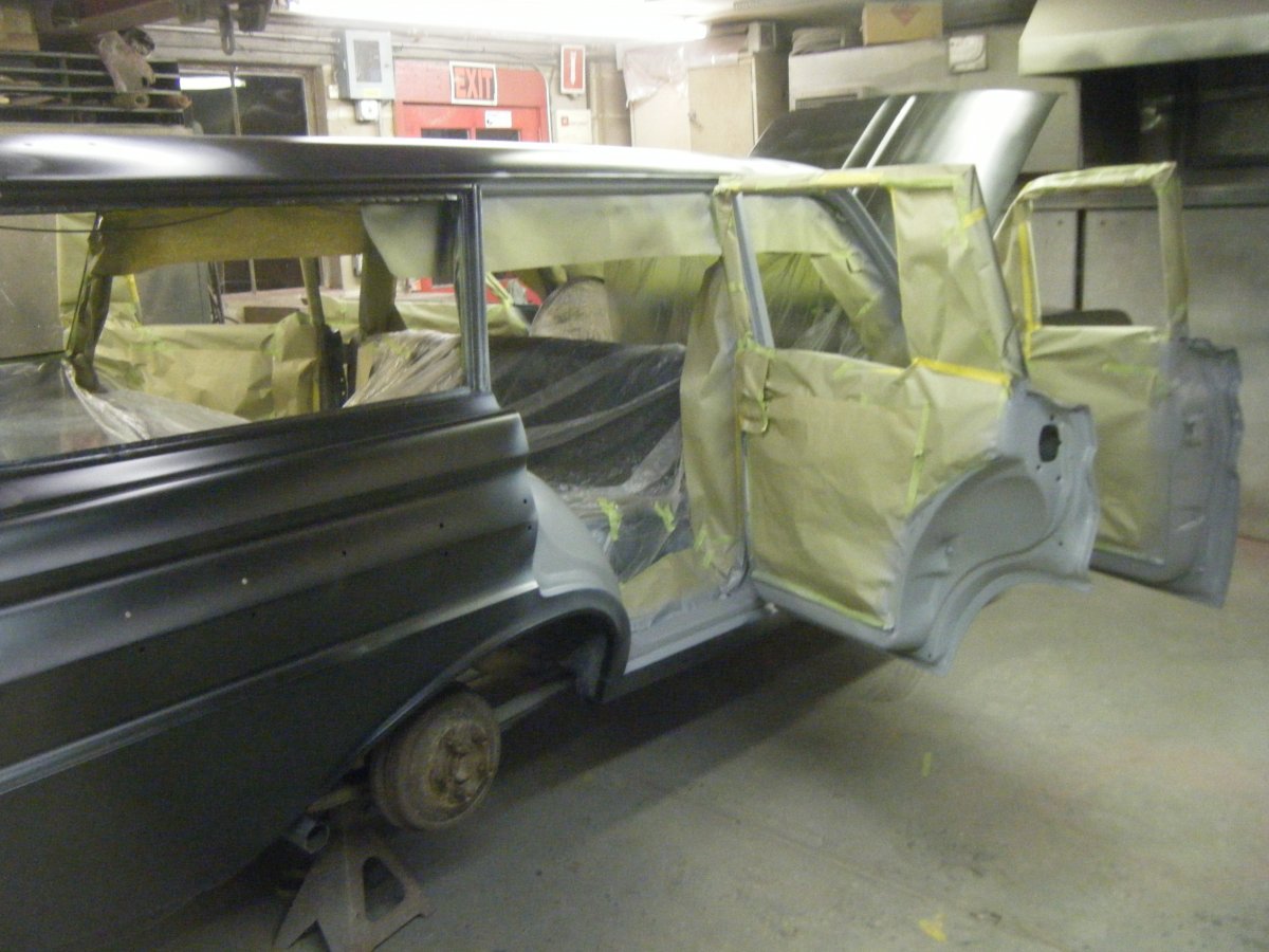

    priming door jambs. d****d plastic on the whole interior, this gave me access to the hinge side of the door. DSCF0002.JPG DSCF0004.JPG

    don't look REAL close at this one. customer was happy with the spray can job he did on them. i couldn't leave it that way. i would have loved to take the doooors off, blast them and the jambs and do it right but that doesn't fit the budget.
    i wrapped a 220 grit self stick D.A. paper around a paint stick for the hard to get areas. moving the stick with one hand and applying pressure and guidance with the other. cleaned up ok and will look good in white.;):cool:
    i will post final pictures

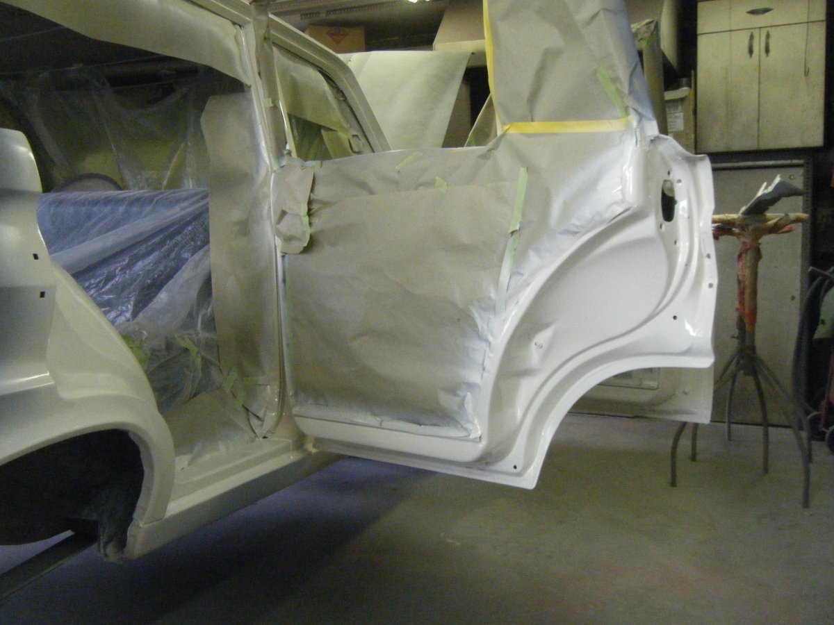

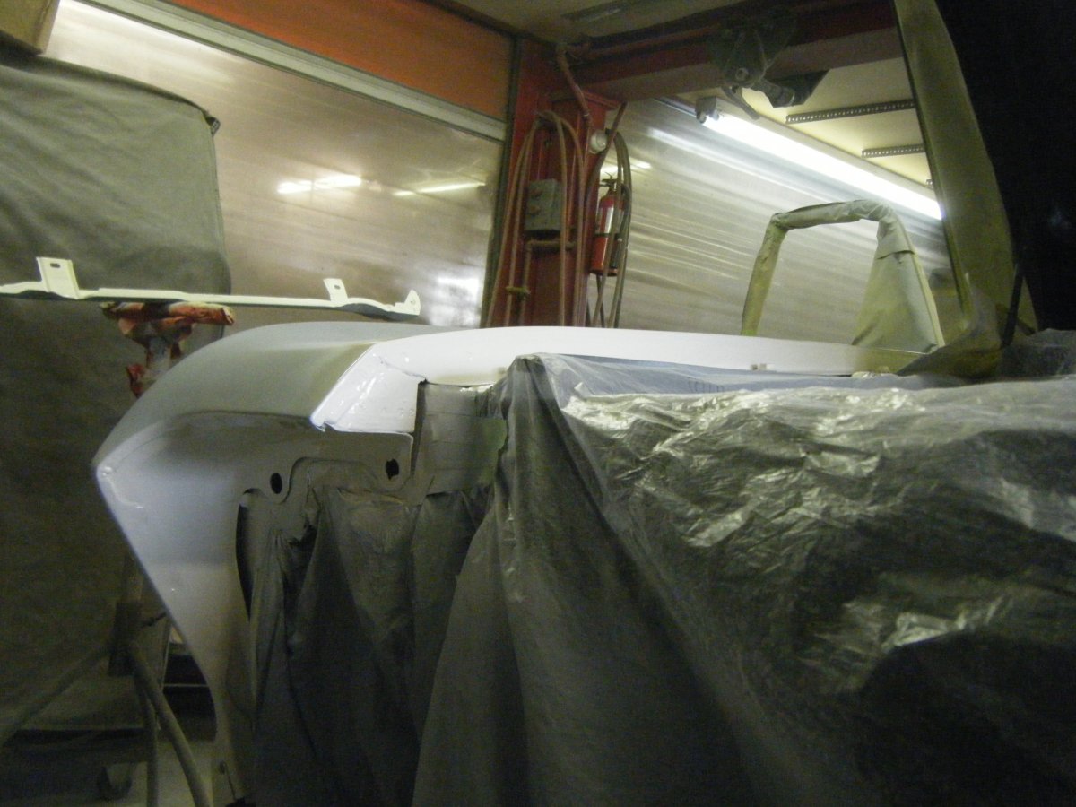

    and while i was at it, i did all the edges and hard to get areas. the inside of the rain gutter, the hood jamb, the bottoms edges of the car and the cowl vent. these areas are a pain to get covered when you do the out side of the car without risk of a run or hitting the exposed surfaces with the gun or hose. any runs will be sanded out when the primer gets sanded. DSCF0010.JPG
