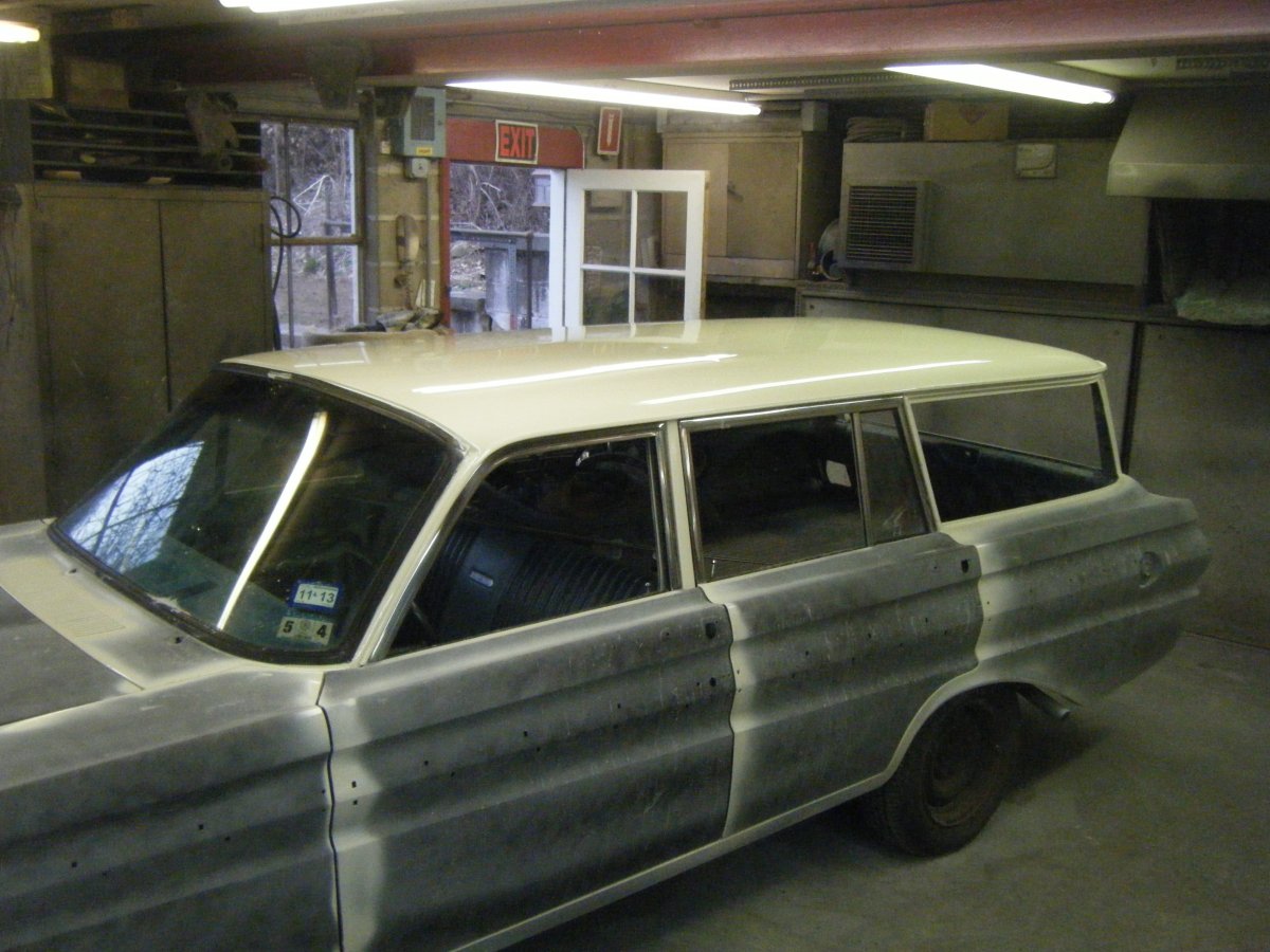

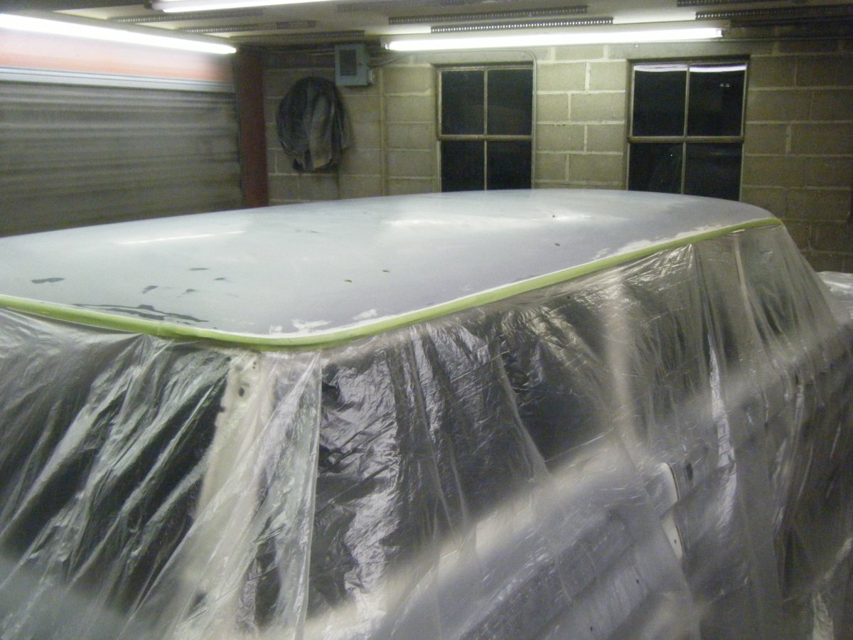

    because this car is so big and i would rather not get paint on my pants i decided to paint the roof first. sanded and taped off. DSCF0001.JPG DSCF0002.JPG

    i had to use a step stool and "kneel" on the edge of the car to get enough paint in the center. car is deceivingly big!

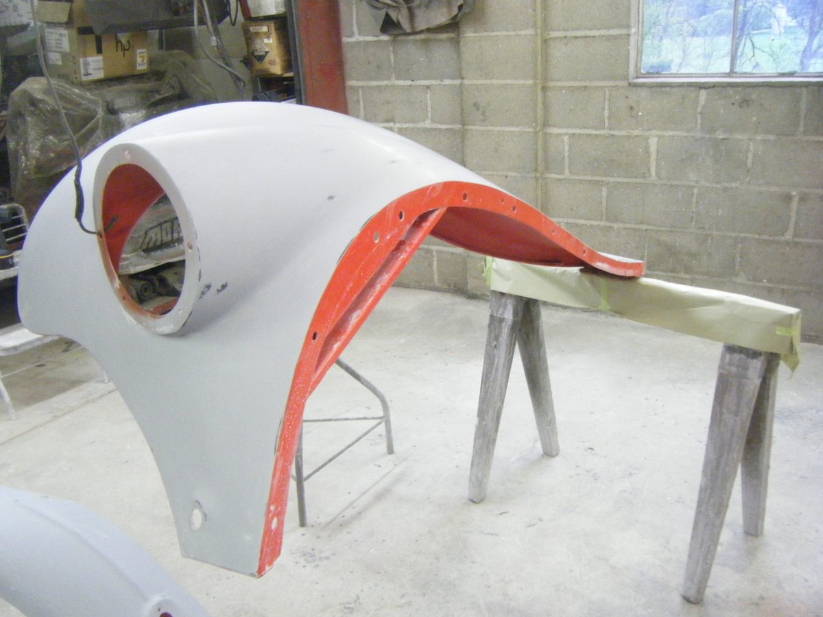

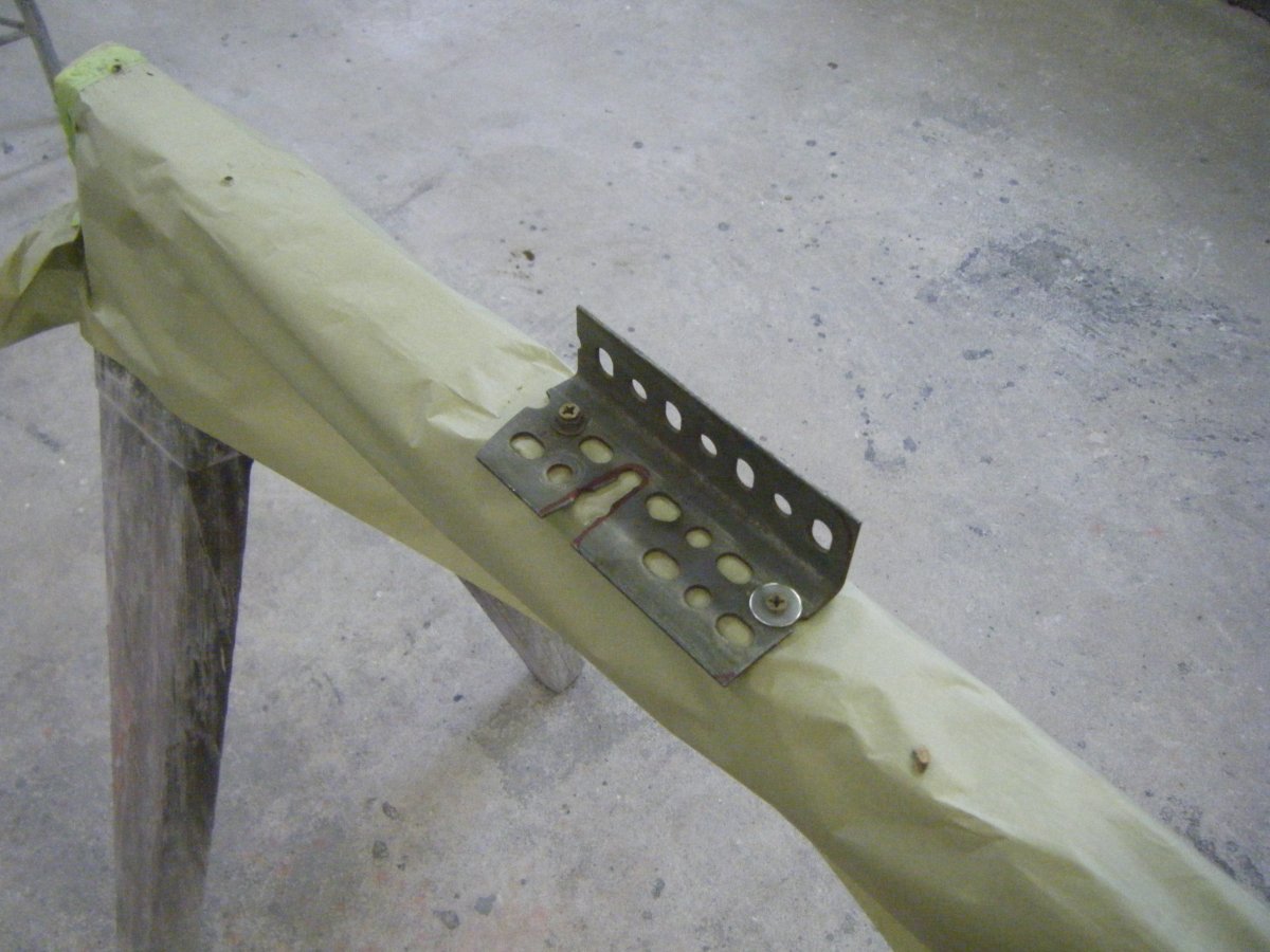

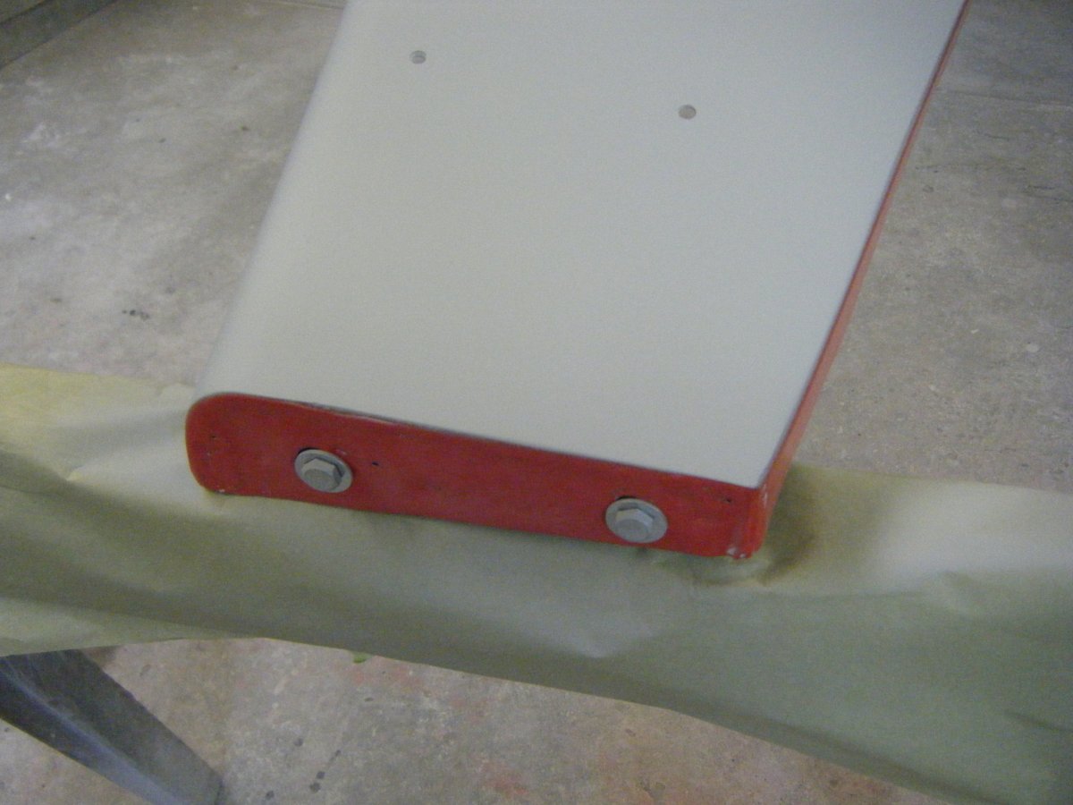

    DSCF0002.JPG screwed a strip of angle to the saw horse, then bolted the fender through the running board holes. then held up the front of the fender with a wire to a bracket in the ceiling. DSCF0001.JPG DSCF0002.JPG

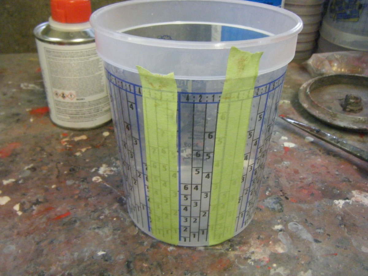

    DSCF0001.JPG before painting i put a couple strips of tape to isolate the mix ratio i am using. it keeps me from fumbling trying to find the proper scale after the first mix. a quick wipe on the inside, between the tape and i am ready to mix the next cup.
    vtx1800, Peter Nowak, reagen and 15 others like this.
  8. teach'm
    Joined: May 8, 2005
    Posts: 324
    teach'm
    from Tucson, AZ
    That is a damn good idea there! Work smarter, not harder.
    Bowtie Coupe and tb33anda3rd like this.
  9. tb33anda3rd
    Joined: Oct 8, 2010
    Posts: 17,584
    tb33anda3rd
    thanks. the older i get, the fuzzier thee numbers are..........

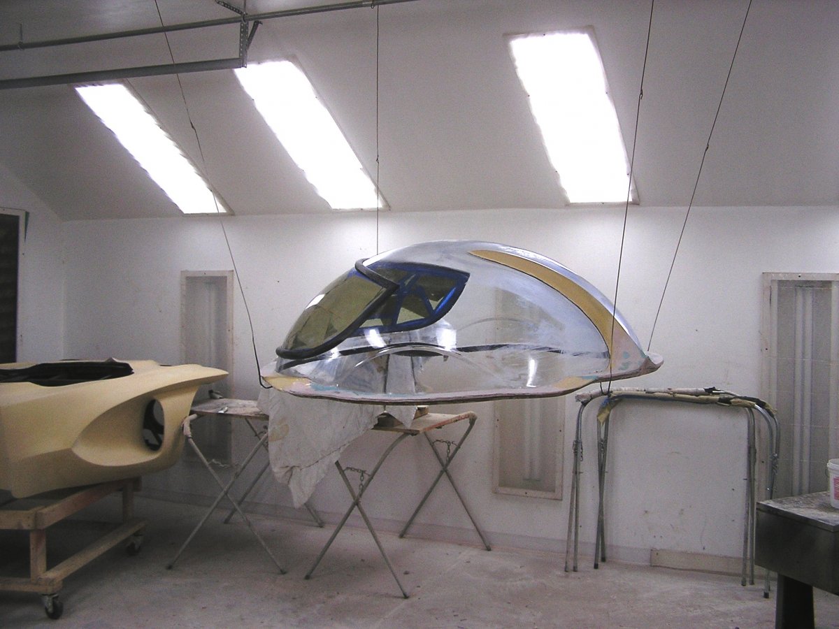

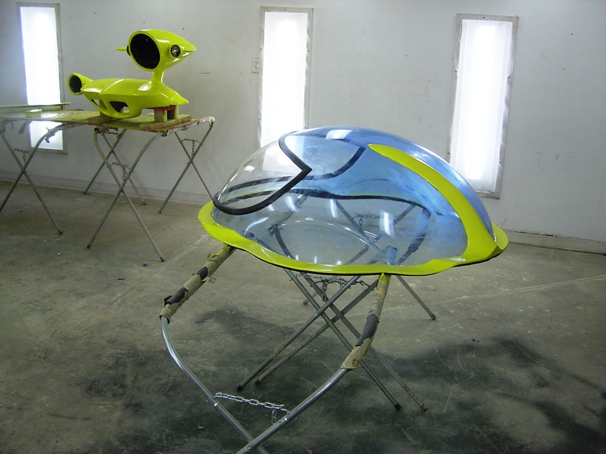

    Tinting the bubble top on my Mysterion clone. I hung it from my paint booth hanging rails and sprayed from underneath.
    I made a kart that I used to make the fibergl*** body pattern then cut it down to scoot the body around while finishing and painting.
    Most of the time I use Harbor Freight steel tubing 'saw horse' type parts holders and/or hang parts from two 1" conduit rails mounted to the ceiling of my paint booth using hanging wires made from welding rod that hook over the conduits. You can see one of the conduits in the Mysterion body picture above.

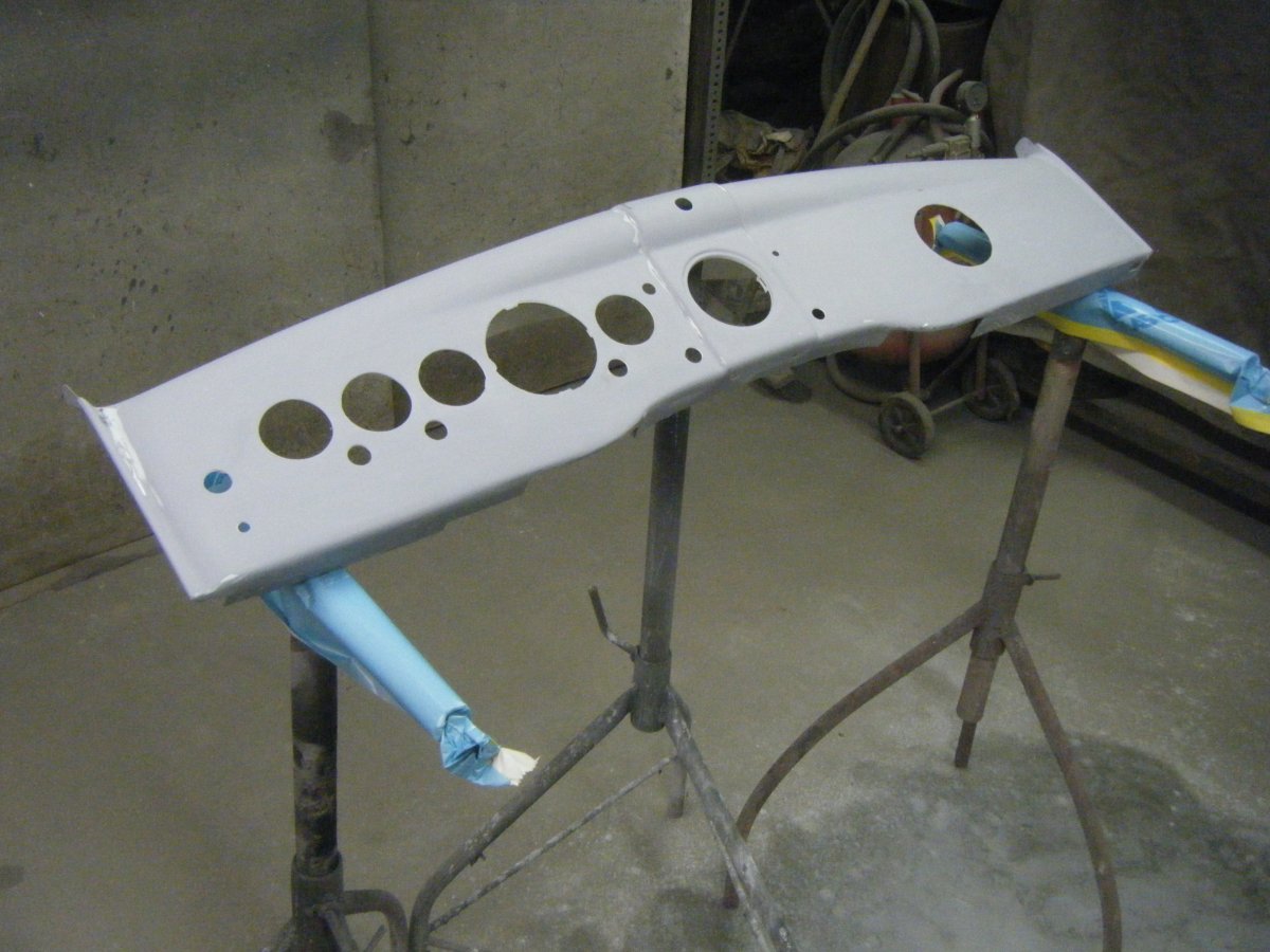

    primed a set of fenders for a rpu hot rod today. used a couple pieces of threaded rod, run through some angle iron that was hung by a hook from the ceiling. it was faster to use a couple hose clamps to keep the rods from sliding than to run nuts all the way to the center. the fenders are light enough that i was able to lift the angle iron to get the back end of the fenders. DSCF0001.JPG DSCF0002.JPG DSCF0003.JPG

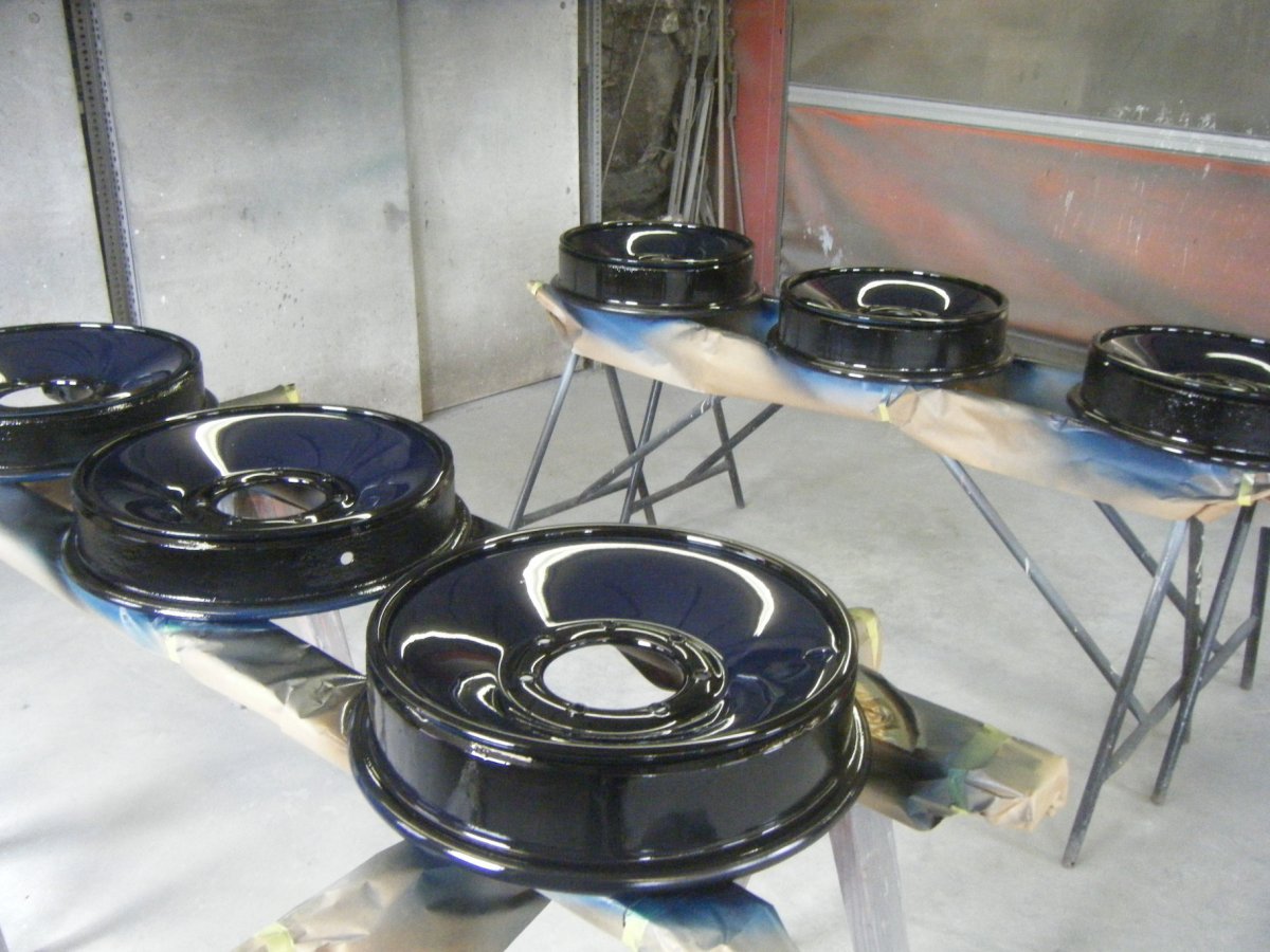

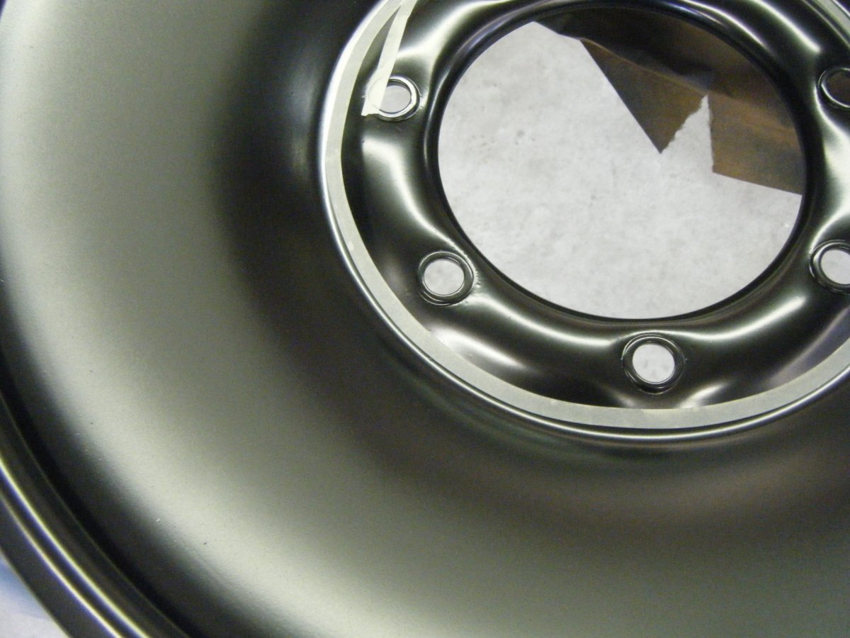

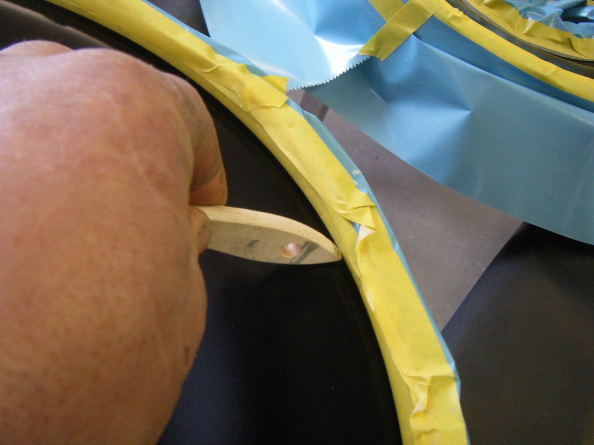

    taping some wheels for two tone. wheels were sealed with a black sealer, then i shot some black basecoat on the areas that will be black. then using a plastic fine line tape i taped off the edge i wanted to create. DSCF0001.JPG
    Bowtie Coupe likes this.
  23. tb33anda3rd
    Joined: Oct 8, 2010
    Posts: 17,584
    tb33anda3rd

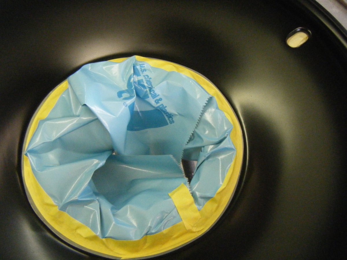

    and then some paper to seal out the rest of the area.
    for the out side edge i just used tape, holding it flat with the wheel so it will lay flat. i then pushed it under the edge with the pointed handle of a paint brush, then some paper to cover the out side. note i also taped off the valve stem hole to keep any paint off of the back side, which i already have painted. DSCF0002.JPG
  24. tb33anda3rd
    Joined: Oct 8, 2010
    Posts: 17,584
    tb33anda3rd
    once the blue was painted on "the field" i untaped it and clear coated. DSCF0005.JPG

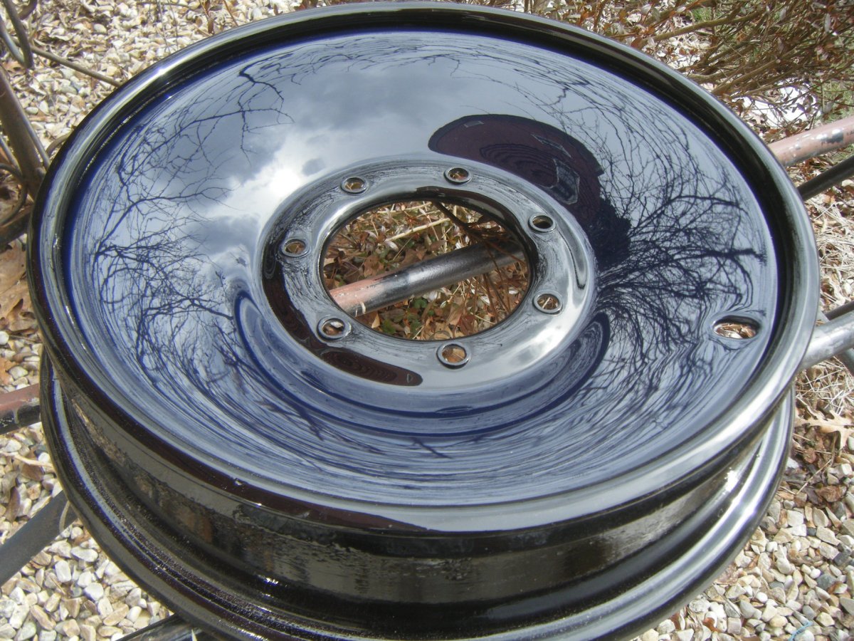

    first time i have ever sanded and buffed a set of wheels. posting this because i like the crazy reflection. DSCF0004.JPG

    ^^^^^^^^^^^^^^^^ REALLY NICE! I can see them getting a wide pinstripe about 3/8 wide with a contrasting stripe on either side normal size. Bob
  29. jakesbackyard
    Joined: Feb 13, 2007
    Posts: 949
    jakesbackyard
    from ND
    The wheels look great! What are they for? I’ve never seen wheels with 7 lugs.
  30. nunattax
    Joined: Jan 10, 2011
    Posts: 3,389
    nunattax
    me neither
