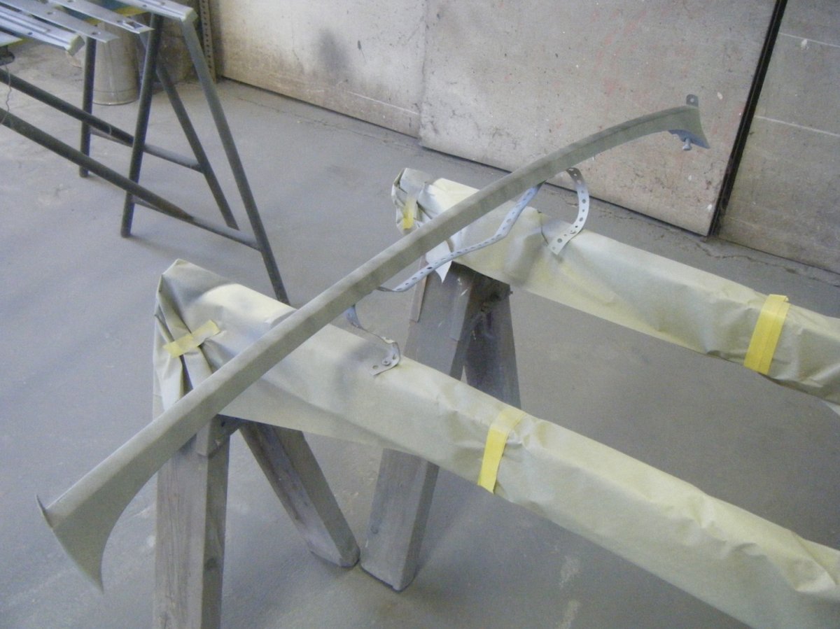

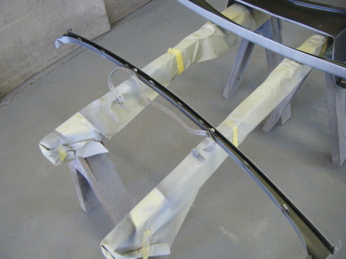

    used some plumbers strap, bolted to the part and screwed to the saw horse. it was strong enough to hold it rigid yet once it was filler primed on the face side, i could twist it over so i could paint the back side. DSCF0004 2.JPG DSCF0005 2.JPG

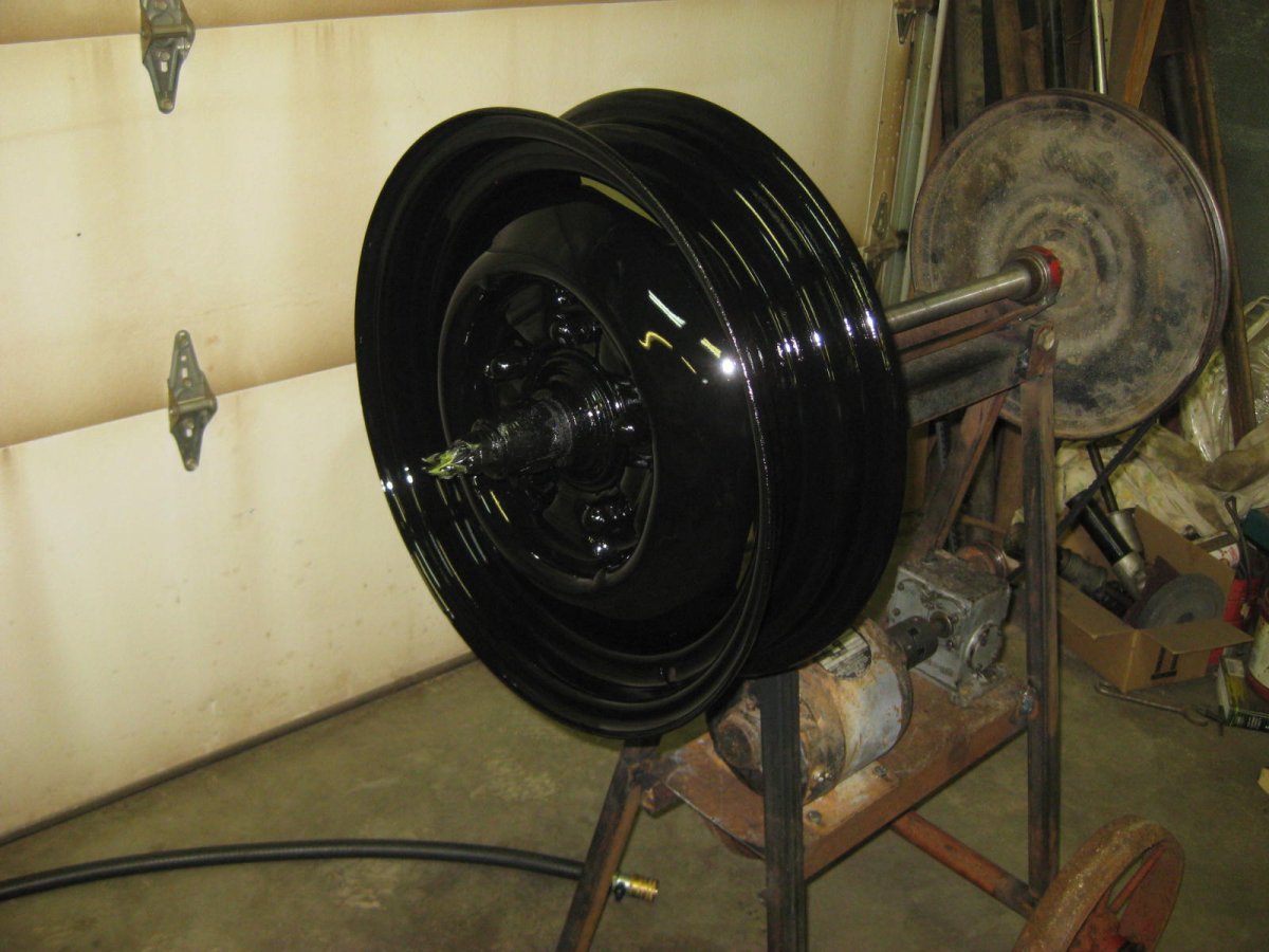

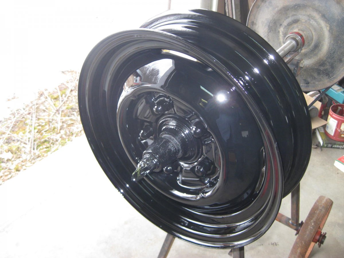

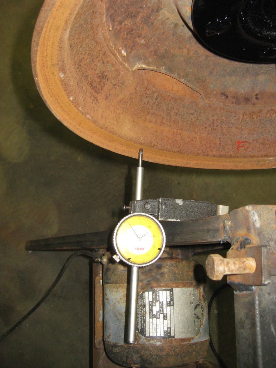

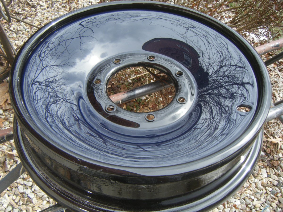

    my rig for painting wheels. mostly made fore wire wheels, they are a ***** to paint. this rig runs at 5 rpm. you can thin the paint all you want so it melts into the bottom coat, and will never run, no dry spots, no orange peel, no skill required for a perfect job every time. bad news is its one at a time. good news is it also can be used to check the wheel for true. pull a pin, lift up the arbor and easily take off the belt and spin it by hand to watch it wobble! i have also used it for other small parts, really anything you want to spend time to mount it will come out perfect with no skill IMG_1217.JPG IMG_1218.JPG IMG_1219.JPG IMG_1221.jpg IMG_1220.JPG

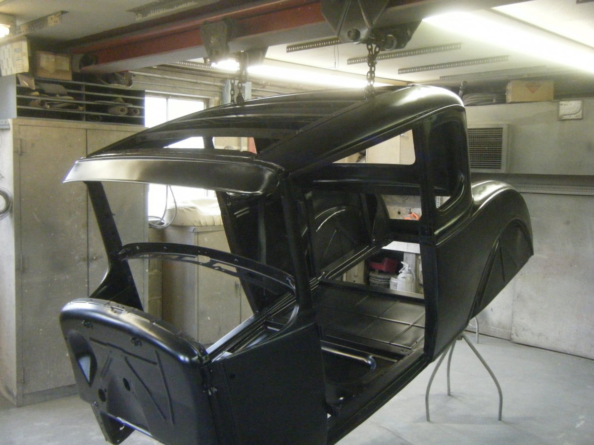

    to prime an A coupe i cut a piece of uni-strut to fit under the top boards, then bolted a couple eye bolts to the strut and hooked a chain to the trolleys . it was balanced so i could tilt it to prime the under side. DSCF0004.JPG

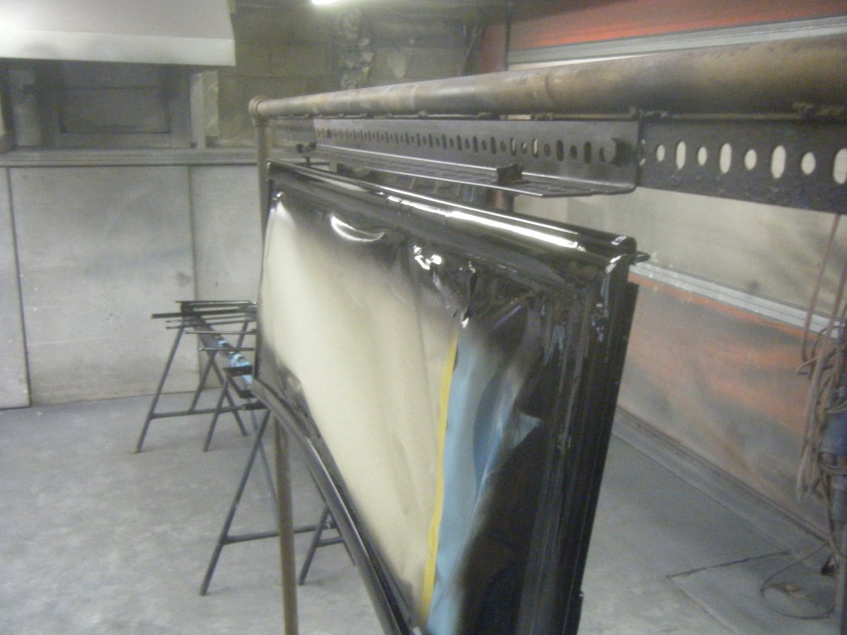

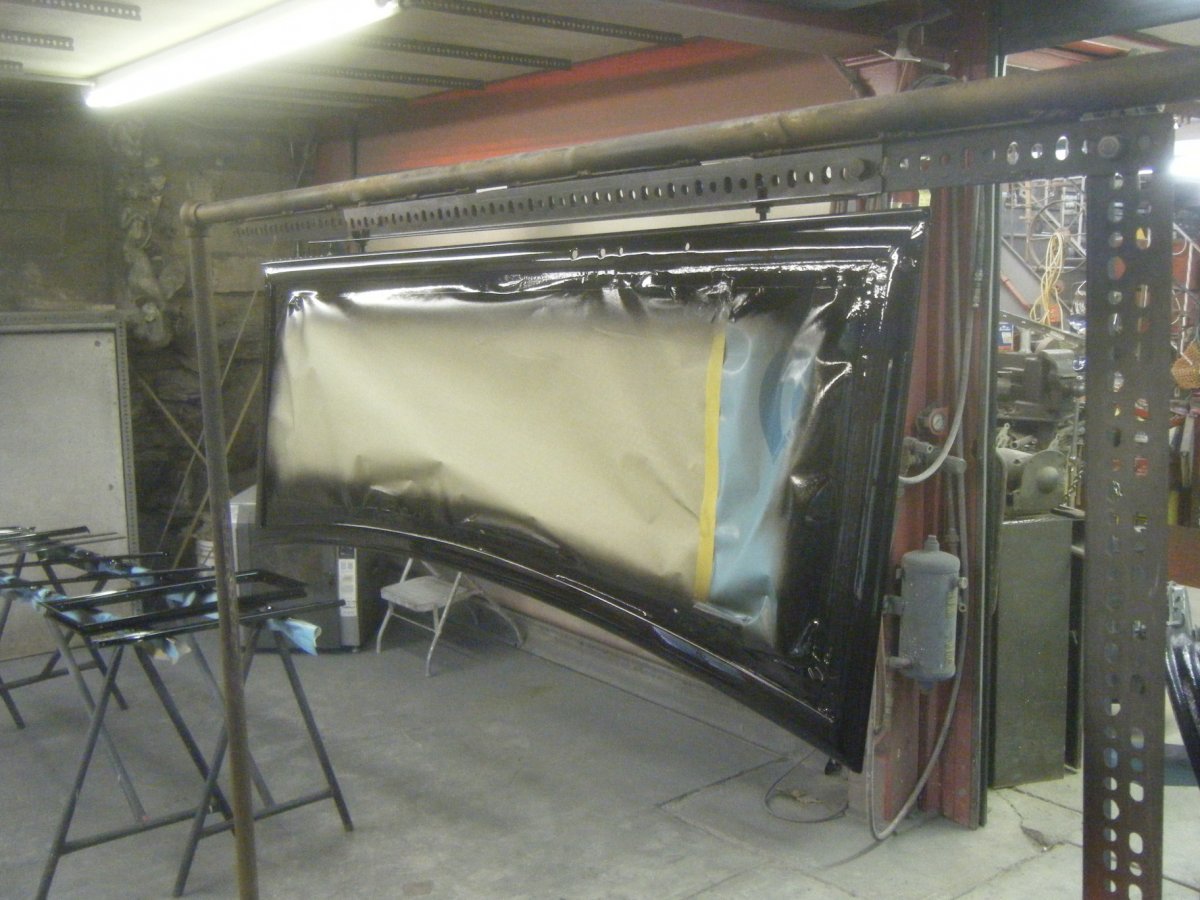

    i had painted all the edges of the windshield frame after i had primed it. i then ***embled the gl*** and the upper hinge, trimmed the bedding tape. i then wet sanded it smooth and once dried i taped off the gl***. i bolted the hinge to my paint rack in the position it sits on the car. i was able to "open" the window to get a final coat on hinge area. after the paint dries and before removing it from the rack i will install the outer seal.
    no chance of scratching the paint when installing the gl*** if the paint is still in the can................;) DSCF0005.JPG DSCF0004.JPG

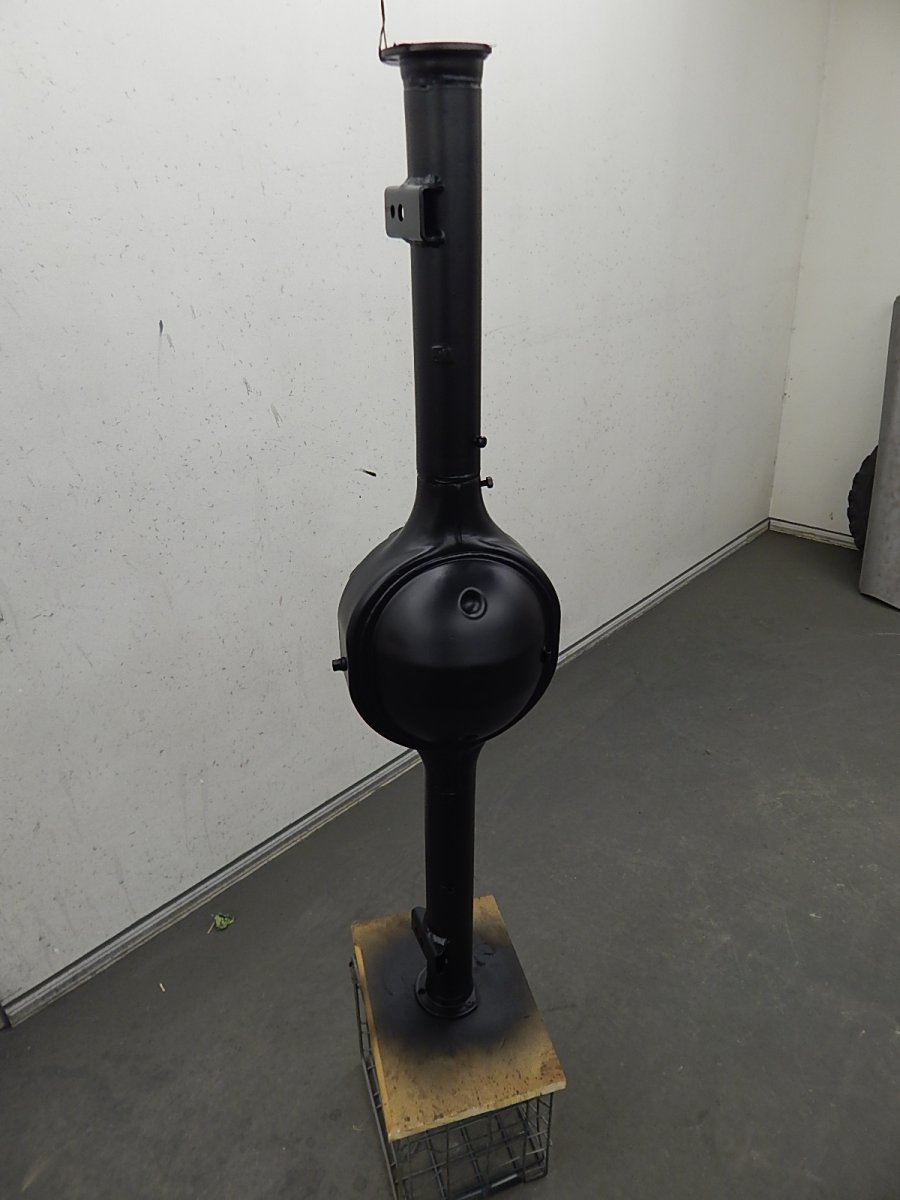

    I stood my 9" housing on end and screwed it to a large square board. A single wire to the ceiling helps steady it.

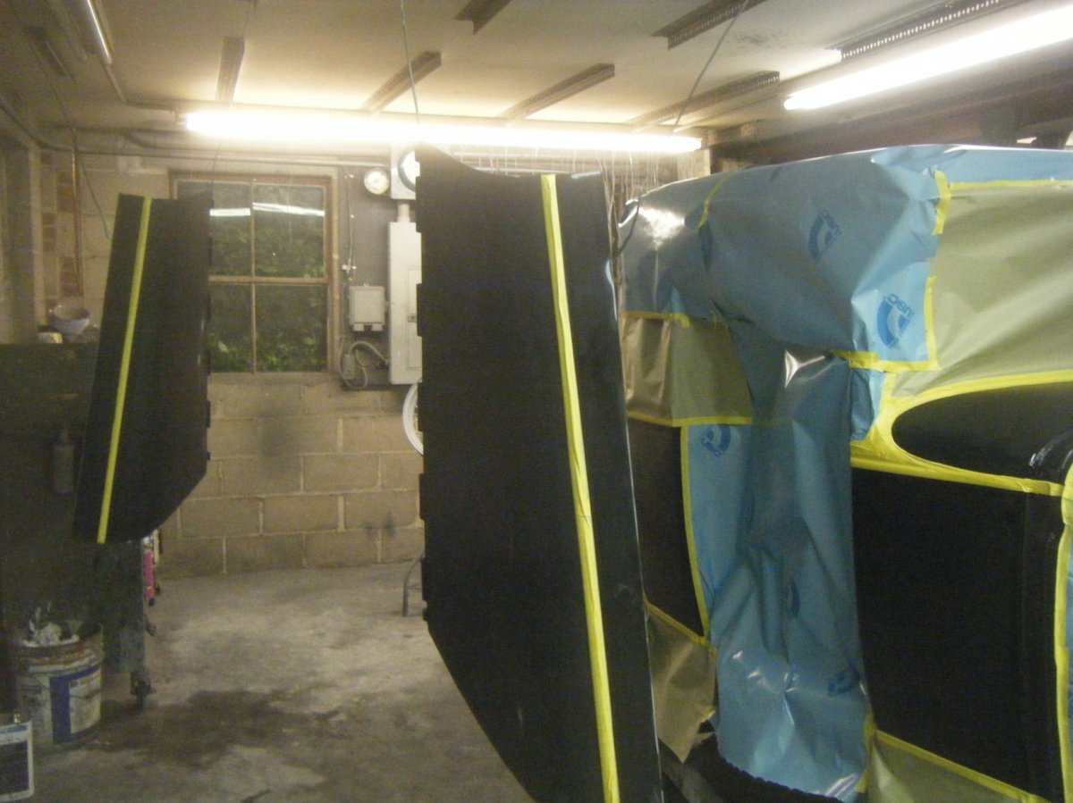

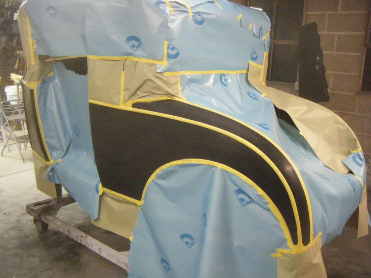

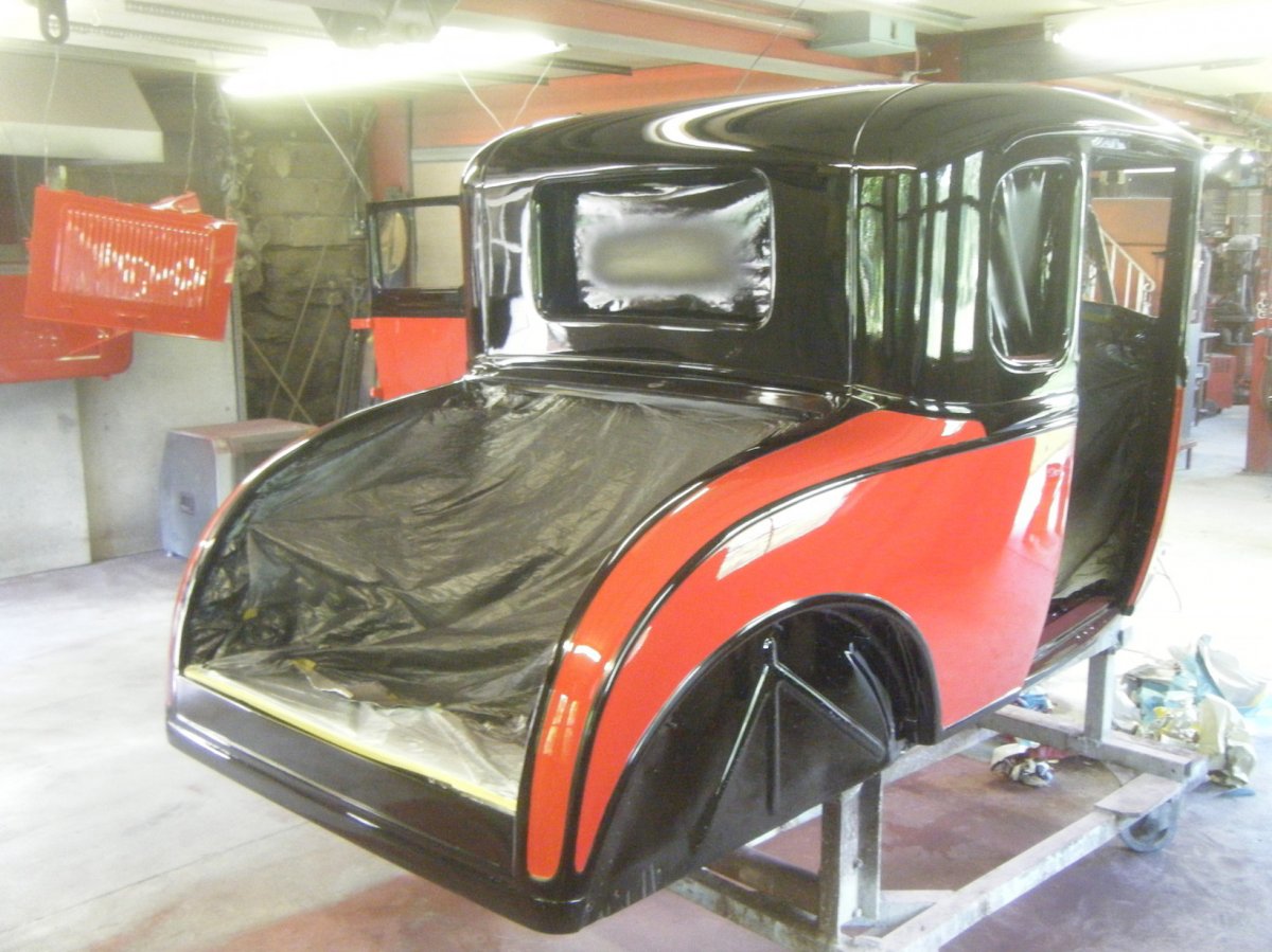

    painting two colors. first, prep for paint, i decided to paint the whole thing black first. DSCF0008 2.JPG DSCF0001 2.JPG
    i taped off all the holes and covered the inside to keep any dust/dirt/sand still stuck in the nooks and crannies from getting in the out side paint.
    MP&C, brad2v, nunattax and 2 others like this.

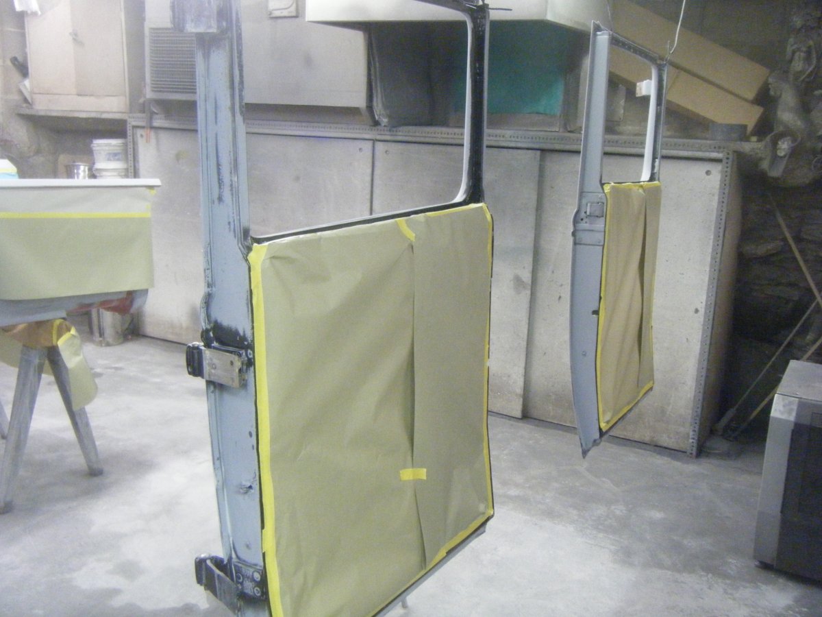

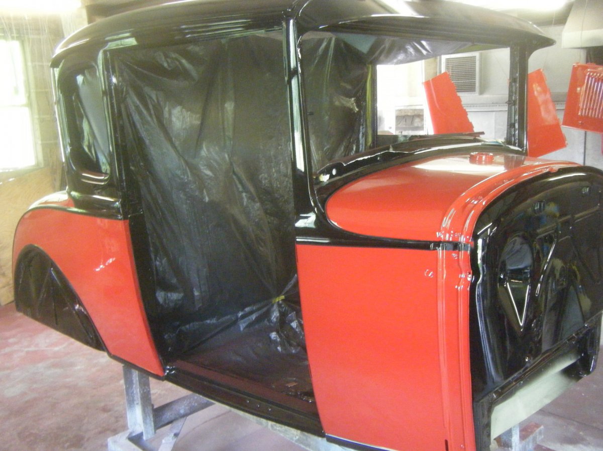

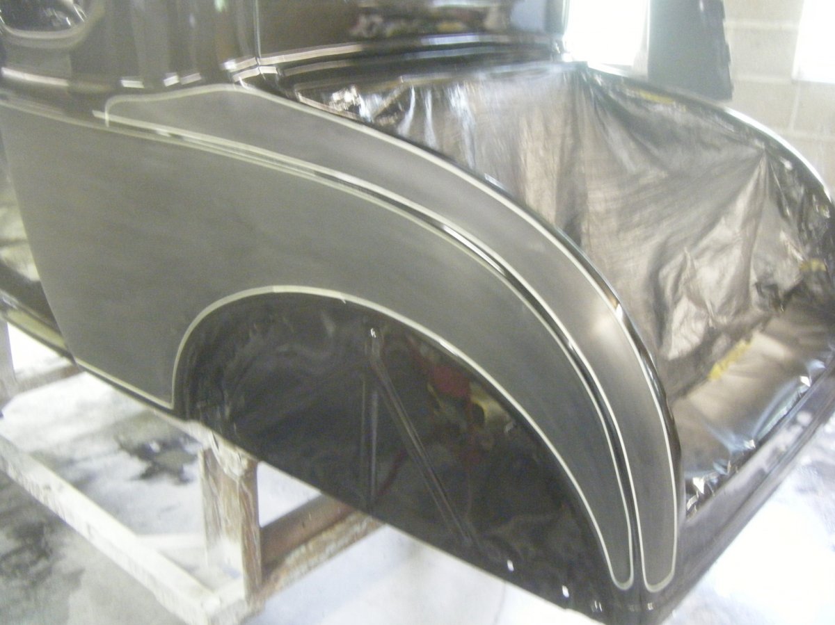

    the next day i sanded the areas that were to get the other color. i then cleaned it and used a plastic "fine line" tape on all the edges to be taped off. then i papered and taped all the parts that were to remain black. DSCF0001.JPG

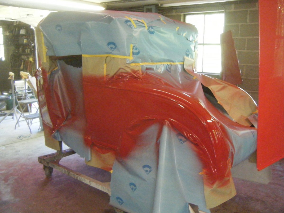

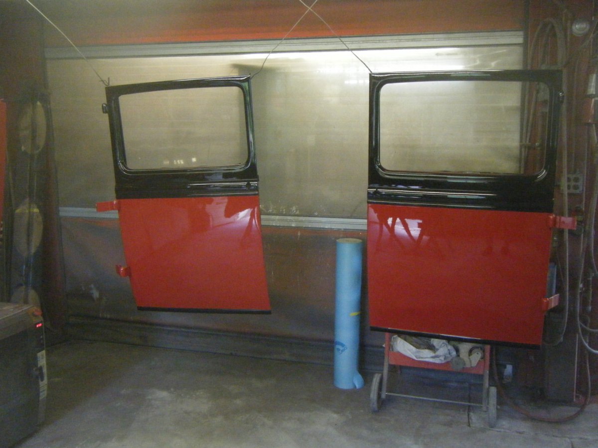

    MP&C and Bowtie Coupe like this.

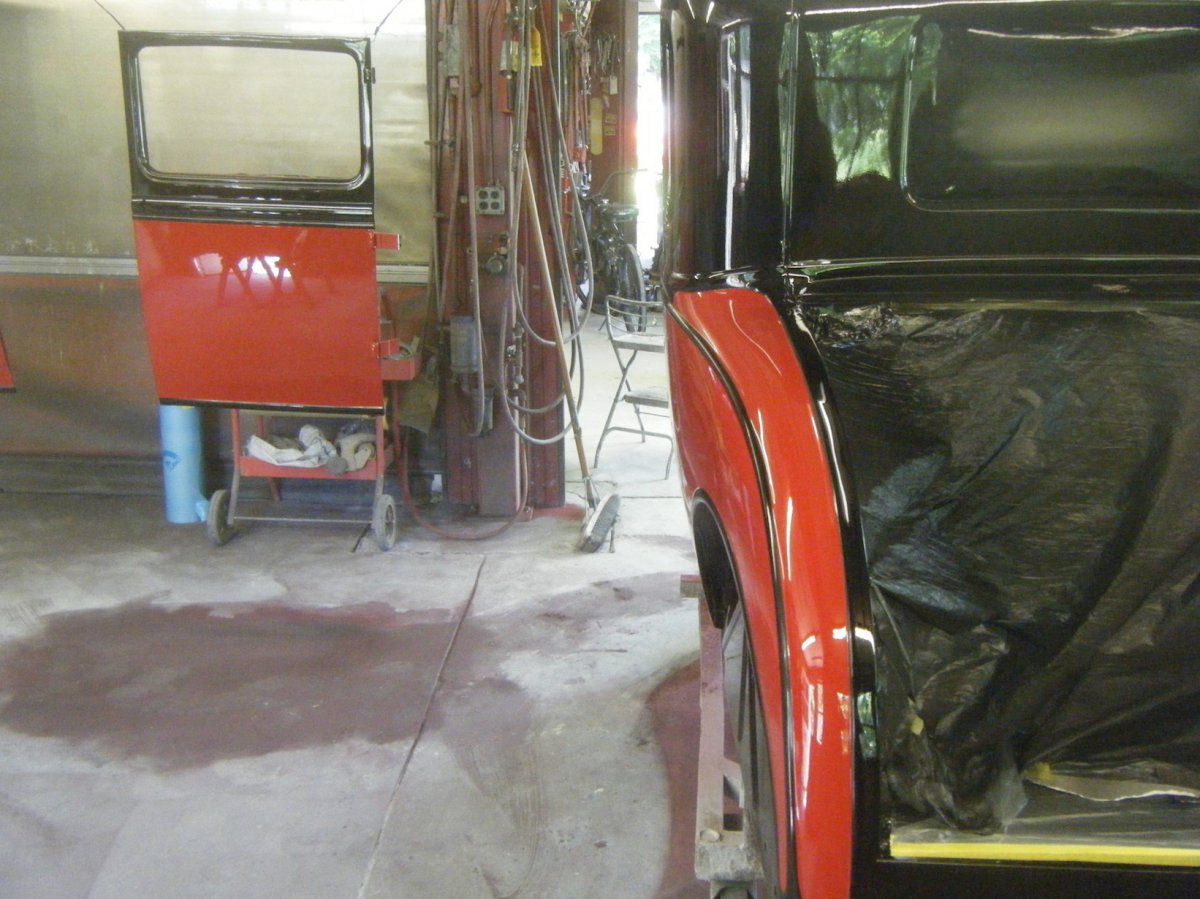

  24. tb33anda3rd
    Joined: Oct 8, 2010
    Posts: 17,584
    tb33anda3rd
    untaped after lunch.

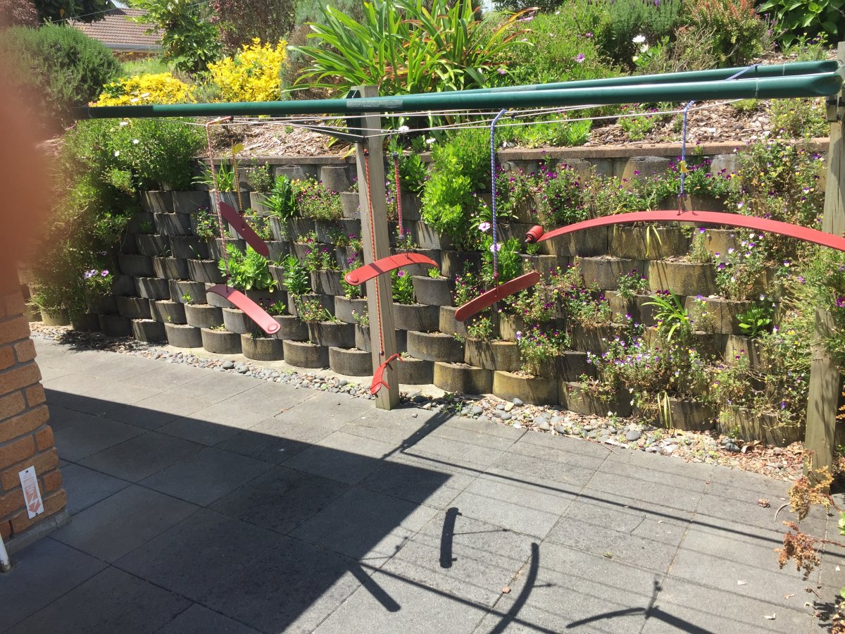

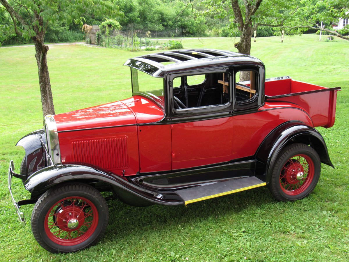

    Bungee cords hanging from washing line,
    - no decent trees around .......
    ( refer post 71 )
