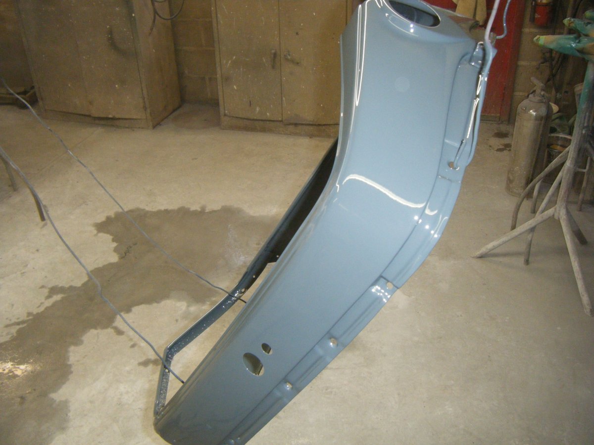

  4. tb33anda3rd
    Joined: Oct 8, 2010
    Posts: 17,585
    tb33anda3rd
    i am not sure, it came with those tires and wheels, i had to match the color of the car to the powder coated wheels. problem i had/have is the paint changes tone/shade with the light. looks way off under fluorescent light, perfect match in bright sun. lighting doesn't effect the color of the powder coat.

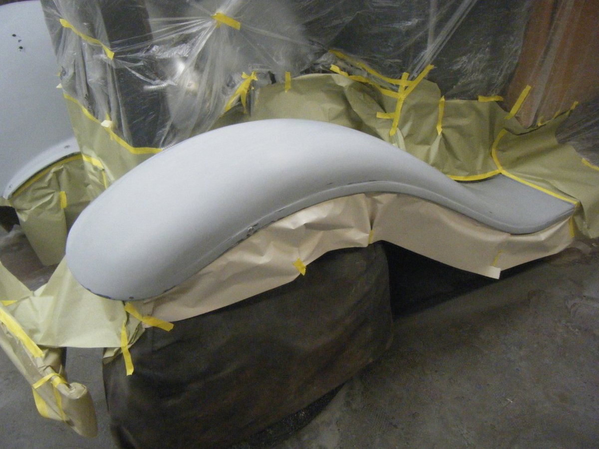

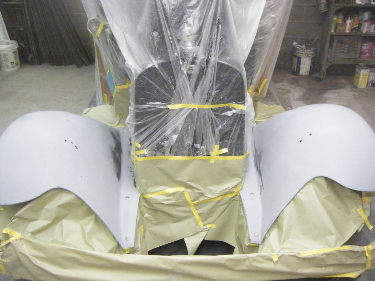

  7. tb33anda3rd
    Joined: Oct 8, 2010
    Posts: 17,585
    tb33anda3rd

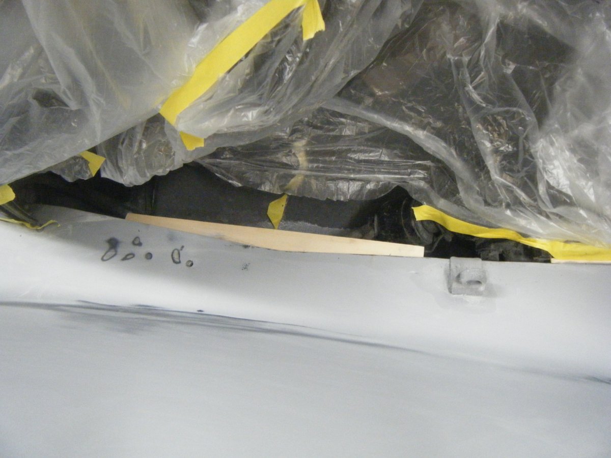

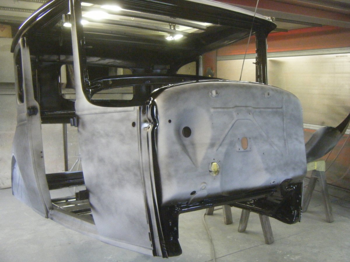

    had to give a quick paint job on a set of model A front fenders. to tape off the inside edge i jammed a couple paint sticks between the fender and frame, leaving an edge of the stick to tape to. DSCF0001.JPG DSCF0003.JPG DSCF0004.JPG DSCF0005.JPG

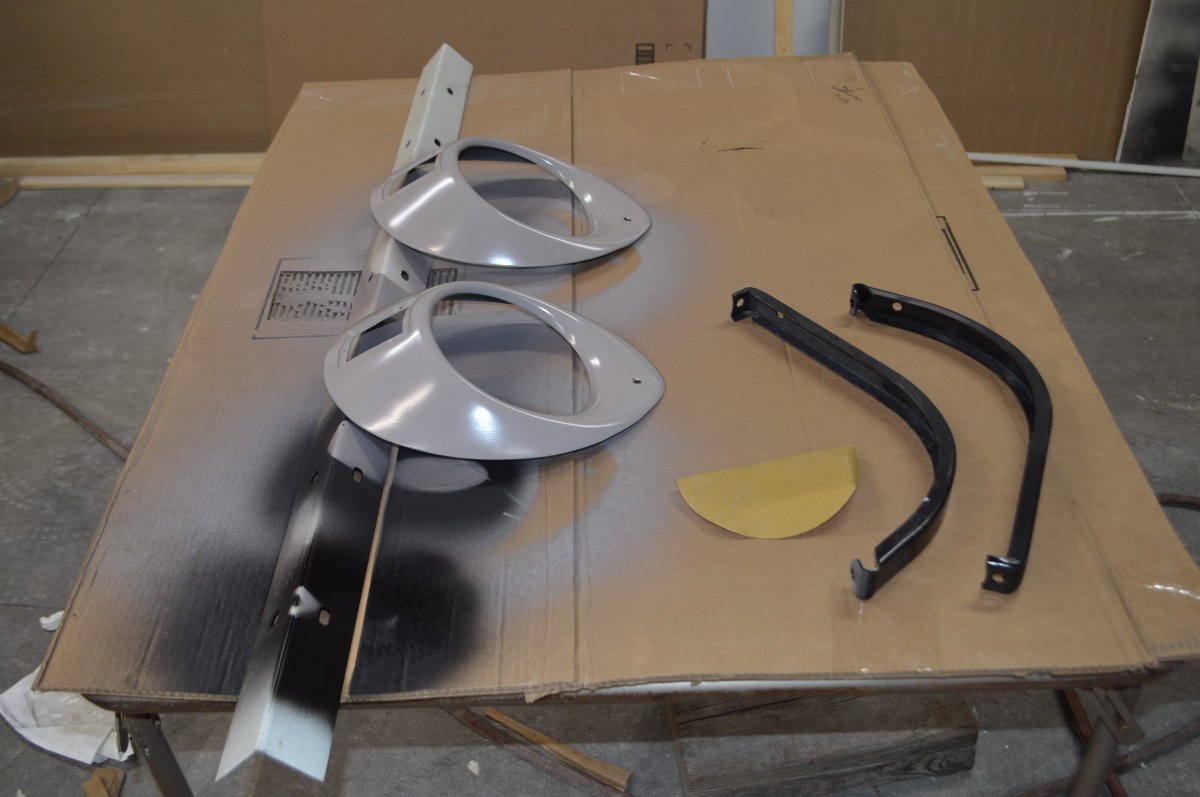

    image.jpeg I like to hang small light parts on cut up hangers and hold them while spraying them, moving them around to get coverage then hang them out of the way to dry. The headlight doors I was priming and I set the middle on a piece of angle iron and I have a ball of tape under the lower tip so the edge of the piece doesn't sit flush on the paper and stick making the edge a pain to deal with

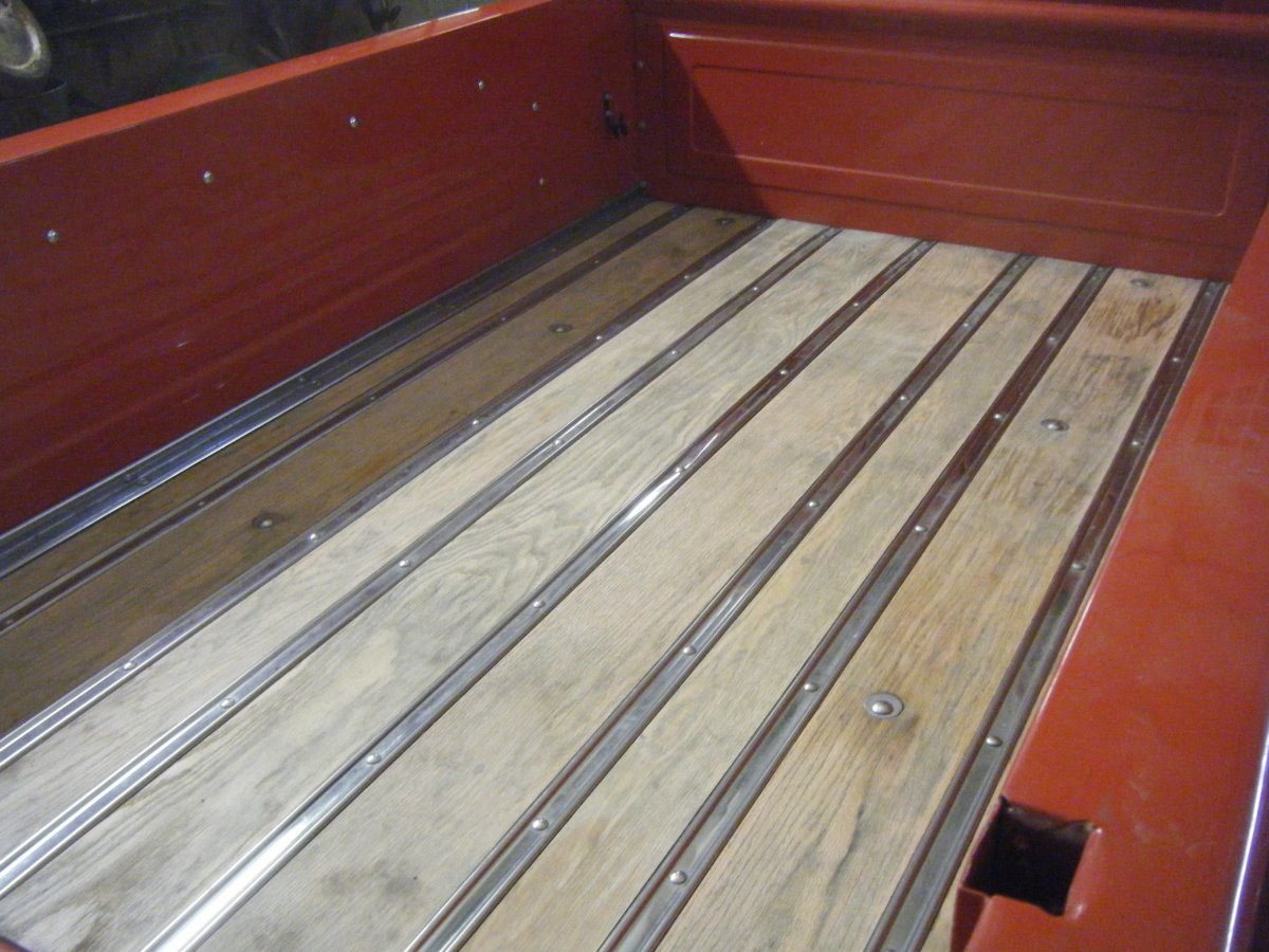

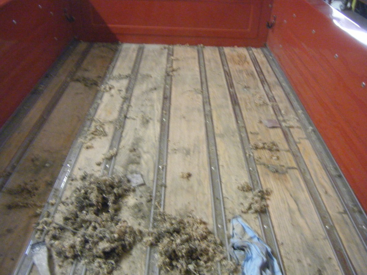

  11. tb33anda3rd
    Joined: Oct 8, 2010
    Posts: 17,585
    tb33anda3rd

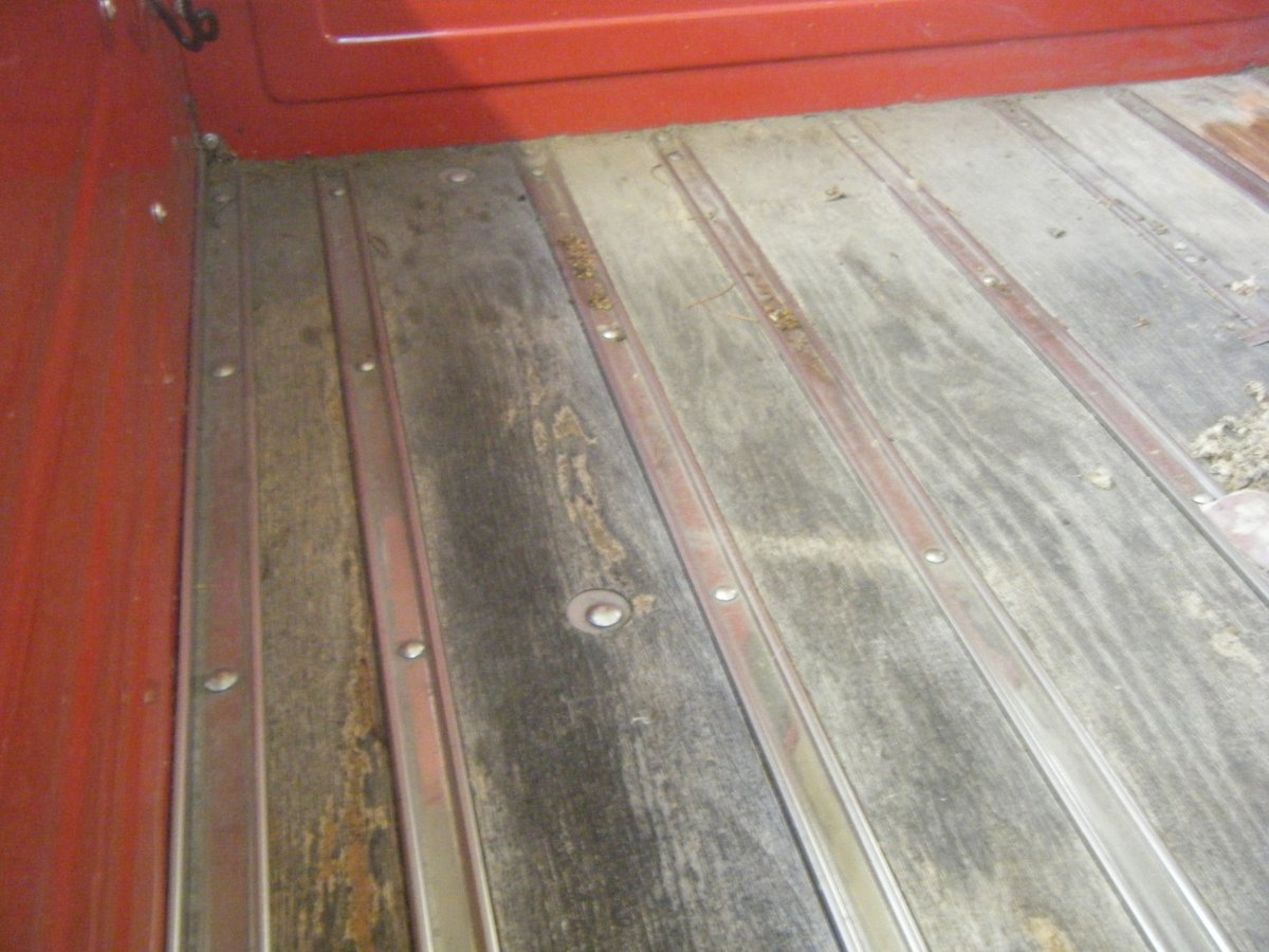

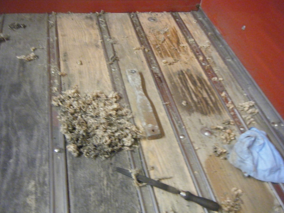

    this pickup bed wood was never treated correctly and sat out in the elements for a year. finished wore right off and the wood started to rot. i started by using a s****er to take off what was left of the clear and the "soft" rotted wood. i kept the s****er sharp and was able to strip off a top layer. DSCF0006.JPG DSCF0009.JPG DSCF0010.JPG

  12. tb33anda3rd
    Joined: Oct 8, 2010
    Posts: 17,585
    tb33anda3rd
    i then let it sit in the shop at night and out in the sun during the day to dry out the wood for a week, then sanded it down with 220 grit. DSCF0011.JPG

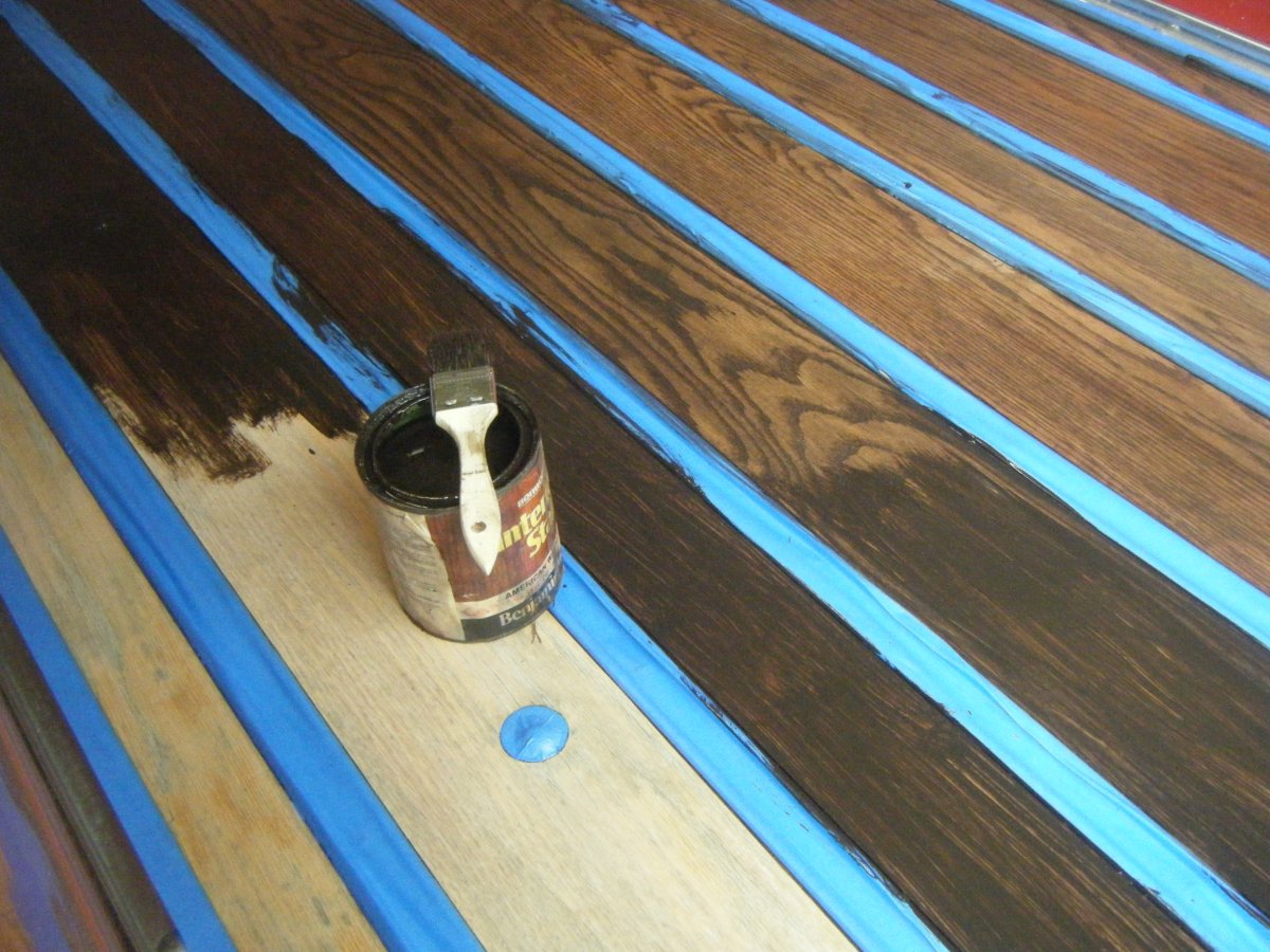

  15. tb33anda3rd
    Joined: Oct 8, 2010
    Posts: 17,585
    tb33anda3rd

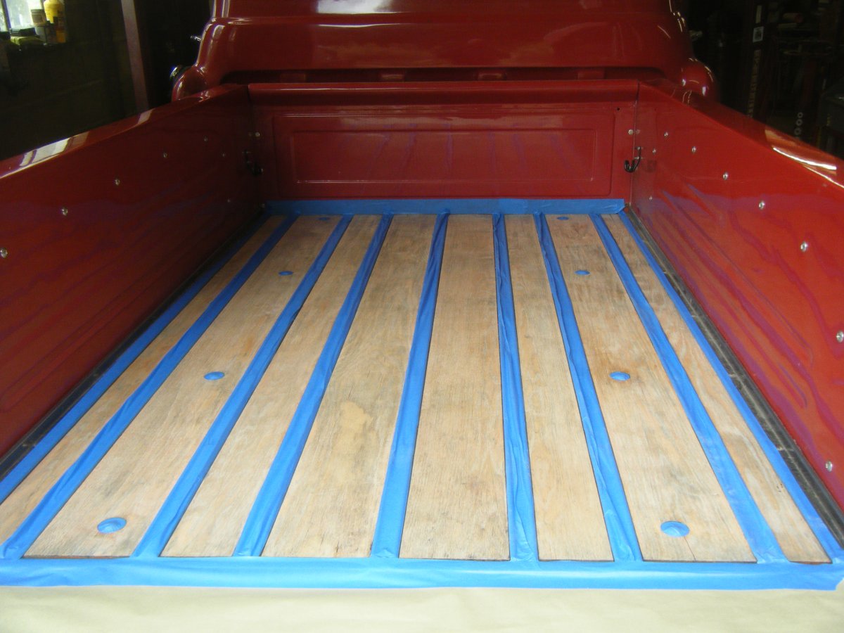

    i blew off the bed, gave it a good vacuum, then taped it off. i brushed the stain on , then buffed it even with a rag. DSCF0003.JPG DSCF0004 2.JPG DSCF0005 2.JPG DSCF0006.JPG

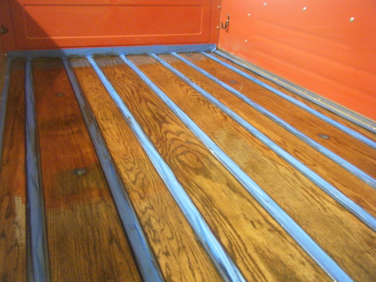

    i let the stain dry for 24 hrs and today i tacked it off and brushed a coat of spar varnish on it. i will put a few coats of varnish and smooth with steel wool between coats. DSCF0004.JPG

    don't forget to seal the underside and the edges/endgrain
  20. tb33anda3rd
    Joined: Oct 8, 2010
    Posts: 17,585
    tb33anda3rd
    yeah. the right way would have been to take it all out and reseal all sides. the bottom still looks good, the hidden edges, i am not sure. i just needed to make it look better and slow the decay. i was not sure i should post this, but it does show a way to improve the looks.

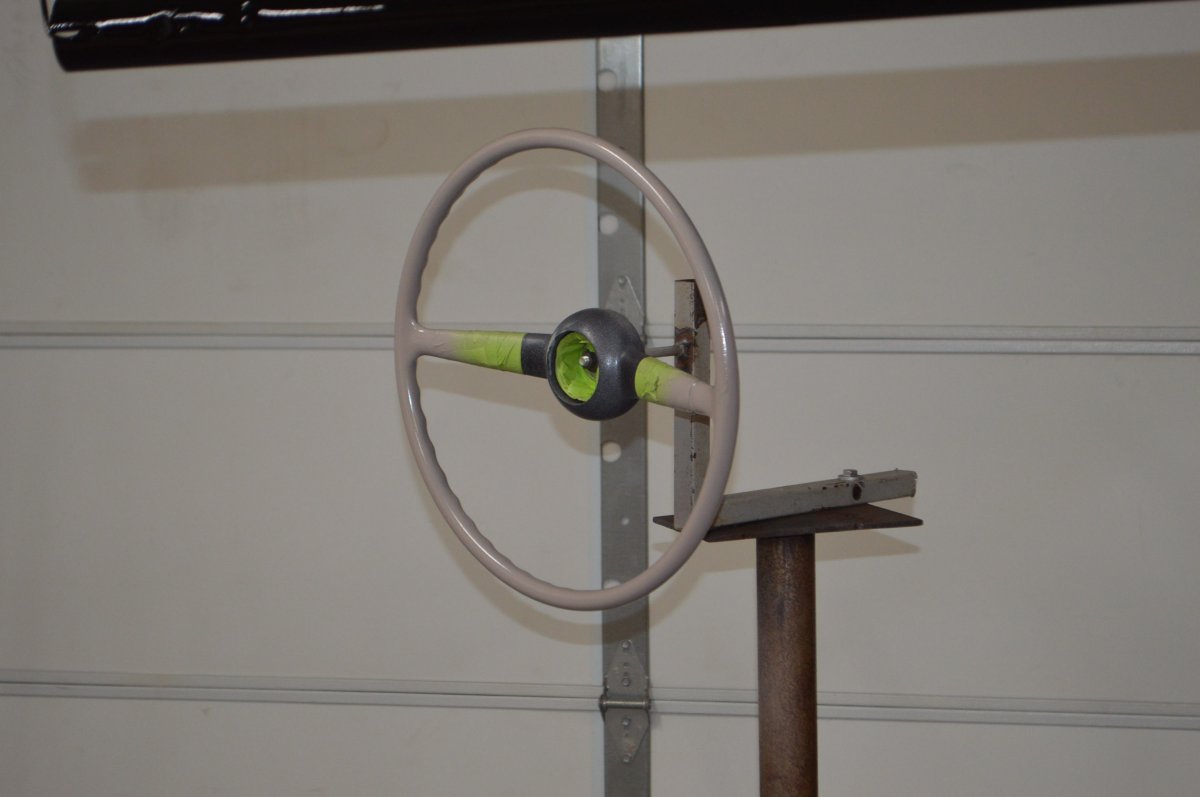

  22. 100_9208.JPG Big old jack stands fit the headlight buckets and make it easy to paint, made some steel saw horses and bent some flat stock to hold both doors straight up to paint all areas. made a wood cart for 100_9217.JPG bed4c.jpg 100_8608 (2).jpg the body and bed..then recycle the wood or use it in the fire pit...

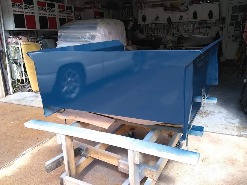

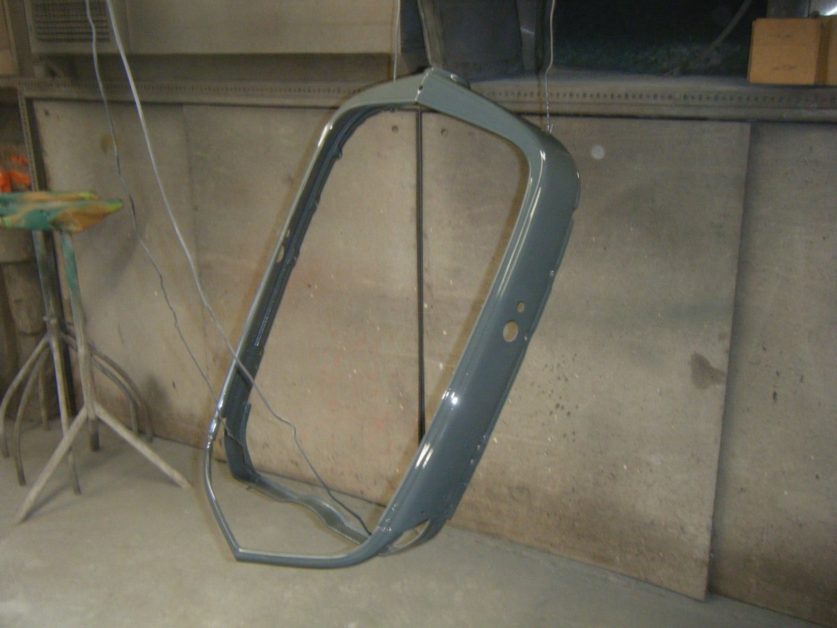

    radiator shell hung by 4 wires so i could paint all sides. this is the new jeep color "anvil". DSCF0001.JPG DSCF0002.JPG

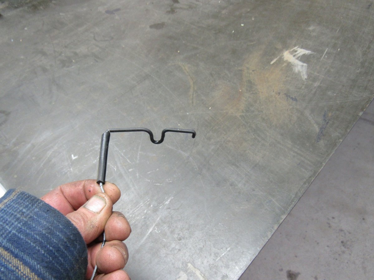

    i needed to paint this little choke rod. i slipped the end that goes into the choke spring, into a piece of small vacuum hose then put a piece of wire into the other end of the hose. i could now turn it so i could paint all sides . IMG_4152.JPG
