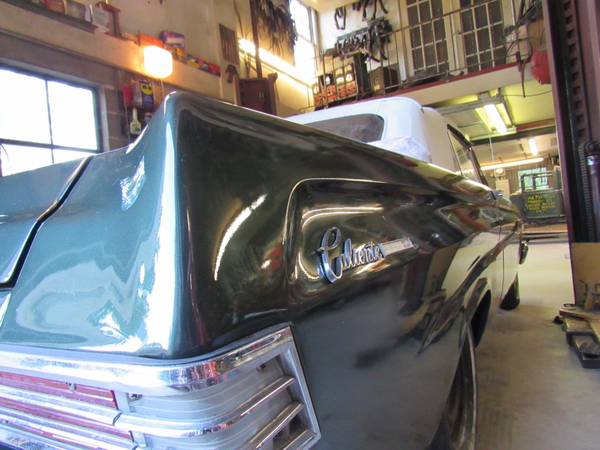

    Thanks Tom, actually, it is a big improvement but the top has a couple ragged edges and abrasions that the dye was not going to hide. the job was to turn a 50/50 car into a 20/20, good at twenty feet or twenty miles per hour.
    this dye was a water borne product and sprayed really well. I sprayed a light coat of water first and let it dry well between coats. it took three coats to hide the black spots.
    I would not hesitate to use it again.

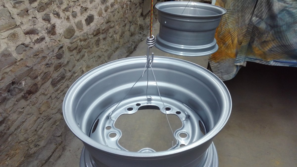

    Another"Spin" on painting wheels.. bungee cord from ceiling an cut wood triangles with drywall screws... Lite spin, Works excellent... As a side note, if you're doing deep dish it won't work, this was plan B KIMG1983.JPG KIMG1982.JPG KIMG4071.JPG

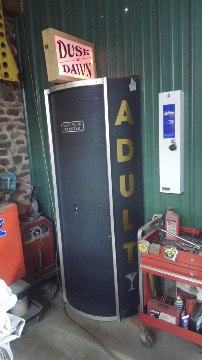

    It was a cold storage building erected in 1881, The first floor is 30" below ground level... There's pic's in my album... Roofed it an Built the Coppola over twenty years ago..

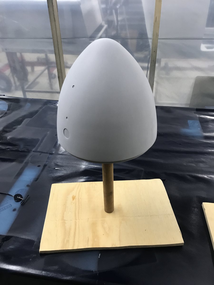

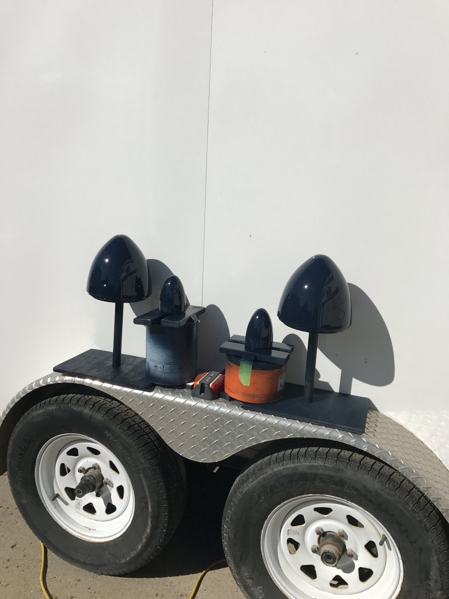

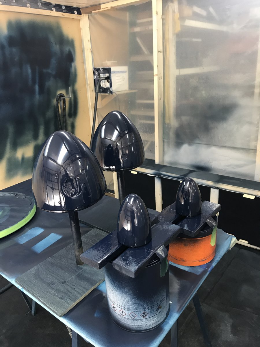

    For painting my headlight and tail light housings for my RPU I made up some stands to hold them and then I needed something to spin them.
    A turntable from the kitchen supply store and I was good to go.

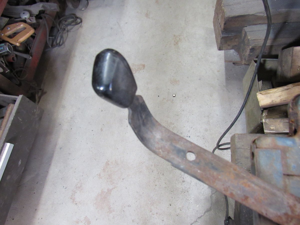

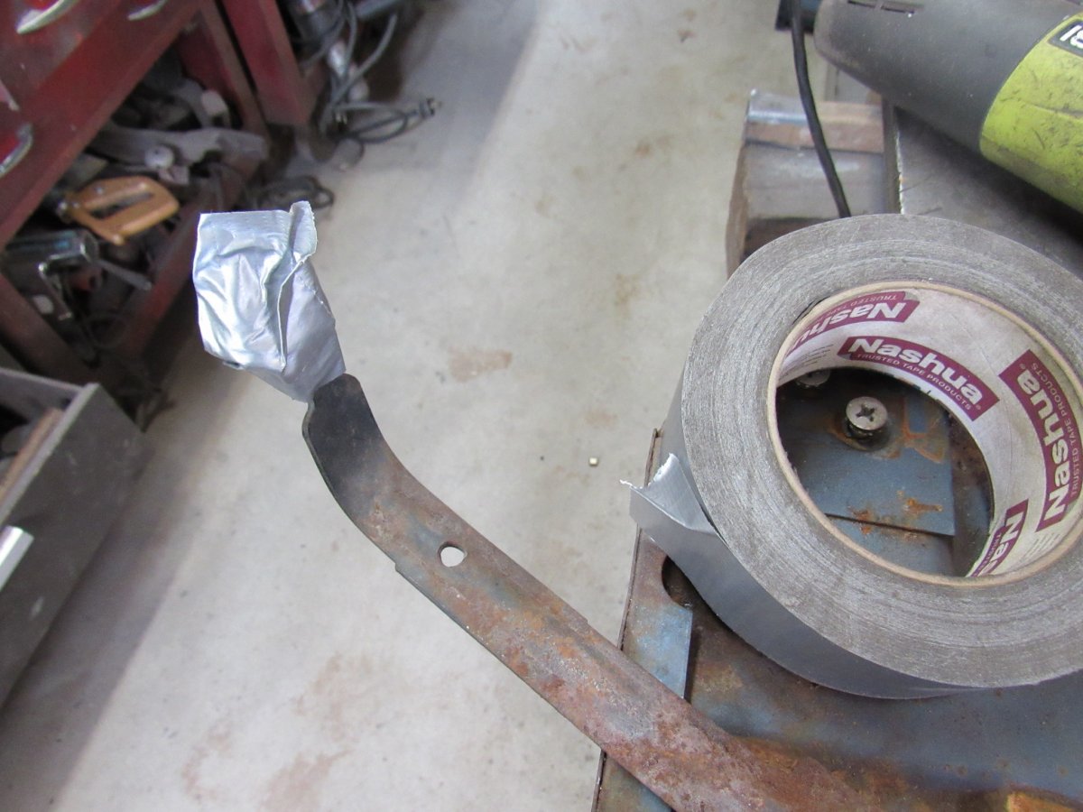

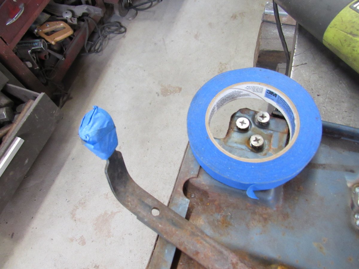

    before blasting this seat slider, to prep for paint, I needed blast off the rust and old paint without harming the plastic knob. duck tape works well to protect things while blasting but can be a real pain in the *** to remove. sometimes the glue stays on, so to aid in the removal I use a low stick tape first, then put the duck tape over it. removes easily after blasting. IMG_4639.JPG IMG_4640.JPG IMG_4641.JPG
