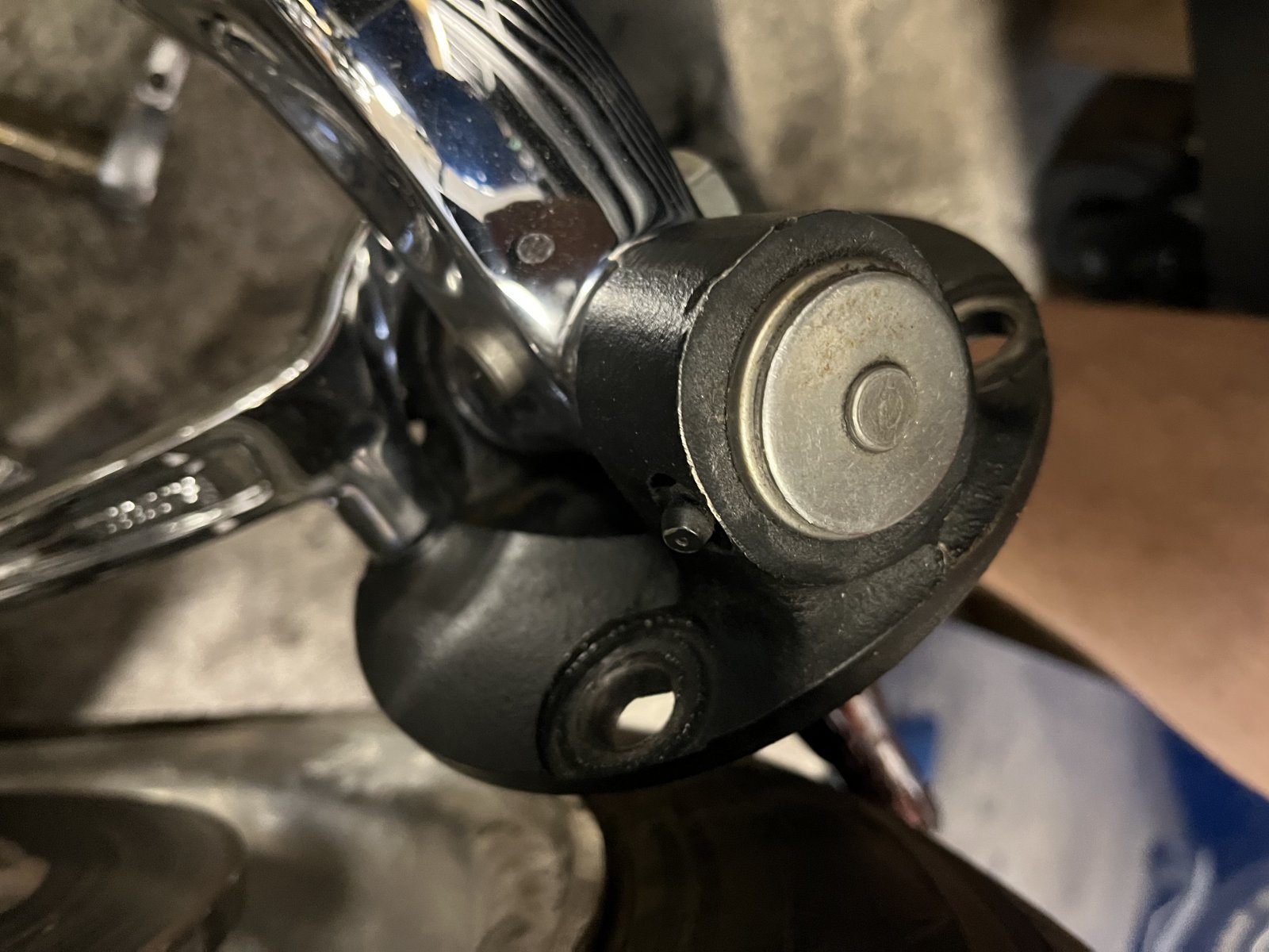

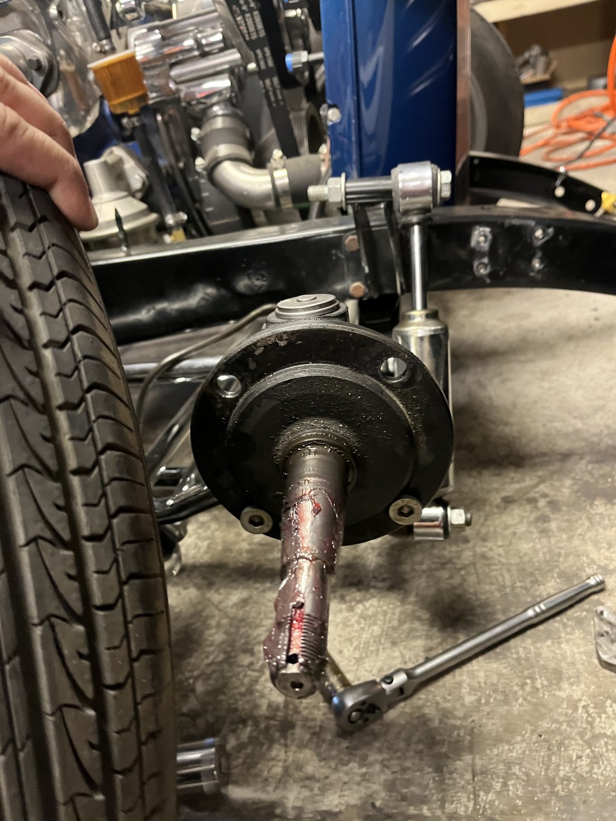

    Hi everybody- working on my deuce coupe and would like to change from spindle mount wheels to lug mount so I can put Steelies on them. How do I go about this?
    What do I need to buy?
    Here are some pictures, can I use my existing brake calipers on a lug mounted setup?

    You will have to know the brakes manufacturer and ask them if they have a hub and disk that work with that caliper.

    Sell the wheels with the brakes. Then with the money buy a disc brake kit to fit the ford spindles with the hubs with the bolt pattern you need.

    Repro hubs, and a disc kit.

    Which bolt circle would you like on the hubs?
    There are more choices for 5-on-4-1/2", or 5-on-4/3/4", than there are 5-on-5-1/2".
    If the smaller of those bolt circles is ok, then So-Cal has a kit that has one-piece hub/rotors, and uses a finned aluminum Corvette caliper that fits the current design language of the car:
    https://www.est1946.com/so-calspeedshopfinnedfrontbrakekit.aspx
    I mention this one, because the other kits, irrespective of source, use a generic GM Iron caliper, which, well, looks generic.

    Your old wheels look like Eric Vaughn wheels and if they are like mine, they had small JFZ calipers and solid 3/8” rotors, a nice setup but the brakes are specific to the wheels. They are definitely rare wheels and you should keep the wheels and brake parts together.
