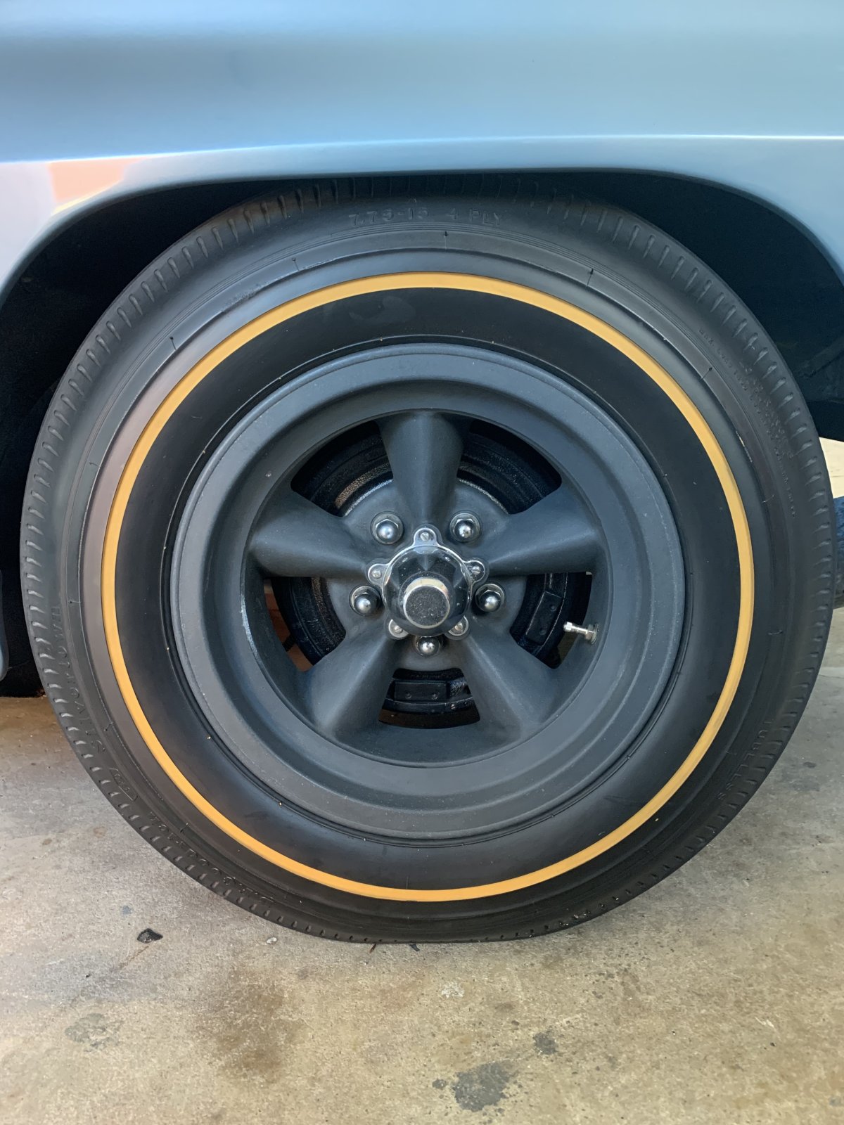

    Originally American magnesium torque thrust wheels came with polished rims and natural centers. Halibrand magnesium wheels came with a gold tinged DOW chemical treatment on them. Some of either came polished from the manufacturer at additional cost. I have been running a number of them for the last 50 years or so, and I clean them with WD40. If the dreaded white furries, come out; I use 0000 steel wool and WD40. Back in the day, a lot of guys also used diesel fuel on them. E87E83C9-B3B6-45E3-BE4C-DF4A1C505E29.jpeg
