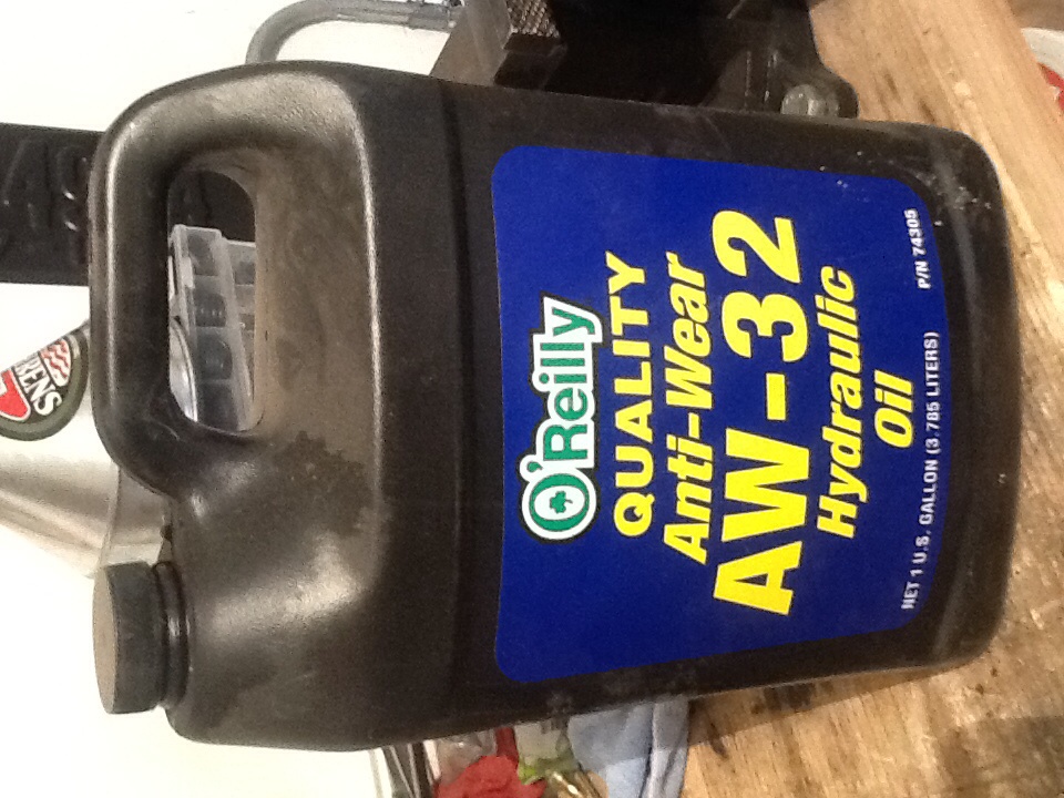

    Hydraulic oil, I used it in my rear shocks on my '37 Nash. Fill, pump and refill until full. Smallest size I could find was a gallon, won't need near that much. Farm and fleet or auto parts stores all have it.

    These days I don't think regular hydraulic fluid is any more expensive than the cheap 30 wt. Or a quart of jackoil at the parts house. The AW 12 That Stevie Nash showed is 12.99 a gallon locally at O'Reilly's and the ketchup bottle is a buck next door at Dollartree.

    That sounds about right, it was cheap.
