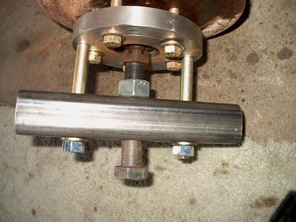

  6. Here's a pic of a home-made puller.
    Bolts are shown since it's being used on a Plymouth in this pic.
    It's also capable of being set up with shorter bolts and fine thread nut couplers that thread onto wheel studs.
    That's a 1" bolt in the middle.
    The 2" square tubing has 1/4" walls.
    Make sure you protect the axle threads with the axle nut turned backwards and screwed part way on.
    Once you crank it up as far as you dare, apply a little heat to the hub and it will pop loose with no problems.
    This puller is also set up to take an 8 ton bottle jack.
    Longer bolts between adapter flange and the 2" square tubing are required.
    Keep the jack reservoir oriented to to the top if you set it up for a jack.
    Regardless, the 1" bolt puts out as much or more pull than does the 8 ton jack as far as I can tell.
  7. Here's a pic of the puller in use.
    Make a point to oil the 1" bolt & nut a bit to cut the friction down.
    We call the puller, "Mongo."
    Mongo pull anything....

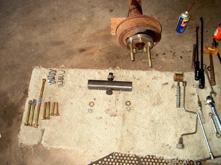

  8. Here's Mongo in his disassembled state with all the extra pieces to use the bottle jack and adapt to other things.
    Mongo came out to be a nice looking project.
    I am fortunate to have access to a lathe.
    There's no reason a flame cut piece of round stock with drilled or flame cut holes for the wheel studs couldn't be used.
    A little grinding and Mongo be pretty....
