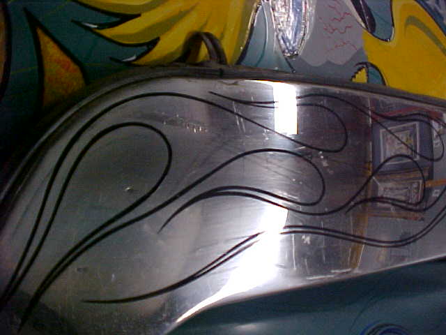

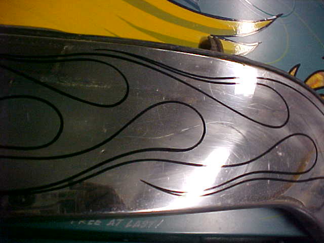

  6. DO NOT USE ACETONE!!!!!!!!!!!!!!! If that is enamel you have some very pretty metallic blue rags and a VERY unhappy owner!One of enamels virtues was when it was fully cured it had a very hard(but thin)outer skin that required very little in the way of maintenance as opposed to the lacquer paints of the time.The problem is that if you disrupt that outer shell,the exposed under paint is still relatively soft and deteriorates rapidly when exposed to UV radiation.This is why buffing of enamel isn't recommended.
    Using acetone on that would be like using paint stripper which usually has an acetone component along with MEK and several other vile chemicals.
    My best guess is if it has been on that long,you are looking at stripping to bare metal,acid etching,and complete repaint.1-Shot and other enamel based striping paints will actually etch the surface of the metal ;penetrating the overlayer of paint.
    Here is a picture of a stainless steel fender skirt off my Safari that I had stripe flamed and let set for about two years.I decided to change the design a bit so I stripped the paint off using commercial paint stripper and a gray scuff pad.I then polished the skirt with mag wheel polish and a buffer.Even after all that you could still see remnants of the original design etched into the stainless.

    Thanks for the info/warning regarding trying acetone. Interesting post regarding the etching down to the metal underneath.
