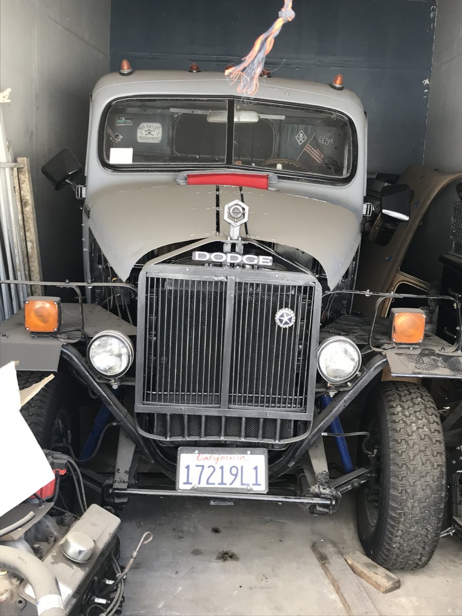

  20. tramp63
    Joined: Apr 20, 2009
    Posts: 17
    tramp63
    from fontana
    Here’s a pic
    Sandgroper and Budget36 like this.
