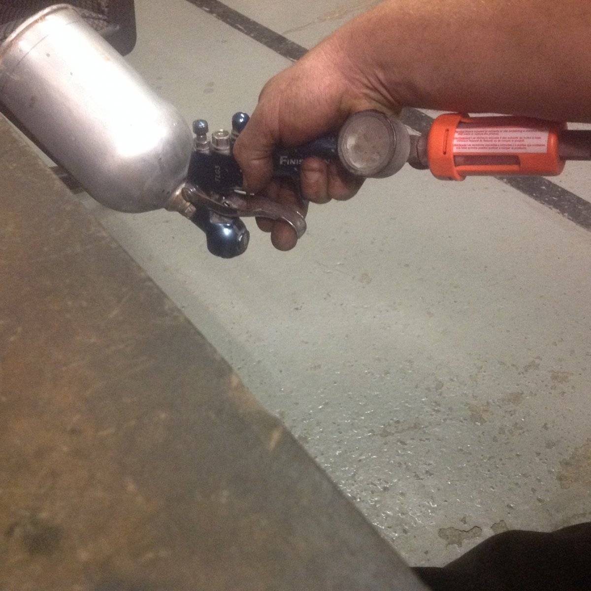

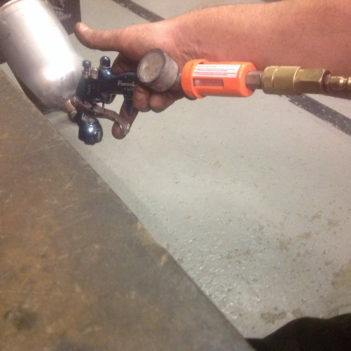

  26. Holding the gun differently help for spaying roofs.
    If I hold it the way shown in the first pic I get a lot more reach. And it's way more comfortable than in the second pic. It's very subtle but makes a big difference.
    Wrist straight
    whtbaron, Texas57 and tb33anda3rd like this.
