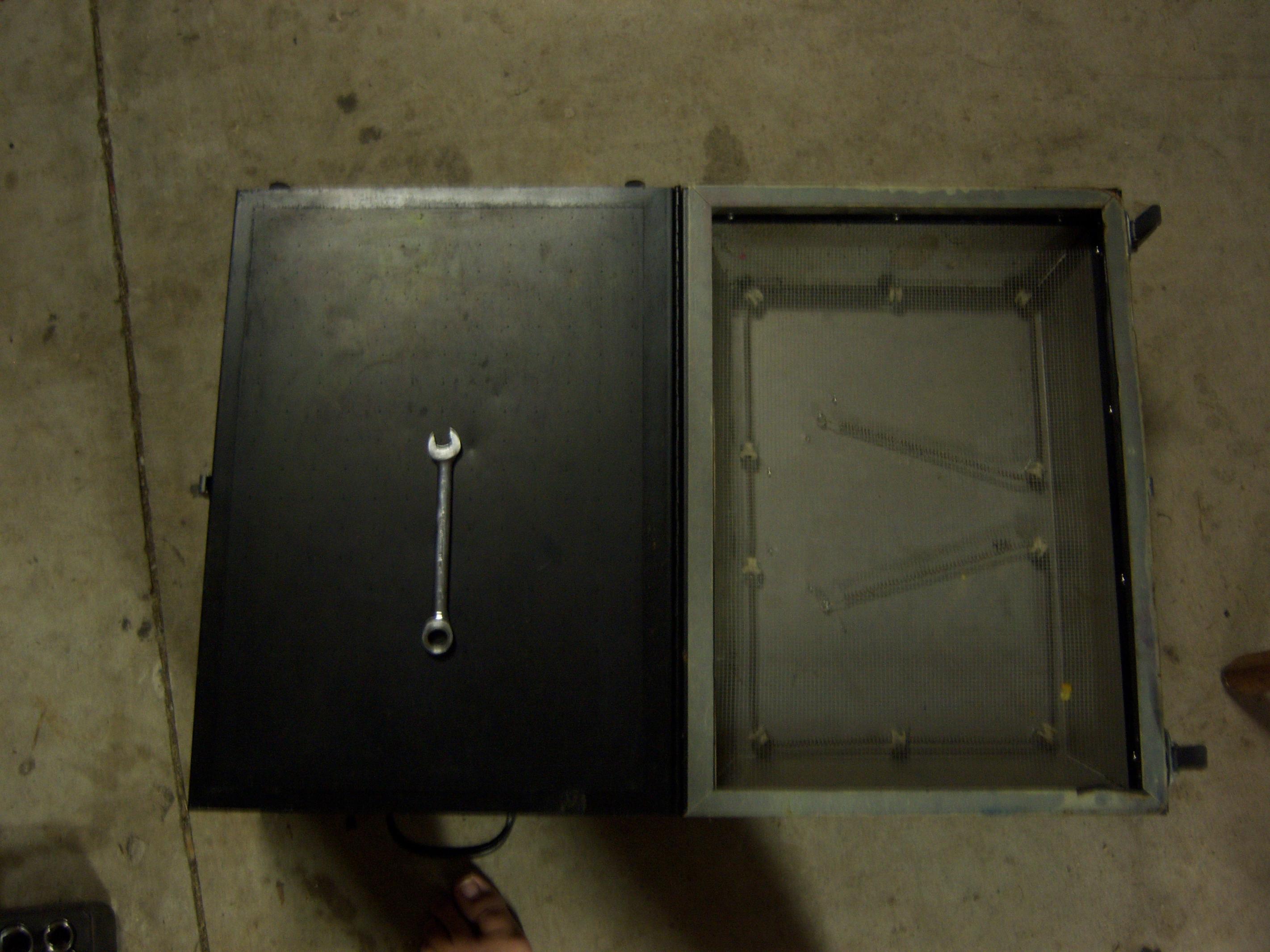

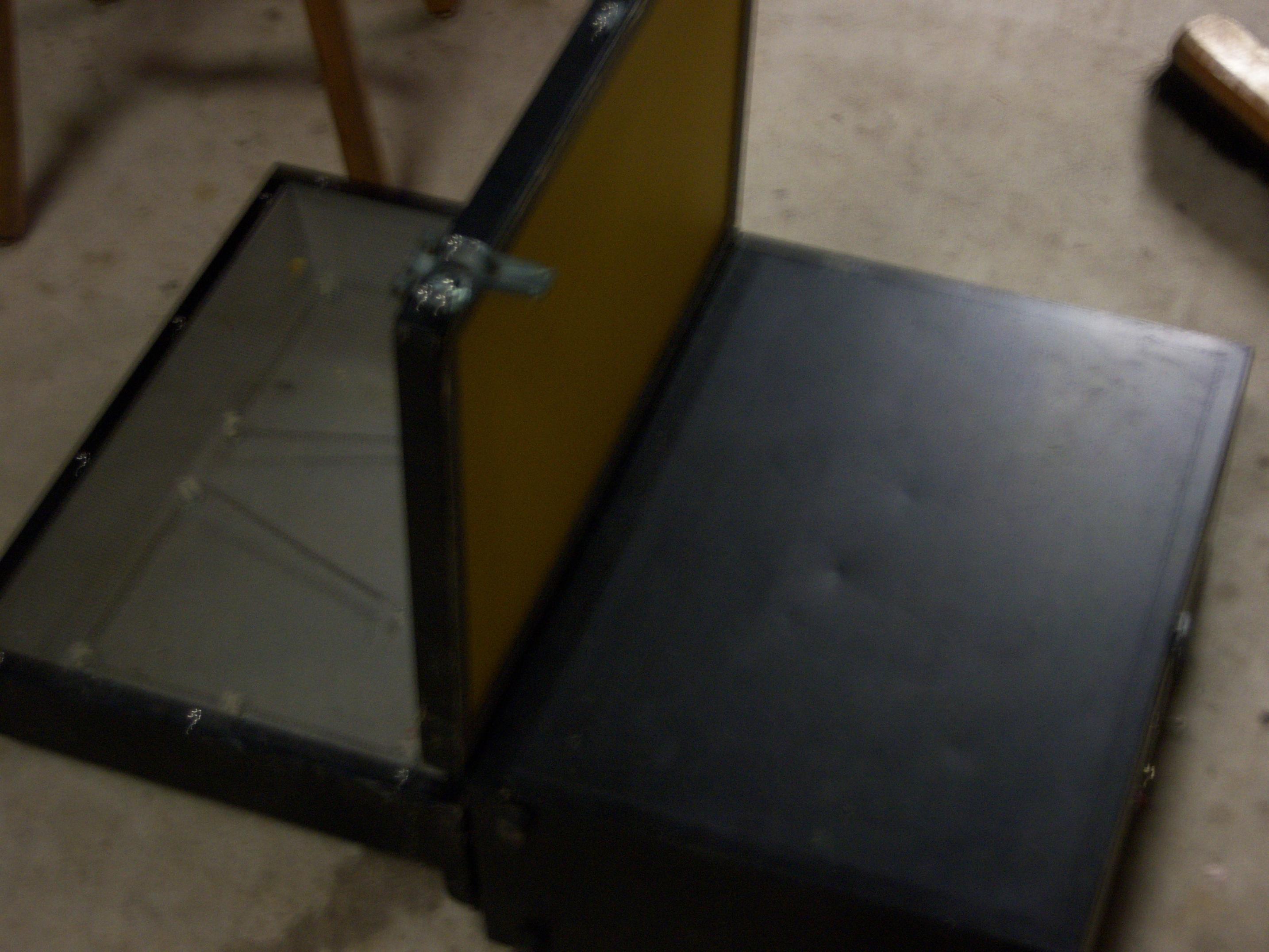

    I know my pictures **** but this is what I have , Its a va*** mold machine it has a heater on one side and a va***e on the other you put a thin plastic in the frame put it over the heater for about 1 minute then you flip the frame over and flip the switch from heat to vac and whatever the item laying on the vac surfice is it makes a mold of it I have used it to make liners for gun boxes, knives ,wrenches and other things but if you was to reverse the fan for the vac you could probably do the opposite.
