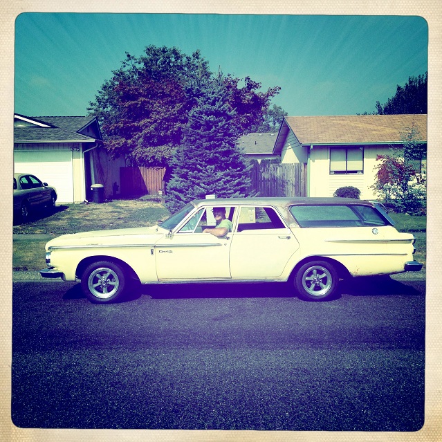

    My wagon sits a little low one side in back. Looking at Eaton springs.
    Stock is 6 leaves rated at 880 lbs load.
    Police/Taxi HD sedan are rated at 720 lbs load.
    Standard sedan 640 lbs.
    Certainly won't be hauling any weight around. Right now she rides like a big boat - you don't feel speed bumps - just hear them. :)
    Any suggestions on which springs to run? Don't want to gain too much height or loose the ride quality. But then handling might improve with better springs.
    How she sits now:

    Good point though about the load - my wagon needs the capacity for haulin' people.
    Lookin' at spring ratings for like wagons of the era, they are all close to 900 lbs and up well over 1,000 lbs....
    :eek:
  7. 53 COE
    Joined: Oct 8, 2011
    Posts: 688
    53 COE
    from PNW
    Decided to go thru Eaton Detroit Spring Inc and get the OE spring replacements rated at 880 lbs. And of cource new U-bolts.
    They most def have the knowledge. Called them and it was instantaneous and correct info for what the '62 Dart wagon needs. Other companies wanted to sell incorrect sedan springs rated as low as 640, yet claim they were correct. Eaton for the win!
