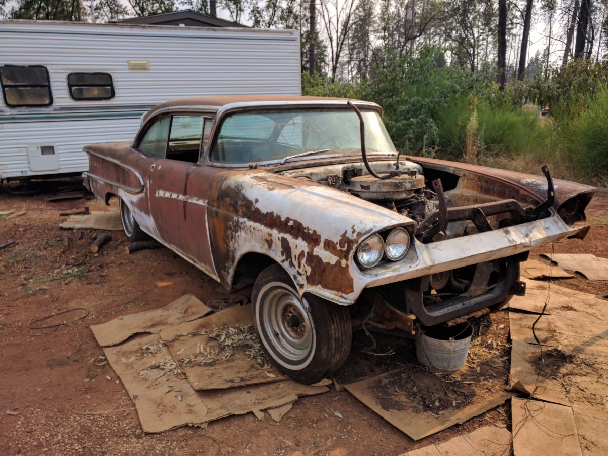

  11. Flynn's_57
    Joined: May 10, 2002
    Posts: 949
    Flynn's_57
    from Nor*Cal
    Wow, way more responses than I thought!
    Yes, it's a small-series (Pacer; ford-based) that had a 361 FE in it.
    (Edsels are so weird- this FE has a 4-barrel intake w/a two barrel adapter on it I'm almost positive came from the factory, one of many things that makes you say "oh, okay, well I guess that works,").
    I've already replaced the steering column with one from a '58 Ford, the tele-touch ****ons were all removed when I got it. The ford column doesn't have the blinker switch in it however, anyone know if they are the same?
    I'm kinda thinking a 302 & 5 speed out of an 80's ford (truck, mustang or...?) might be the easiest but I'm wondering if a 361 or larger would get better mileage... I've got the front-end off and man is it heavy... (the custom front doghouse I'm using seems much lighter). The idea of running a big block FE in it still seems very cool and alluring-
    I pulled the 361 out using a tree, the engine is still patiently waiting for me to decide what to do with it.
    I'd like to keep it, but there's a Y-block for sale ("pulled when running") that seems pretty decent in the price department.

  15. Flynn's_57
    Posts: 949
    Flynn's_57
    from Nor*Cal
    I've pop-started cars when the starter failed or the battery died, can't do that with an auto my man. What might I have mentioned earlier? I never know what to tell you guys online. I went with a 302 & 5-speed in my '57 ford. Only reason I'm doing the '58 Edsel now is the '57 was consumed in the paradise fire (I think they called it the "Camp" fire, which is ******** but that's another topic-).

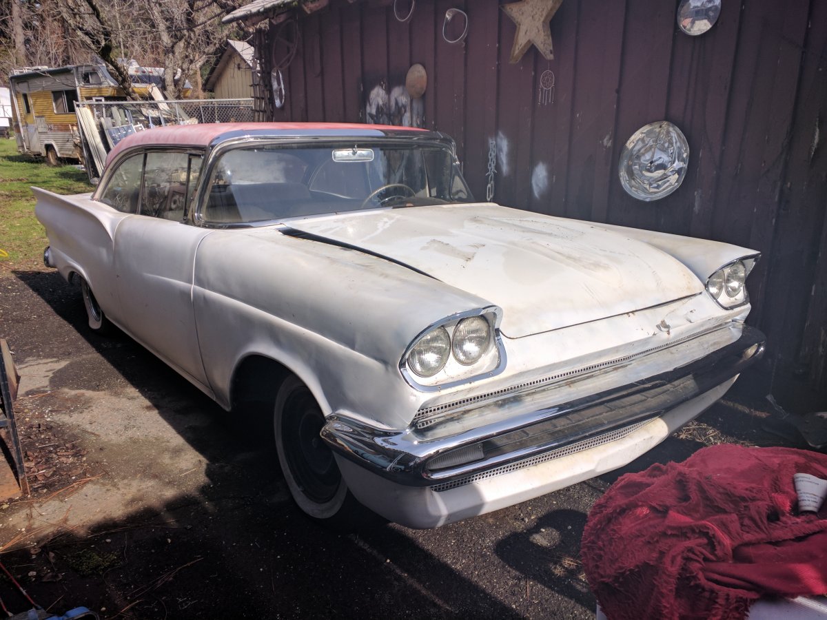

  16. Flynn's_57
    Posts: 949
    Flynn's_57
    from Nor*Cal
    before & after

  26. Flynn's_57
    Posts: 949
    Flynn's_57
    from Nor*Cal
    Fibergl*** boggles my mind!
    Just cause it looks like something 90 years old doesn't mean it should cost that.
    Just imagine if we paid for the labor to make it and the materials-
    Would it cost so much? :eek:
    Oh! Okay, so right now I have the 1958 361 FE with the Tele-touch trans.
    I am hell bent on a manual trans (column or floor, nothing to me so long as it's manual)
    I've used an 80's 302 (in the past) on my '57, which should have the same mounts.
    But Edsels used larger motors (cause the front was so heavy I guess),
    and who doesn't want a MONSTER under the hood?
    But, gas mileage reminds me I ain't JAY LENO-
    (ain't that the dream though? A comedian car enthusiast?!)
    And sixes ... I do like the inline engines.
    (But, it's kinda like Squirrel said: "guys do body stuff for a reason,".
    I can mess with motors, but I'm not a mathematician or rocket scientist,).
