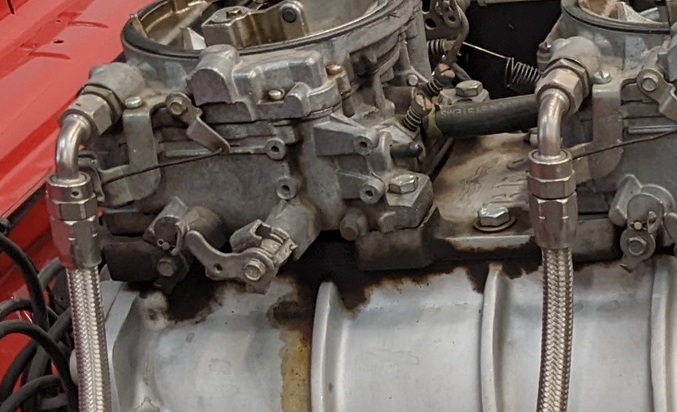

    Joined: Sep 23, 2004
    Posts: 60,009
    squirrel
    I've never seen banjo bolts with a tapered pipe thread....but other than that, it's a swell idea.
    Actually I was talking about a hose end fitting that has an angle built into it, like these 90 degree fittings (other angles are available also). But the one you showed would work, too.
    They're not as close as a 90 degree NPT fitting, which might be an issue, especially when attaching something to the top of a fuel tank, which sits under a floor, for example.
