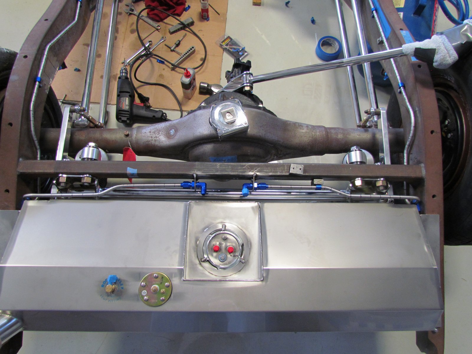

    Here is a shot of the in-tank fuel pump. The red plugs are where the 90 degree elbows go. They are 1/4" NPT to the pump and -6 A/N to the hard lines on the top of the photo. I want to use braided flex line between the pump and the hard lines (pressure line to the engine & return line to the tank). Currently, (although not shown in this photo) the right angle elbow installed into the fuel pump don't come close to facing the correct direction (toward the hard lines) and actually come out of the fuel pump facing toward the side or even the opposite direction.

    Unless the current clocking is in absolutely the wrong place, I'll say somewhere between 6 and 8 oclock, it would seem to be easy to just fashion short tubes with some bends. Looks like some nice work.
    I'd say take the non-conforming NPT fitting along with you and return to the store. Note where the thread ends (clocking) in relation to the output end, and see if there are any that have a thread that ends in a different clockwise location. You should not need or use any type of sealant with copper thread fittings. One thing I would say about trying to retap a hole (in the fuel pump) is that if you get it slightly too big, there is no way to repair it. I'd try doing it on another fitting before I tried it on the finished part. Best is just finding another fitting that will work.
    Is there enough room to just completely retap the hole to accept a larger AN fitting and get away from the NPT?
    Looks like you do some very nice work there..........:) Got any pictures of that rear sway bar set-up?
