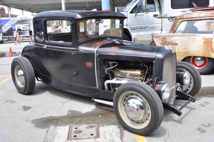

    Man you drilled the look! Are the tire sizes 5.0's and 7.50's? Great stance.

    5.50's and 7.50's. I put a B in it warmed with a SU-1R Winfield cam, Winfield 6.4:1 head, Mallory ignition, dual header with dual exhaust, Burns downdraft with a pair of 81's, lightened flywheel and a counter balanced crank. I mated a 37-38 helical gear trans behind it with a Cling's adapter. Car ran HARD and did freeway speeds with little effort.

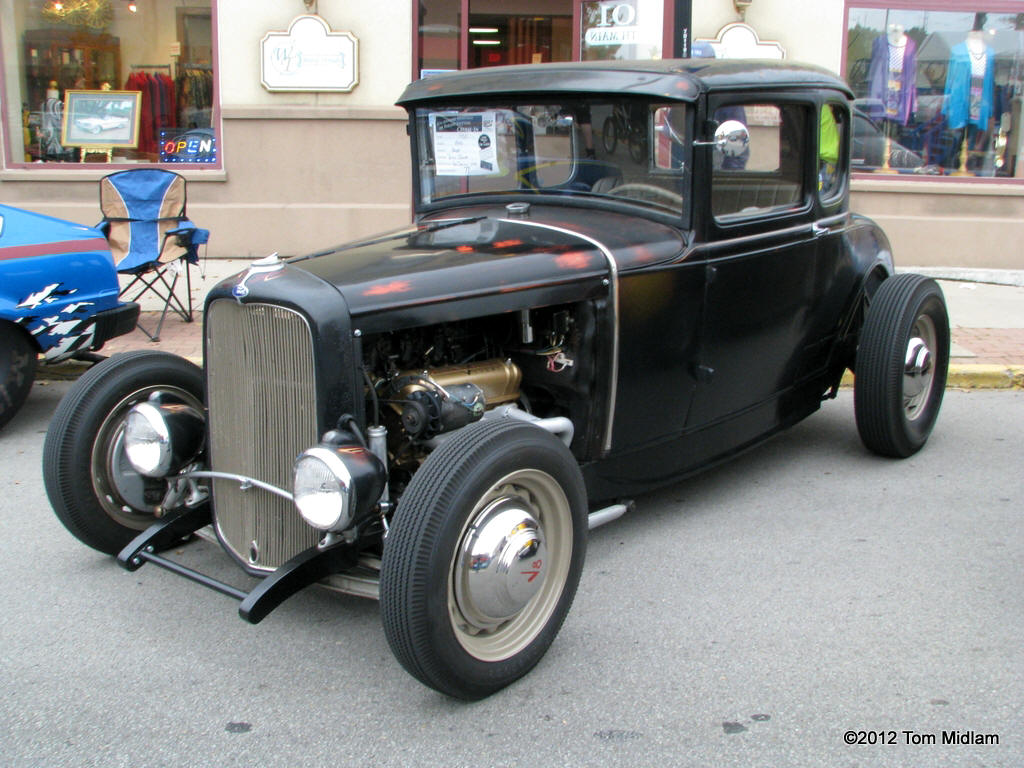

    Heres my roadster with all A running gear. It had stock front and rear axles, I removed a couple leafs out of the front and reversed the eyes, and ran a T spring out back. Ran the old engine/trans out of my coupe, along with all the stock mechanical brakes out of my coupe. One of the most fun cars I ever owned...

    Chris, your A has the exact stance i want for mine, how did you lower the back ?
    I was thinking on using the vern tardel z'ing method but if it's possible to have the same stance by replacing the A spring for a T spring, i would prefer that instead of cutting my original frame.
    Elrod how is the ride with 2 leaves out of you T spring ?Does sometimes tires hit the back fenders ?

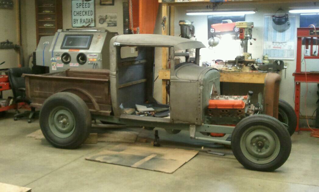

    Here's my 31 pickup. Front is Model A axle with a 3" drop, front spring is a 3 leaf low arch reversed eye I got from a guy that makes custom springs. Rear is an "A" spring. Leaves removed, ends heated and bent. 3 leaves in pic, 5 leaves installed total. Here it is installed also.

    I just ran a T spring, no frame cutting required.
