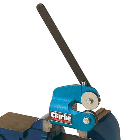

    Everything listed above and a couple of these in different sizes.
    mad mikey and lostone like this.

    Some of the above plus one of these for smaller bits.
