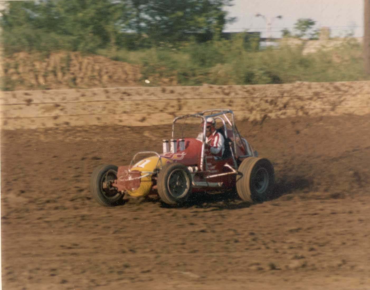

    But my race car only had one speed, you just put it in gear, press the loud pedal and go fast.
    We actually geared the car to almost bog as you got back into the throttle about the middle of the corner. That was probably close to, but a little below peak torque. Once the track got slick it was all about momentum and not spinning the tires.
