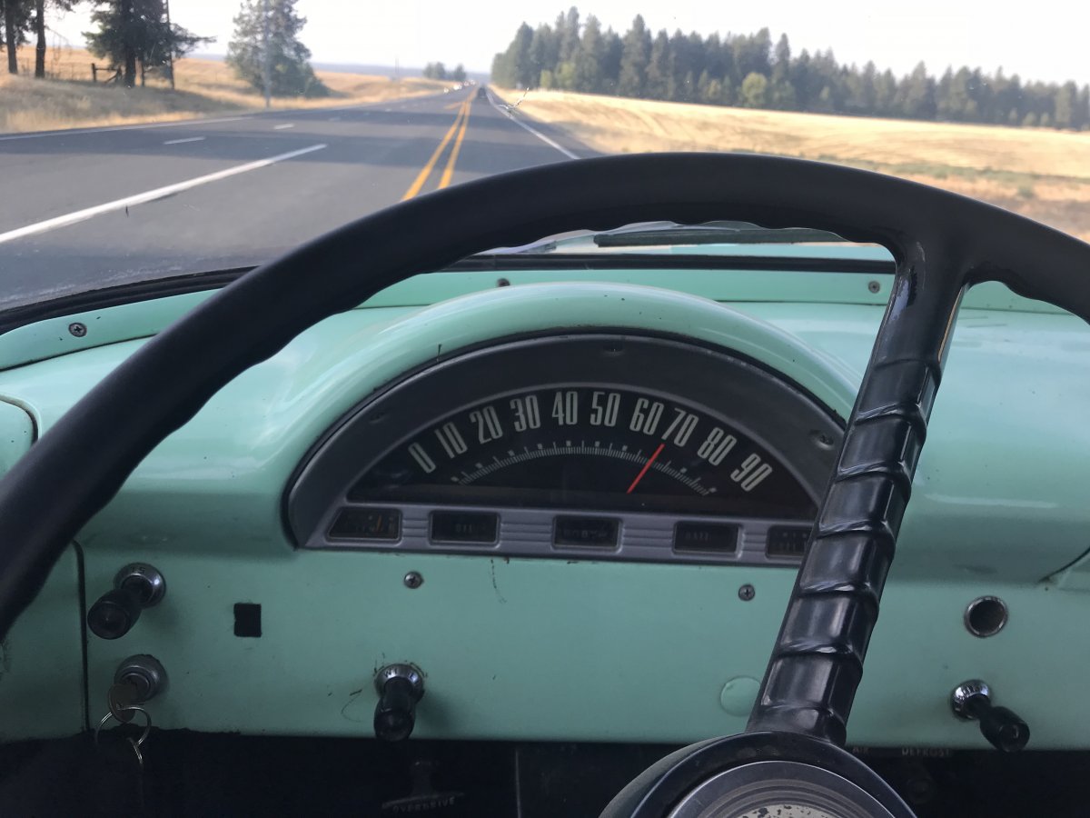

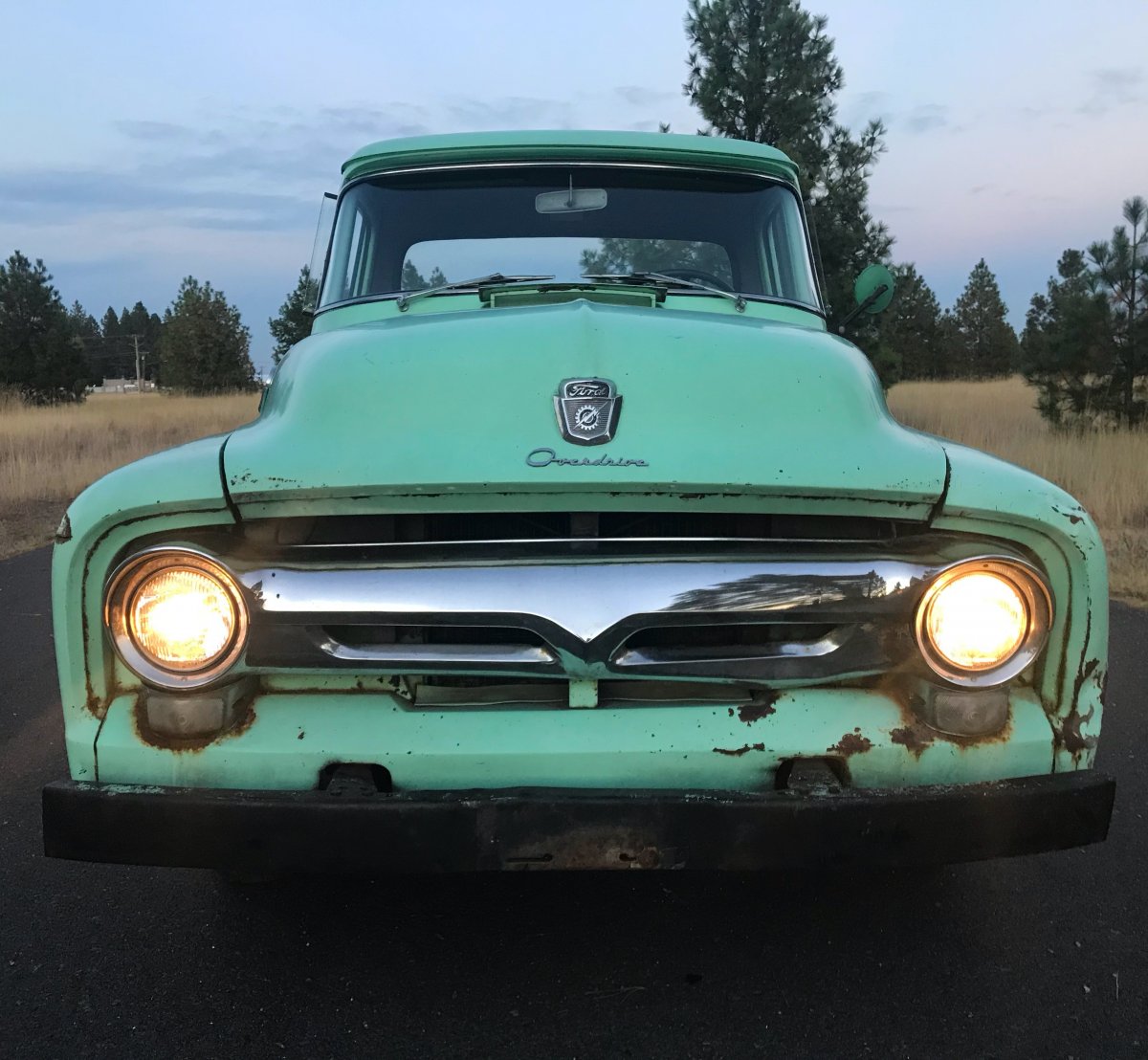

    I just bought a 56 F-100 with factory overdrive and it really is a cool transmission how it works. My overdrive works great...my one questions is, is it safe to push or pull the lever while the vehicle is moving? I can see why you would have it engaged all the time, but say I wanted to disengage the overdrive. Should I come to a complete stop first?
    Also, does it do harm to lug the unit in OD? Not that I have, but lets say you are climbing a hill and it does not kick out...will it hurt it? The truck has a 223 6 shooter by the way
    1053DBDC-9B10-4586-BA1A-6F462F0A42BA.jpeg 7356D1CC-7C40-447E-AE8F-316AD3895D26.jpeg

    I moved my GM at times. Since mine was set up with a toggle and not factory it was not a problem. If I wanted to lock it out while driving I'd make sure to be accelerating slightly in high gear so it would not be in any free wheeling mode. Going the other way could happen at anytime since I used a toggle to engage it.
    I used 2nd OD a lot when climbing in hills and never had problem. I had a tach and never ever let it under 2000 rpm in 2nd OD; as it started slowing on a grade I'd flip the toggle back into standard 2nd and pull the cable to hold it there to keep it from free wheel. Sounds complicated but for me it wssn't

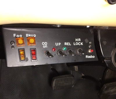

    IMG_0579.JPG download (17).jpg I have thought of wiring an Eaton 2 speed switch into the system .

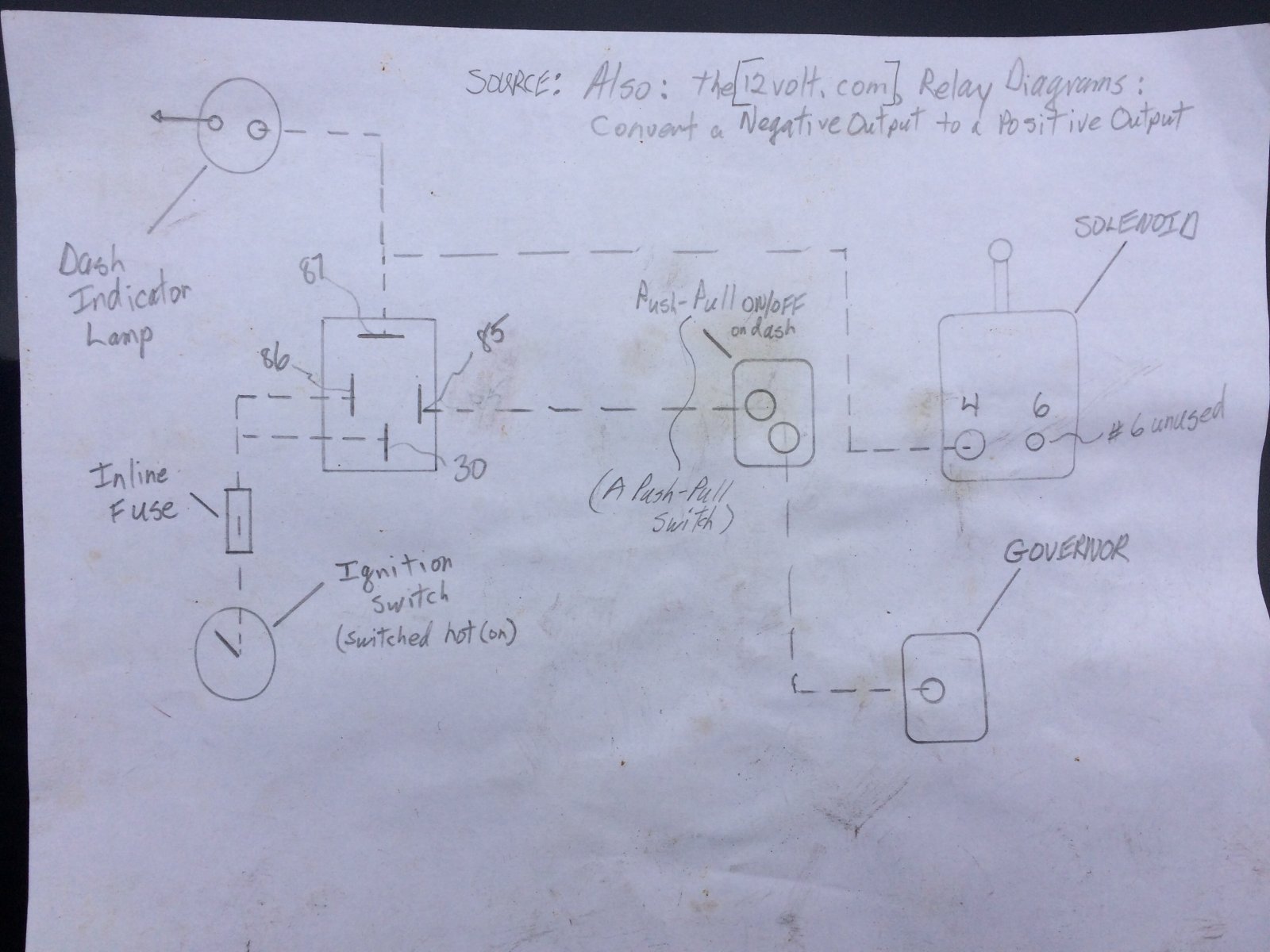

    not really....the solenoid has a power input and gets ground from the housing, and the governor only grounds the terminal when it gets to speed. You need to switch power, and the governor won't do that.
    On the Edsel, I used a horn relay to overcome this problem. pretty simple.
