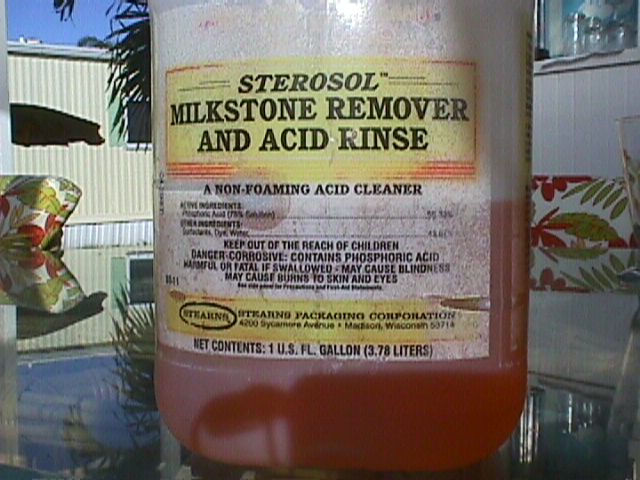

  27. Muriatic acid (hydrocloric acid) will eat away corrosion AND metal...as will battery acid (sulfuric acid), and nitric acid. Phosphoric acid (Navel Jelly, CLR, etc)will not eat away metal, only the corrosion..EXCEPT for aluminum. I use a lot of phosphoric acid for rust removal, corrosion removal, etc., on iron, steel, copper and brass. I get mine at the local Tractor Supply (Farm and Home, etc). It's called "Milk Stone Remover And Acid Rinse" and is used by Dairy farmers to rinse the inside of their stainless steel milk holding tanks, to remove calcium film. It comes in 1 gallon plastic bottles and runs about $12-$13 a gallon. I've used it to remove the crap in radiators, with great results...among other uses. It dissolves everything, but leaves the metal. Using Muriatic acid is a crap shoot, since the time necessary to dissolve the deposits, and the time necessary to eat up the metal is real tricky...
