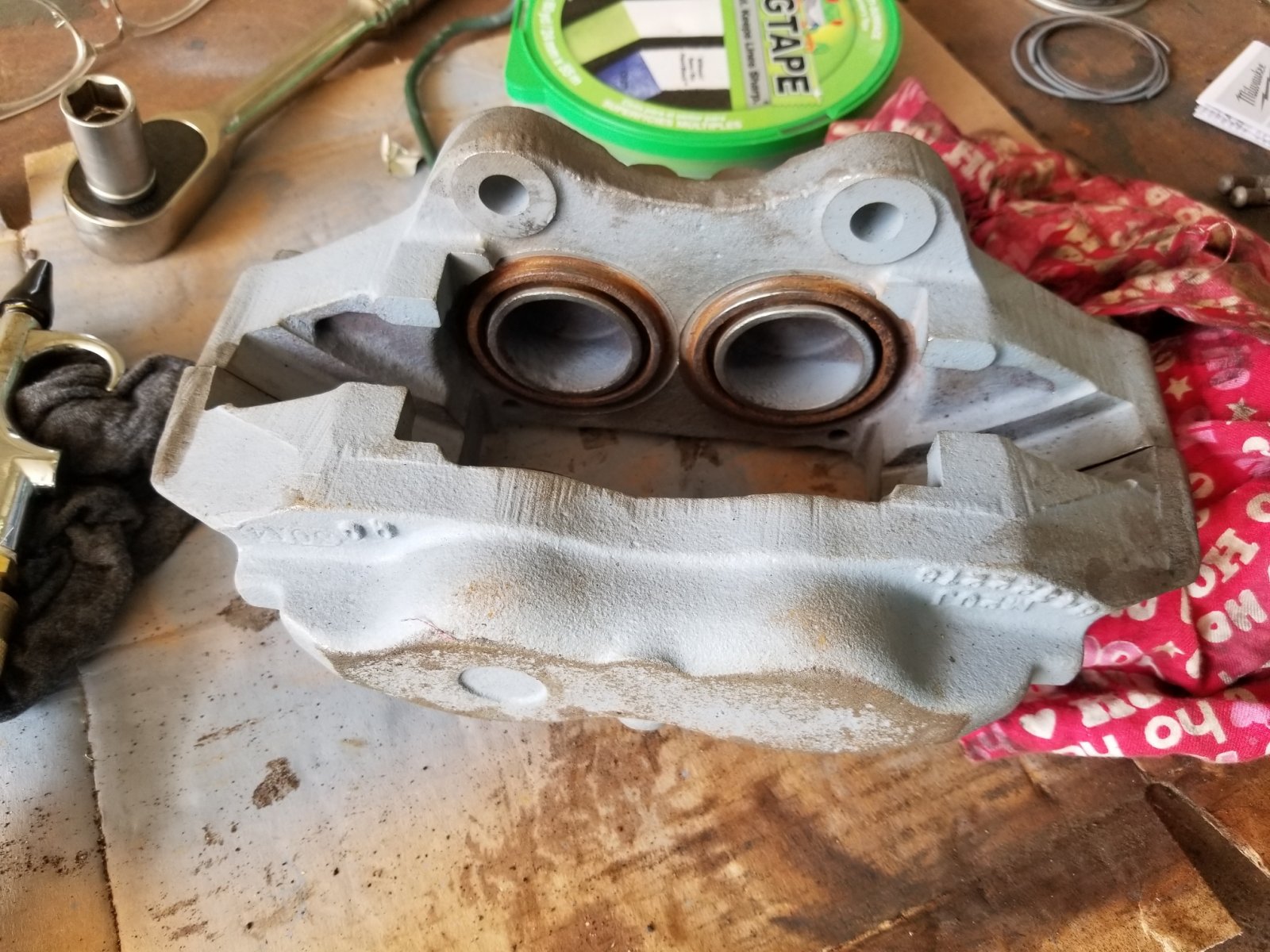

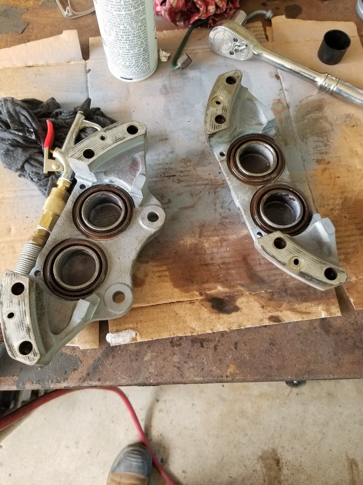

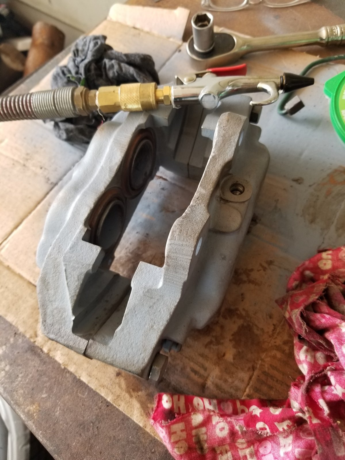

  1. 20220522_141120_resized.jpg 20220522_141134_resized.jpg Rebuilding my calipers. Front end could have been sitting in the dirt forever before I got it. Front end is from a '86 Jag XJ6 so OT here but, belongs to the front of my 1965 F100. I've blasted the outside of the calipers. Bought stainless steel pistons and new seals. I split the caliper, because you can on these, then checked the small seal that surrounds a port going from one side of the caliper to the other. Gave each of the pistons a good smack to break them loose in their bores then bolted them back together and threw a rag between the caliper sides and gave them 90 lbs of air pressure to pop them out. No Go. What new or old world trick is there to get these pistons out? I can drop them in a bucket of Evaporust I guess but, hoping to get at these today.

    Maybe a small hole and a slide hammer? Probably going to mar the surface of the bores up though.
    Flathead Freddie likes this.

    That is odd. After they soak, maybe up the PSI to 120?

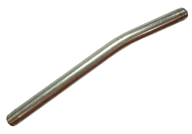

  4. FF8C2D53-446F-4E27-AED1-1EC2C8810426.jpeg When I would rebuild those calipers a grease gun pipe threaded into an air blower and it threads perfectly into the brake line hole.
    a 1/2” or so bit of ply wood so the pistons have something to hit against .
    and WATCH YOUR FINGERS !!!!! When the pistons finally decide to come out nothing will stop them and the fu)&ing hurt !!!!
    tapping around the calliper with a hammer helps to free them up as well .
    pistons , dust covers and seals are all readily available, hone the caliper . Clean everything and install “ wet” with brake fluid and your good .

    If air wont move them , use adapter with grease gun . First separate halves , use wood or other to seal passages , do one half at a time and limit the amount the pistons can come out as to keep a seal if one piston doesnt move

    When I find problem pistons on brake calipers I dig the outside seals out first, and then blow them out with air. Often once the outer seal is removed I can spray some penetrant down around the piston and let it soak. Then they'll come out easy.

  9. All sounded good dudes, thanks. Looking at my pile of debris I ended up popping the seals off and blasted them with Sea Foam. After swearing at them I'm onto another task. F'in calipers!

  10. BE CAREFUL WITH AIR!!! Those things will come out like a fucking bullet!! Try adapting a grease gun and pump them out. Lots of cleanup afterwards, but safe!
  11. I'm with you man. I stuff a rug between calipers after bolting together and shoot them. 90 psi is my limit, not the compressor's.

    This is a total force , physics issue . Area of the piston x the pressure applied to the piston is the total psi force applied to the piston . Believe me it will hurt you terribly , use caution and up most safety . Brake fluid alone to the eyes is not a good way to loose vision

  14. I've always used a grease gun on the really stubborn ones. The zerk adaptor will usually fit right onto the bleed screw, just start pumping grease into it. One advantage over air is the grease isn't compressible so no worries about the piston flying out at high velocity; it'll only move by the amount of grease injected. With multiple pistons, once one is most of the way out, put a clamp on it so it won't come out more then start in with the other one. Like is said, it leaves a mess but there's no smashed fingers or other damage. If they won't move with a gentle squirt of air, more air usually isn't a good idea...

    Put a penetrating fluid in them thru the brake hose hole, let them soak for a while. After a day or 2 pour it out. Put a 1x4 or if enough room a 2x4 piece of wood in between the pistons and apply air. The wood will catch the pistons and keep them from flying out of their bores and no worry about getting hit with anything.
    The board trick works great. Literally done 100's that way.

    When using air, run the airline outside. Don't blow pistons out inside the shop. When they let loose, they either spray brake fluid or dribble it. Murphy's Law says that spray of brake fluid will find the nearest painted surface. A small amount of brake fluid on the concrete outside the shed is no big deal. A small amount of brake fluid on your freshly painted car will induce a coronary.
    Vandenplas' wood packer idea works. Make the packer thick enough (a couple of layers of ply or a pine offcut) that the pistons can't escape, just move a bit. Once they have broken free, user lower air pressure and fewer/no packers to drive them out.

    If you have a block of wood to stop piston travel it will also avoid the issue of one coming out, and the other stuck still. Once both have come out against the block of wood you can then hit it with air again, or grab the piston with large channel locks to pull them. Usually come out easy once you've gotten them to move a little.
