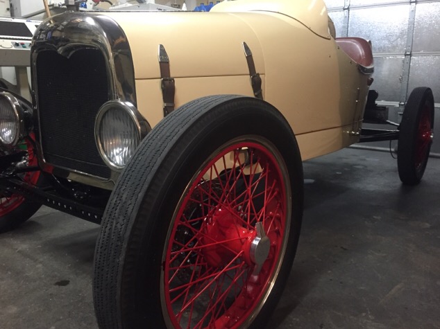

    This T has the same great stance

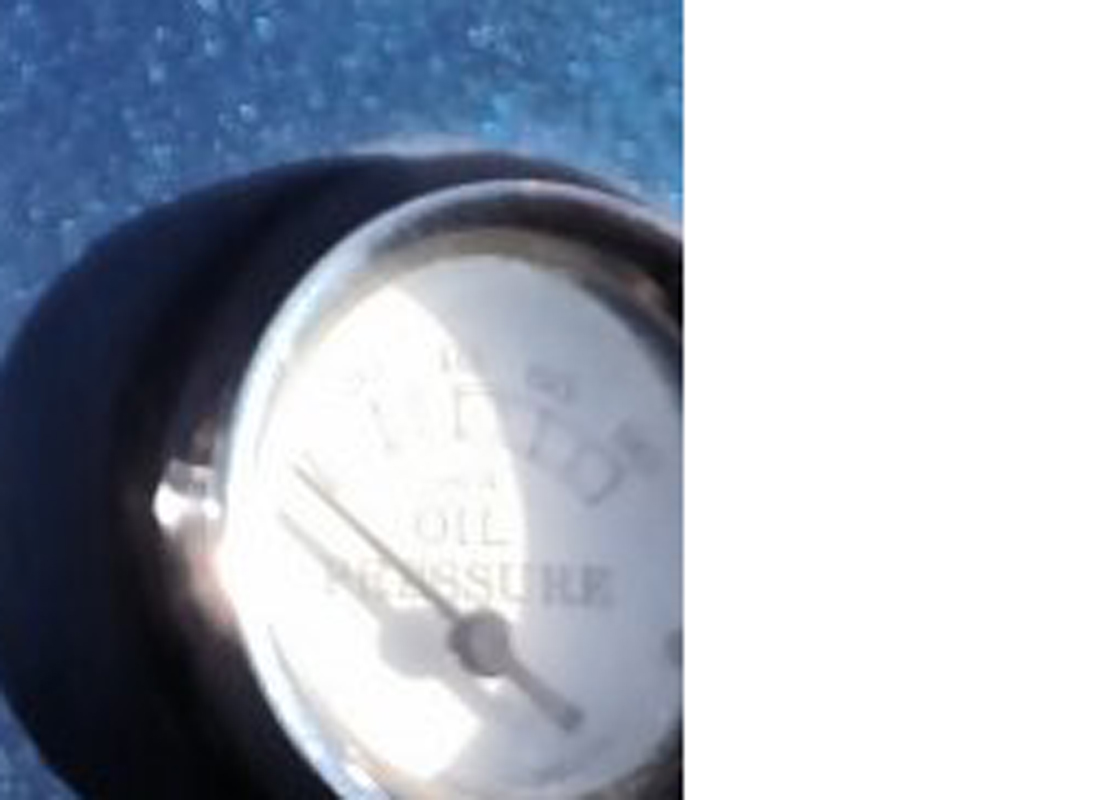

    Dash2.jpg Dash 1.jpg These look a little scary . . .

    Well... you asked about stance and a 4 banger a**** other things. Discussion about 4 bangers ensued. One guy posted a pic of the instruments in what must be a 4 cylinder car doing almost 80. Another member observed that the other gauges are reading almost zero and brought that to our attention.

    Was going to mention no oil pressure or water temp seems like a farce, but I was beat to the punch
