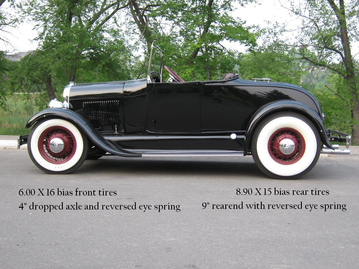

    Would you share the details on how you fitted the wires to the 9" and kept them tucked under the fenders so nicely?

    The 9" rear end came from a 1957 Ranchero. The Ford 9" from 1957-59 are significantly narrower than most others. The adapter/spacers for the rear wires came from Rally America - solid steel not aluminum as many are. The rear wires (originally '35 Ford 16") were modified to 15" and also widened some to the inside.

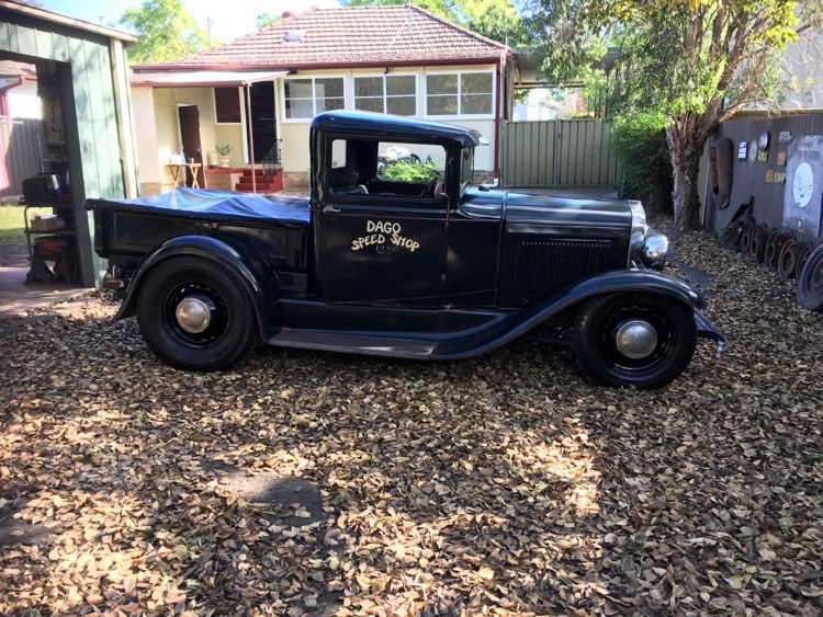

    4" dropped axle, reversed eyes front & rear removed half the leaves, the rest is tire rake. Yes the ride is **** but I wouldn't have it any other way :) 106453482_907414619737613_1623444792172664127_n.jpg

    what tire size are you running?
  30. Dago 88
    Joined: Mar 4, 2006
    Posts: 2,496
    Dago 88
    5.50 x 16 front & 7.50 x 16 Rear .
