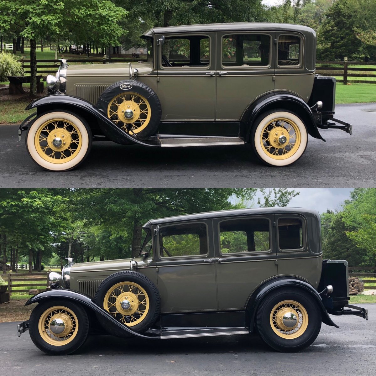

    Not a coupe of course, but my sedan has pretty close to the same stance you are looking for. 4 inch dropped A axle up front with reversed eye main spring and several leaves removed. Rear is T spring. 16 inch '35 wires, 550's up front and 700's in the back. Mechanical brakes, stock shocks and steering and a 4 banger.

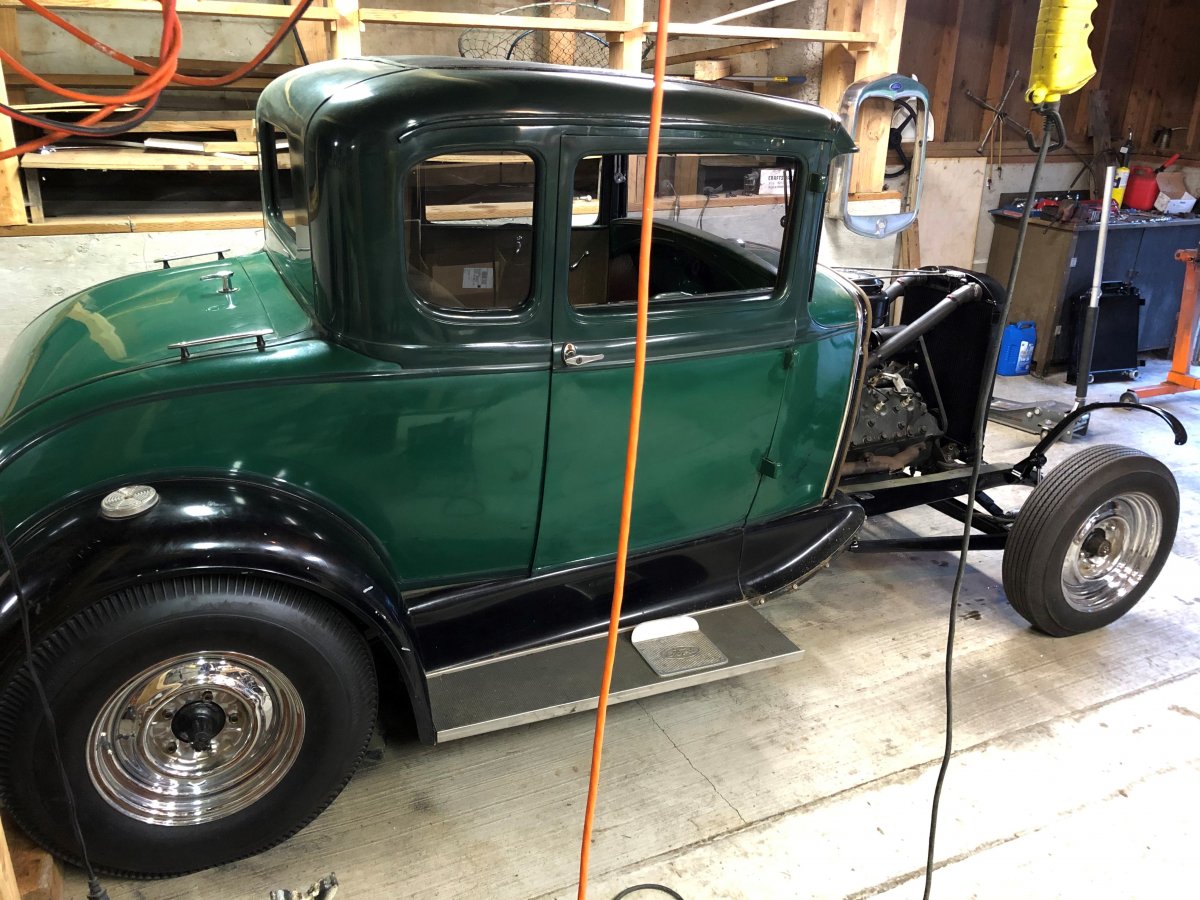

  8. I ran a T spring rear sans 5 leafs with reversed eyes, front is the stock axle dropped 4" with posies reverse eye spring and 1 leaf removed. Tires are 820/15 rear and 560/15 fronts on '46 ford plates/brakes and hubs. Didn't get a chance to put the fronts or bobbed rear fenders on before I sold it to a buddy that really wanted it, but we mocked it up and sits nice and low with that set up.

    Yep the stagger in wheel size make that look. I am amazed it took that long to get the real answer.
