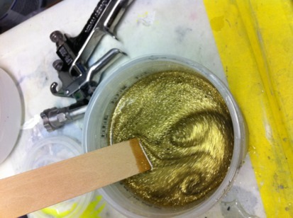

    I use a medium reducer and 2k clear to carry my flake. I spray the flake and wait for it to flash. I then spray three more coats of just clear. I then wet sand with 600 two or three days after and top coat with 2you more coats of clear. Comes out nice to me.
    I was taught from a friend that is a bodyman on flash time. He says wait till you can drag a finger with very little pressure on your mask right next to your panel and if it doesn't pull the clear or isn't sticky then its ready to recoat
