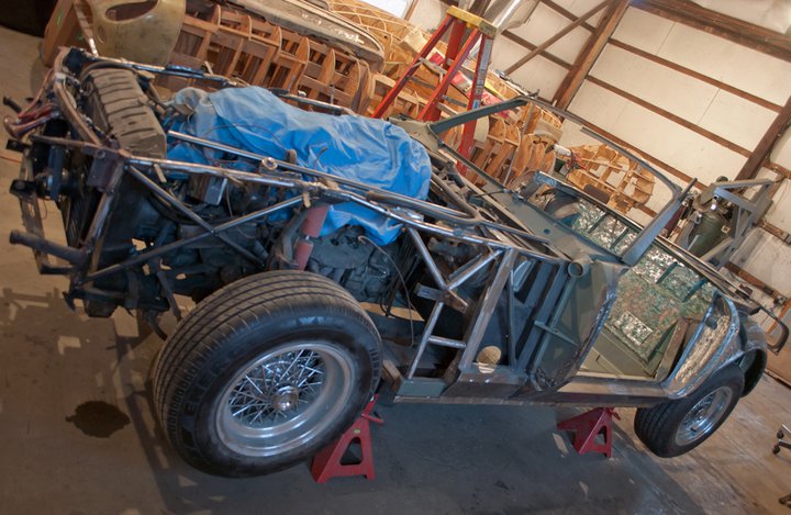

    FWIW, my day job is building custom super cars. Right now we are building a 1939 Dusenberg Coupe Simone (Thunder V12 w/ Tremec T6060), a 1939 Delahaye Type 165 Cabriolet (Jaguar V12), and converting a 1969 Ferrari 365GT into a 1957 Ferrari 250GT one-of-a-kind built for Prince Bernhard of the Netherlands. I've attached a recent picture of the Ferrari. In the background you can see wooden bucks for a Ferrari California Spider and the Delahaye.

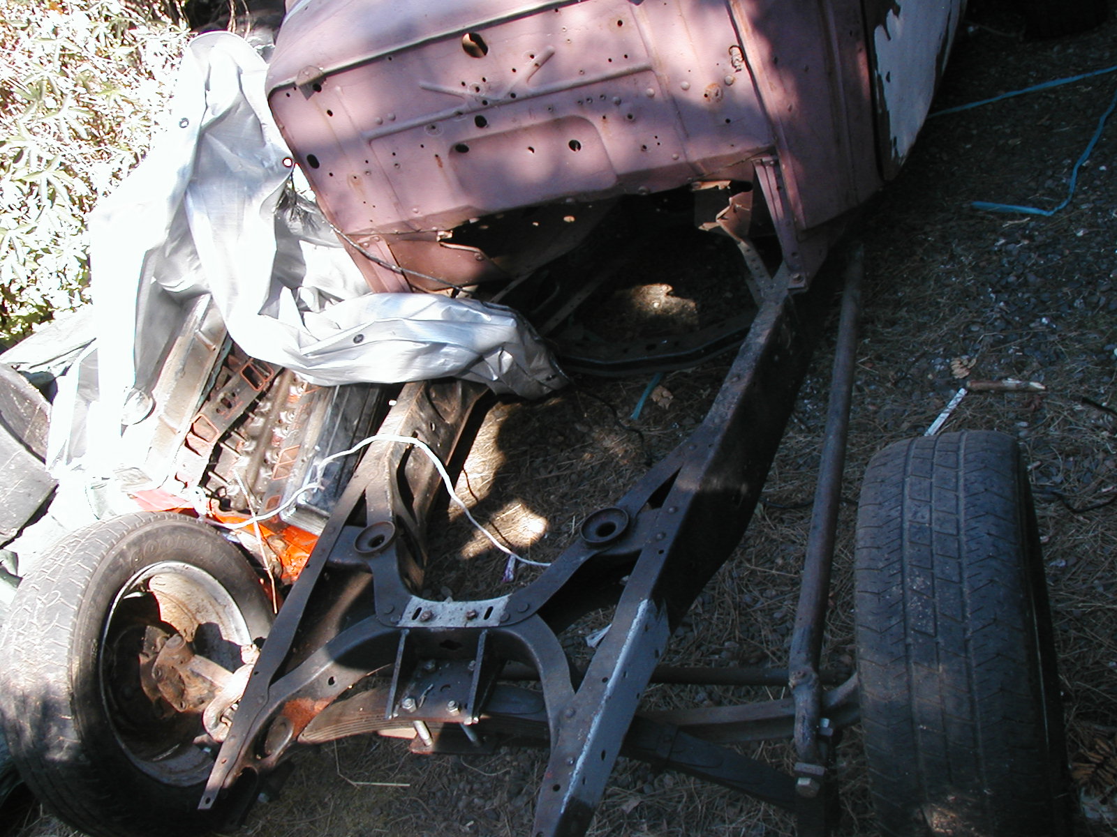

    I decided against lengthening the wheel base. Instead I removed the front crossmember this afternoon. I'm going to flip it and run the stock axle. I should get 2-2.5" of drop this way. I am going to channel the body over the frame, and I will run smaller wheels up front. This will probably get me the stance I'm after.

  18. I've seen your shops work and it's some of the best in the world... bar none!

    Thanks! That must be why we do jobs for people all over the world. My boss (shop owner) is a fabulous aluminum fabricator. Nobody can build curves and torch weld aluminum as well as he can.
    I'm real curious who you are now... we work at the end of a dirt road past a few Amish farms -- top secret. ;) You don't do custom paint do you? Have you seen the Cobra bodies or Ferraris?

    Excellent. We are transitioning away from rebodies and toward custom replicas (like the comissioned Dusenberg and Delahaye customs we're working on right now). The owner has his heart set on building a fleet of 1957 Mercedes 300 SLR coupes. He's given me the task of figuring out how to replicate (within reason) the two-block straight eight. I think it is impossible, but he's a big dreamer and doesn't let reality limit his achievements.

    I'm going to pickle the frame in vinegar before reassembling. The car's been in the woods for 50 years, so it's got a thick layer of "patina." I'll get some after pictures once I've reinstalled the crossmember. I think I'll only net a couple inches, but the nuance will go a long way in raking the stance. I also like the fact that it is a simple (subtle) mod in the spirit of trad-rodding.
