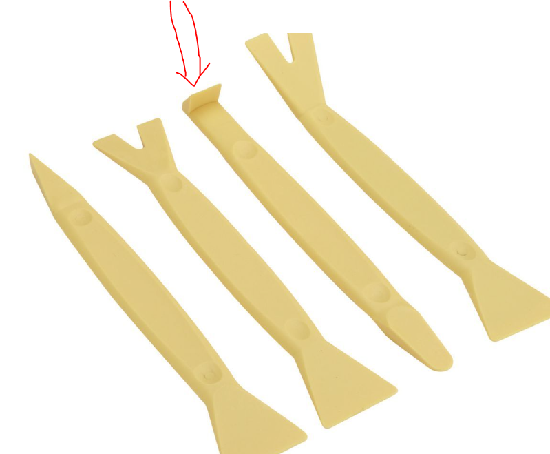

    i've used those cheap plastic kitchen cake frosting spreaders, slips behind the hubcap, protects the painted surface and then can pry off with a screwdriver. or i've used bondo spreaders the same way.

    exactly these. They take some wiggling but work great.

    I use the ones above, it usually takes at least two at different locations.

    I was parked next to a little roadster at a car show last summer and while I was kicked back in my chair, working on my tan and a bottle of grandpas special coke (as we like to call it), I noticed the 10" wide, deep reversed, painted steel wheels with baby moons. I asked him how the hell he gets those off and he showed me a plastic tool that he made sort of like the 3rd one from the left.
    chryslerfan55 and Joe Blow like this.

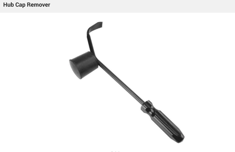

    This...with a couple of raps with this.....using the 90 degree end.

    Plastic tool shown and tap with hammer--works great

    The station I worked (so many years ago) had a very similar tool.
    Worked great.
